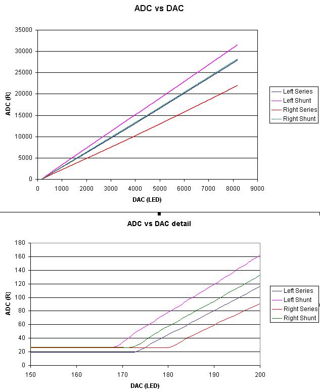

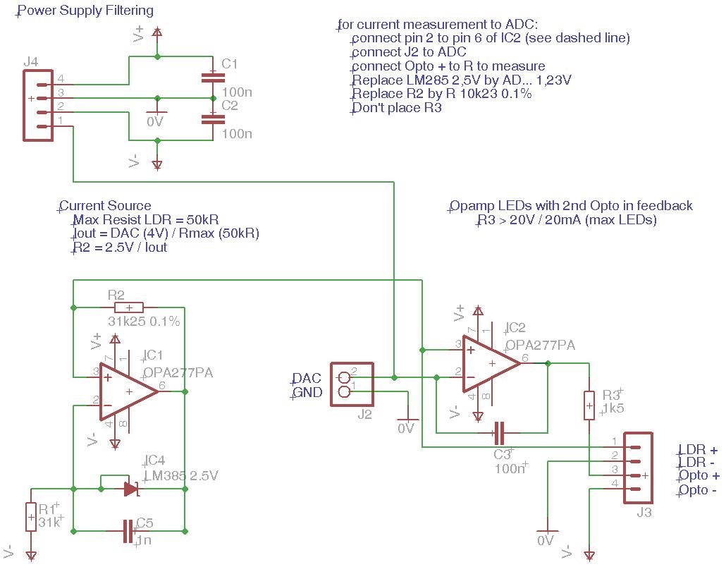

The DAC-Opamp-Sylonex link

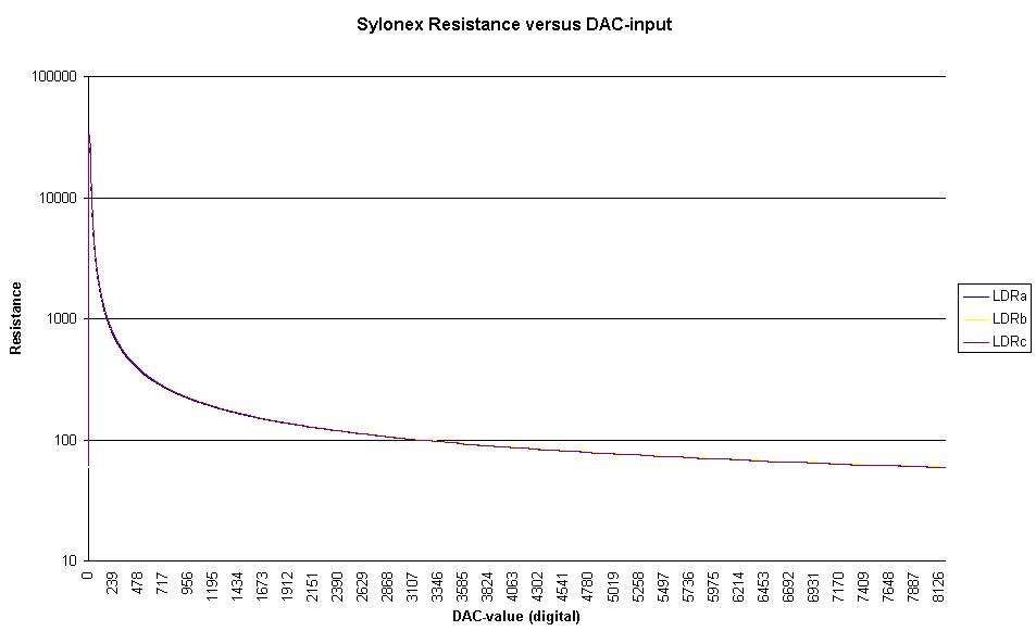

Or more clearly: how to control the current through the LED to have good control of the resistance. It took me ages to have some fine control of the optocoupler resistance. The optocoupler is far from linear, even far from logarithmic.
1. Linear
A direct connection to a DAC with an opamp converting voltage to current (see schematic 1) is not giving enough resolution to have good volume-control at the low end. See graph 1 showing the relation between current on the X-axis and resistance on the Y-axis (not on scale). The axis is logarithmic. It is clear it’s impossible to control the resistance this way.

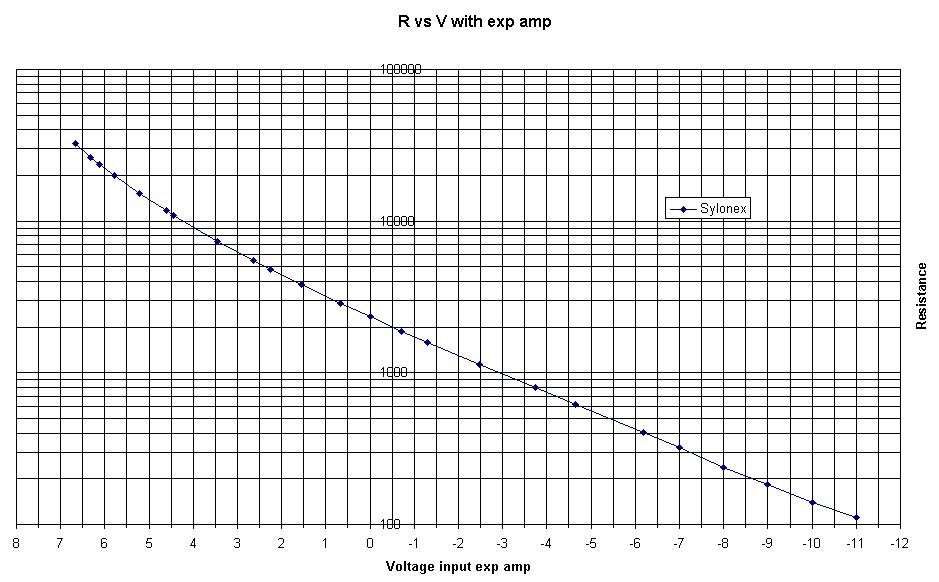

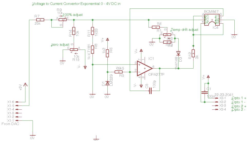

2. Exponential
I tried with an exponential amp between the DAC and the optocoupler (see schematic 2, examples can be found in VCOs for synthesizers). It took a while to have it working in a very basic way (without exotic parts and without temp adjust), but also that didn’t work. See graph 2. It looks a lot better, the result is linear on a logarithmic scale. Still the control is not good enough. I stopped working on this quite fast as there were several problems. First the relation was still NOK. Second you need a lot of parts to compensate for temperature drift. I would have had far too complex and expensive electronics to control the LED. And third I had to go from the DAC that has a positive voltage out only, to a voltage swing from negative to positive. It was really interesting to search for schematics and to work it out, but I stopped even before linking it to a real DAC. The graph is made with manual measurements.

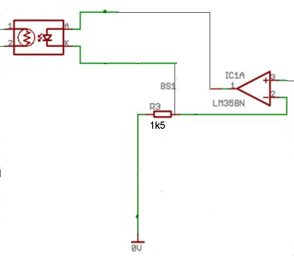

3. Feedback with 2nd Sylonex
Finally I used a 2nd optocoupler in the feedback loop of the opamp to have good control (see schematic 3, thanks Gootee for the idea). But even then control of the very low volumes is critical.
As the optocouplers are reacting really slow, it also took some time to have the circuit around the opamp stable, I had to slow down the opamp quite a lot to avoid oscillation, that’s what C3 is doing. I discovered this late, that’s why I had to solder it at the bottom of the PCB. What you don’t see on the schematics is that Opto+& - are going to 2 optocouplers in series. The resistor of 1 of the optocouplers goes to LDR+&- for the feedback loop. For the results see graphs 3 and 4 that were taken on the final volumecontrol. The 0 of the axis is at the 0 of the DAC and that’s where the maximum current goes through the LED. The graph is showing the digital values from both DAC and ADC. Full range is around 50kR.
As you can see, this is linear, nearly over the whole range. Only at the bottom it is far from linear due to the saturation of the LEDs. And the zero is not really at zero as the DAC is not linear at all around zero (this is depending on the DAC used). I had to put an offset to be able to get the maximum current in the LEDs. Both deviations are easily compensated in software.
Still needed is very high resolution to have good control and small steps in volume together with coherence between left and right. A very stable power-supply of the DACs and ADC is mandatory, as is the PS for the opamps. I'll come back to this. First I'll make a block-diagram and some pictures, unfortunately I have to work this WE.

In the system I made it's easy enough to change the ranges (of current through the LED and resistance of the LDR) by changing 1 resistor in each DAC, see the schematics for the calculation. That makes it possible to use other parts then the Sylonex-ones. The only limit is the maximum current through the LEDs the opamp can deliver which is 35mA for an OPA277. BTW, I've chosen this opamp because of the very low offset-voltage it has.
For the software it makes no difference which part is used. The software takes into account the low reaction of the optocouplers at very low resistance. For each calibration step, it waits till the resistance has stabilised. It means slow reacting optocouplers can be used as well.
A matter of importance is to have the optocoupler in the feedback loop not too much different from the optocoupler it is linked to. The more they are different, the more the slope of the curve DAC/ADC will be different from the ideal case. It's not a problem for the software as it is compensated, but in extreme cases it could make the control of the resistance less precise.

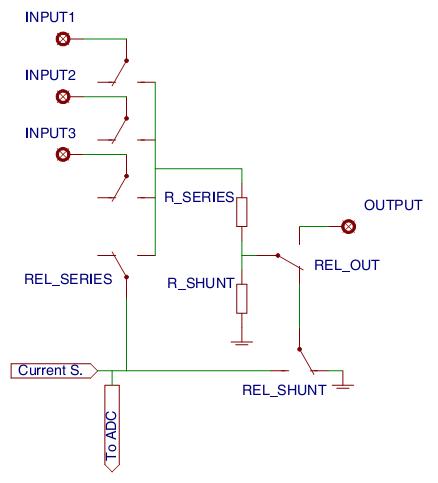

Here is a block diagram of the analog part of 1 channel only. It shows the 2 optocouplers, but only the resistor part of it. For the rest it's only relais for input, for mute and for calibration.
The 3 INPUT-relais are clear, no comment needed.
REL_OUT is clear as well. It's used as mute by switching off the output during the calibration, and it links the output to the calibration circuit.
REL_SHUNT connects the output to the earth or to the calibration circuit. Connected to the calibration circuit, it makes it possible to measure the resistance of the shunt resistor. The connection to earth is needed to be able to measure the series-resistor.
REL_SERIES is there to measure the resistance of the series-resistor, in this case the output needs to be connected to the ground which is done by rel_shunt.
In total there are 8 relays in the stereo-preamp, steered by the Arduino through I2C. I used a Jeelab Output Plug. This is a small module containing a MCP23008T and a ULN2803 as a buffer. I added a hardware protection to avoid calibration and closure of input or outputrelais simultaniously as this would put DC on the output. My poweramp is linked in DC and I don't like the small of frying speakers. As a programming error is easily made, a hardware protection helps to sleep better.
Measurement of the resistance is done by a precise current source which sends current through the resisitor. A voltage buffer sends the tension over the resistor to an ADC. A famous law does the rest. The buffer board is the same as the one for the DAC, only some parts are different to make it really precise and stable. As an ADC I use a Jeelabs Analog Plug, based on a MCP3424. It's a 4 channel one, but only 1 is used at the moment.
The DAC is remaining now. That's a MCP4728 4-channel DAC. I dit put it on a small breadboard to be compatible with the Jeelabs connections.
Next time some pictures.

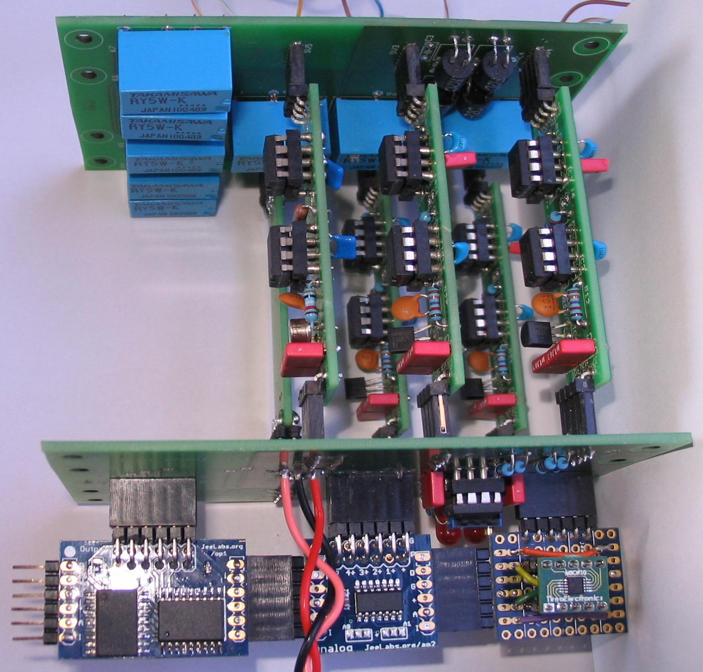

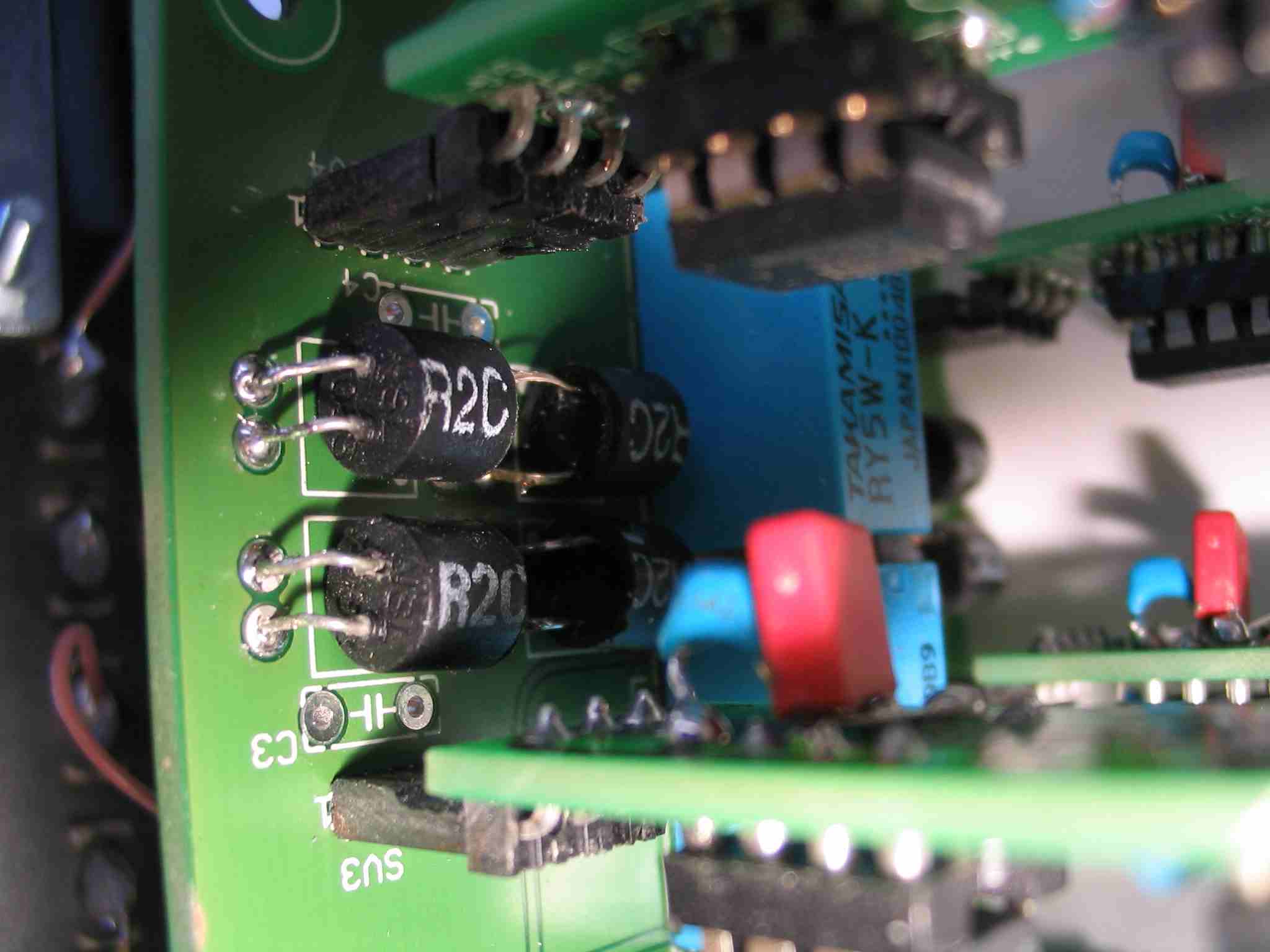

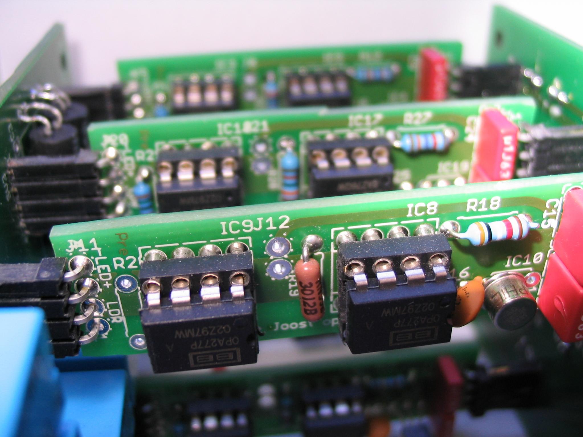

Here finally some pictures.
Picture 1 shows the complete unit.
> In the front you have from left to right the 3 I2C-interfaces:
- the Output Plug from Jeelabs, used for the relais
- in the middle the ADC-plug from Jeelabs
- and at the right the DAC-chip, soldered on a converter to DIL by Tirna-electronics.
> These boards are connected to the first big board that does the distribution of all signals and power to the right connectors on the backside. This big PCB is called the distribution board.
> In the middle between the 2 big boards are 6 small PCBs.
- 4 of them are to convert the output from the DACs to current through the LEDs, incorporating a 2nd optocoupler on the analog board in the feedback loop.
- 1 is the circuit to convert resistance to voltage
- and the last one makes to connections to the relais. Picture 2 shows a detail.
> The name of the last board is revealed above. The analog board contains the relais and the optocouplers, see pic 3 for a close-up of the Sylonex parts. Connection to input and output is done on the back.
The last picture shows the complete preamp, including the B1symmetric as buffer, and 2 power-supplies. 1 PS is used for the I2C-parts. A very good PS is needed to keep the DACs working stable. And the same quality of PS is needed as power for the opamps.
I still have to move it in the housing, but I need to swap my multimedia PC first. You don't see the Arduino. It will come in the same housing as the PC, far from the preamp. This will allow to have the buttons and display at eye-level, and the preamp close to the poweramp which is at floorlevel. All signal cables can be very short. A galvanic isolator between I2C and the Arduino will be added as well.

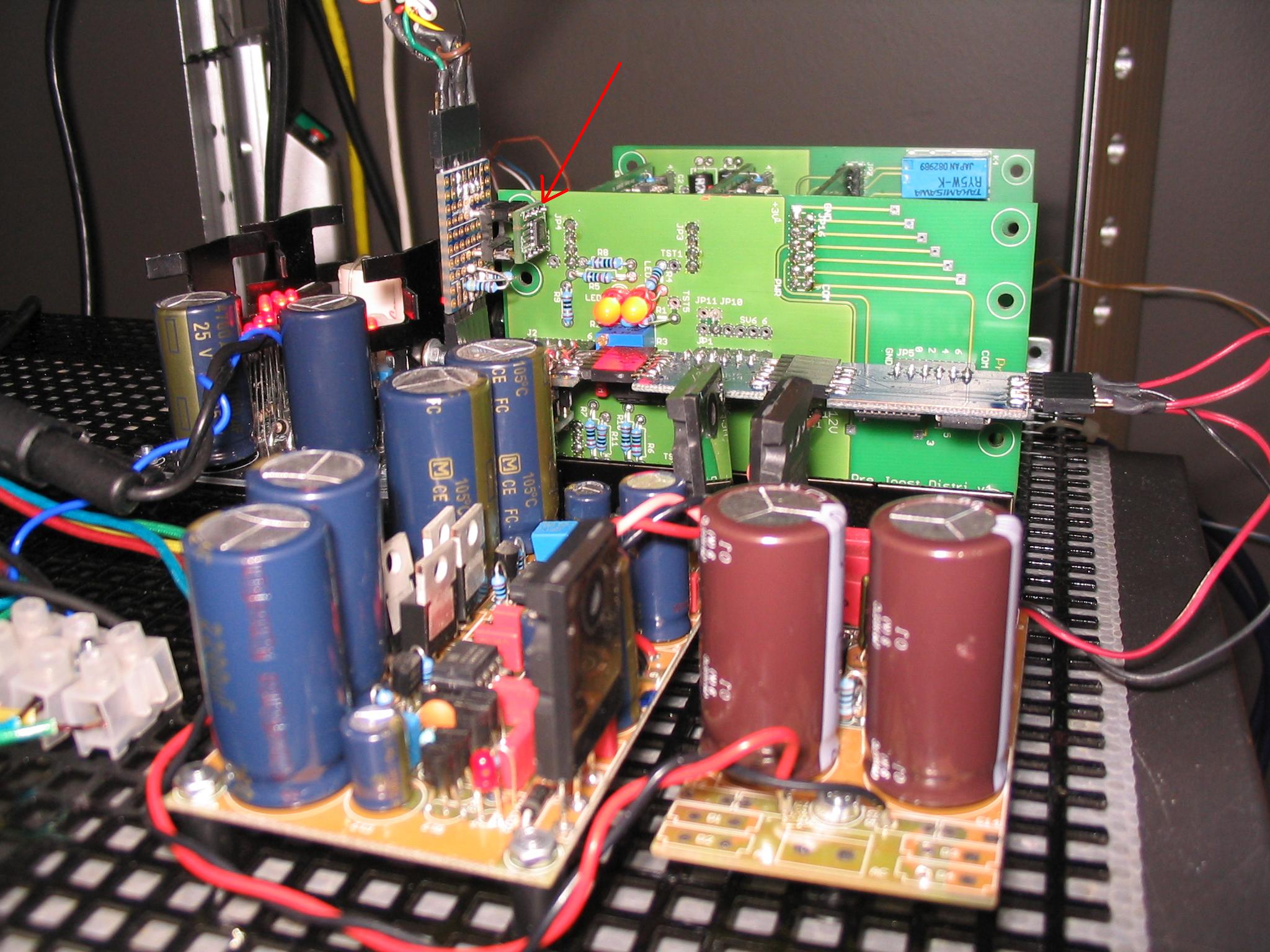

Galvanic isolation is really important !!
I had an issue during programming of the Arduino. To program it, I need to connect the Arduino with USB to the Audio-PC in my stereo. That PC is earthed, and it's linked with USB as well to my DAC. This gave me 2 problems:
1st issue:
There is an earth loop between the PC and the DAC causing noise during playback. This was not too bad at the start, but became really annoying after putting very short powercables. Probably this reduced the resistance in the loop too far. A solution for this was the implementation of a USB-isolator between the PC and the DAC. I installed the Ultravox from Diyparadise and the sound became a lot clearer immediatly. Also the noise coming from the PC dissappeared completely.
2nd issue:
There was a similar loop between the PC and my preamp, coming from the USB-cable, and coming from the fact that the ADC in the calibration is linked both to the ground of my preamp and to the ground of the Arduino. I could have solved this by putting a relay to connect the DAC to ground only during calibration, but I was too lazy for that. Another solution was to isolate the Arduino completely from I2C. Therefor I used an ADUM1250, which is a galvanic isolation IC for I2C. As it's too small for my fingers and soldering gun, I asked Tirna Electronics to solder it for me on a SOIC8-adaptor. With this in (see at the arrow on the picture), the sound is 100% clean again. It blocks also possible noise on the lines that could come from the Arduino.
I noticed that the Arduino can possibly create a lot of noise. At a moment I had the Arduino not earthed at all. This made the Arduino transmit a hell of noise in the preamp, even with the galvanic isolation inbetween. The transistors were at only 200mm from the Arduino at that moment, but it shows it can be a real noise transmitter. Connecting it to the PC (earthing) made the noise disappear completely. It shows for me as well that connecting an Arduino straight to audio will inject noise into the earth. Now I send the noise to the PC which is galvanic isolated from the audio.
I'm happy I will be able to put the preamp at a meter away from Arduino and PC by using the galvanic isolated I2C-bus. Keeping noise at a distance is always better. Also my DAC will be far from the noisy sources. I sleep better now :).
we've had zero issues with the arduino and noise.
I would check your ground design and layout.
we've tested the arduino in our 'a10 preamp' (amb.org) and its at the same level of noise as our test gear (RME firewire box usually used for testing).
you may want to consider ferrites to link grounds if you are not already doing that.
running from computer usb will always be a problem. I use that for debug but never for actual audio use. yes, you will have ground loops with pc's and earth ground vs. usb ground.
At the moment I have zero noise, even with the Arduino linked through USB. That's achieved by using galvanic isolation. I keep the Arduino linked to the PC as I use the PC as remote control for the Arduino (for Volume, IO-selection and calibration.
And I only have the noise when the Arduino is not linked to earth at all, which should never be the case. At that moment even the earthplane on the board acts like an antenna. As soon as the Arduino is grounded, the noise disappears completely.
I use ferrites on several places, but as I use galvanic isolation between audio and digital, it's not of major importance. I use them to avoid HF passing through the power supllies. HF is always present on the mains, and I keep it out in several steps (ferrite on mains, filter on mains, ferrites on low voltage).
