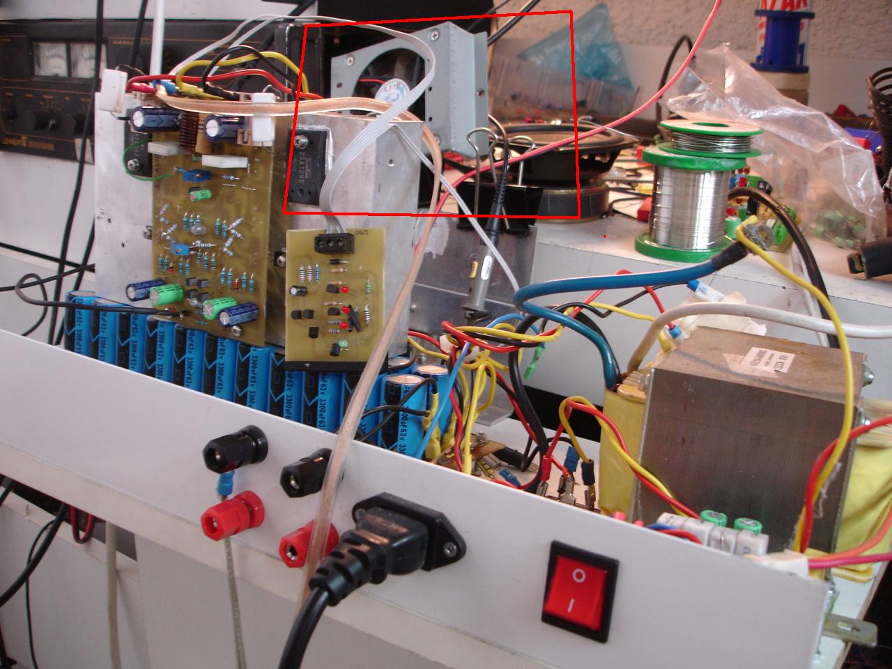

When you have these style heatsink turn them 100% face to face and ad to the end a 4x4inch fan or a computer fan what ever will have the right size.
That will triple up your heatsink capacity .
Just as a advise.
Nice idea!
A fan is already installed .Nice idea!
look #post1054.
What?Reminds me of something nearby !

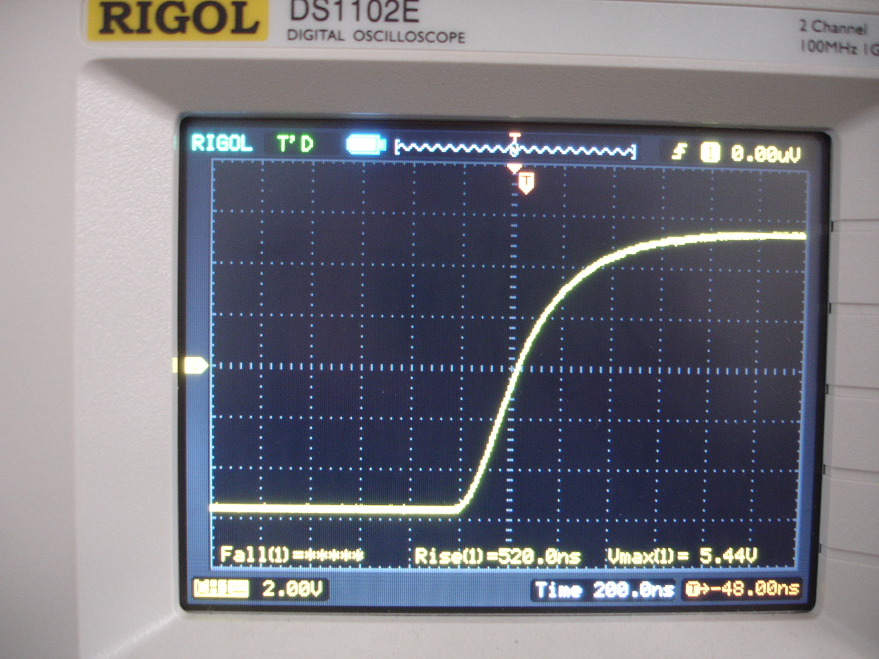

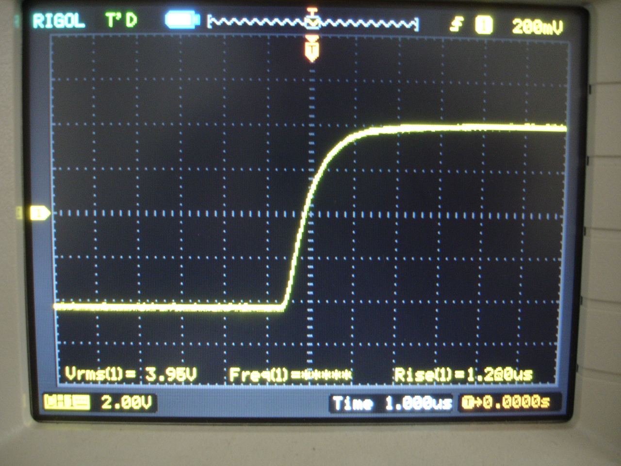

Today first channel was tested again(220pf compansation cap.)Thimios,
You can use 550 c and 560 c also.
Normally for a power amp you don't really need low noise transistors.
Your rise time is a bit longer than mine, but I guess that's because you are using 270 pF for your comp
Same results(1.2us),then this same channel was measured before L out. Rise time=520ns.

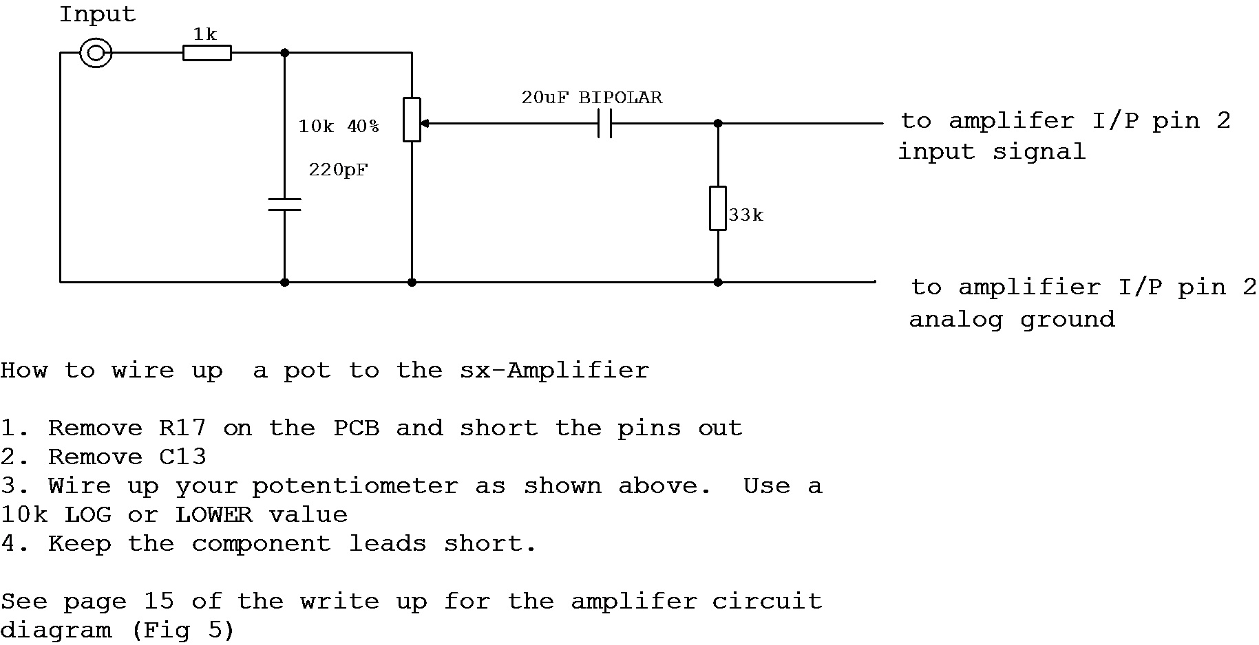

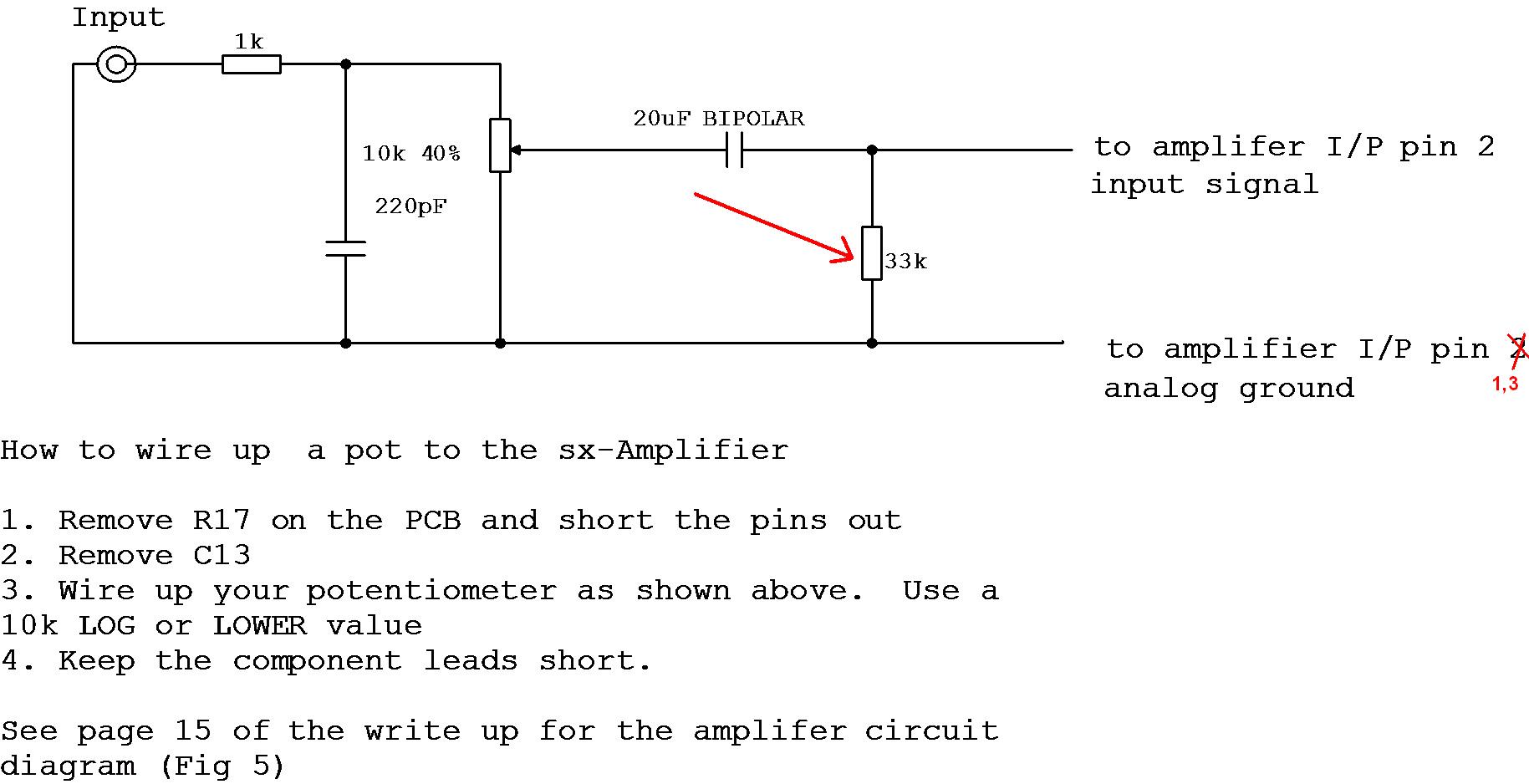

BTW I want recommendations about volume potentiometer value(ΚΩ)
Ok - that sounds more like it - my measurements were before the inductor

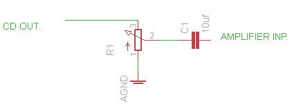

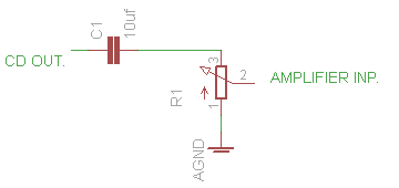

For the potentiometer, I would suggest 10 k is the max.
The input is a diamond buffer and you do get partial cancellation of the input bias currents. However, you may still get pot scratch noise which means you should capacitively couple the pot to the amp input.
Here is how to wire a pot to the input without causing problems.
If you do not use a DC blocking cap as shown in the diagram, you will get 'pot scratch' noise after a while. And the DC source resistance will change as you adjust the pot.
If you do not have a bipolar cap, just use two electrolytics back to back - use a minimum value of ~50uF.

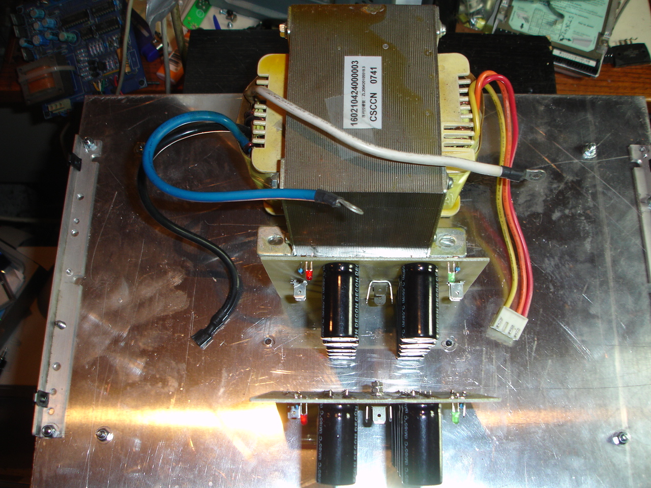

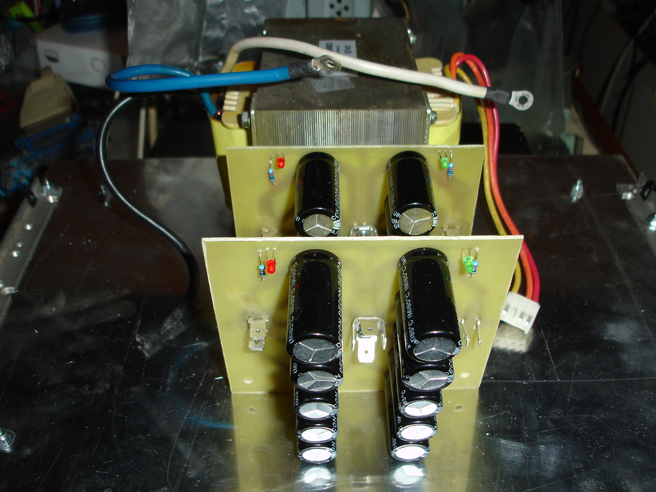

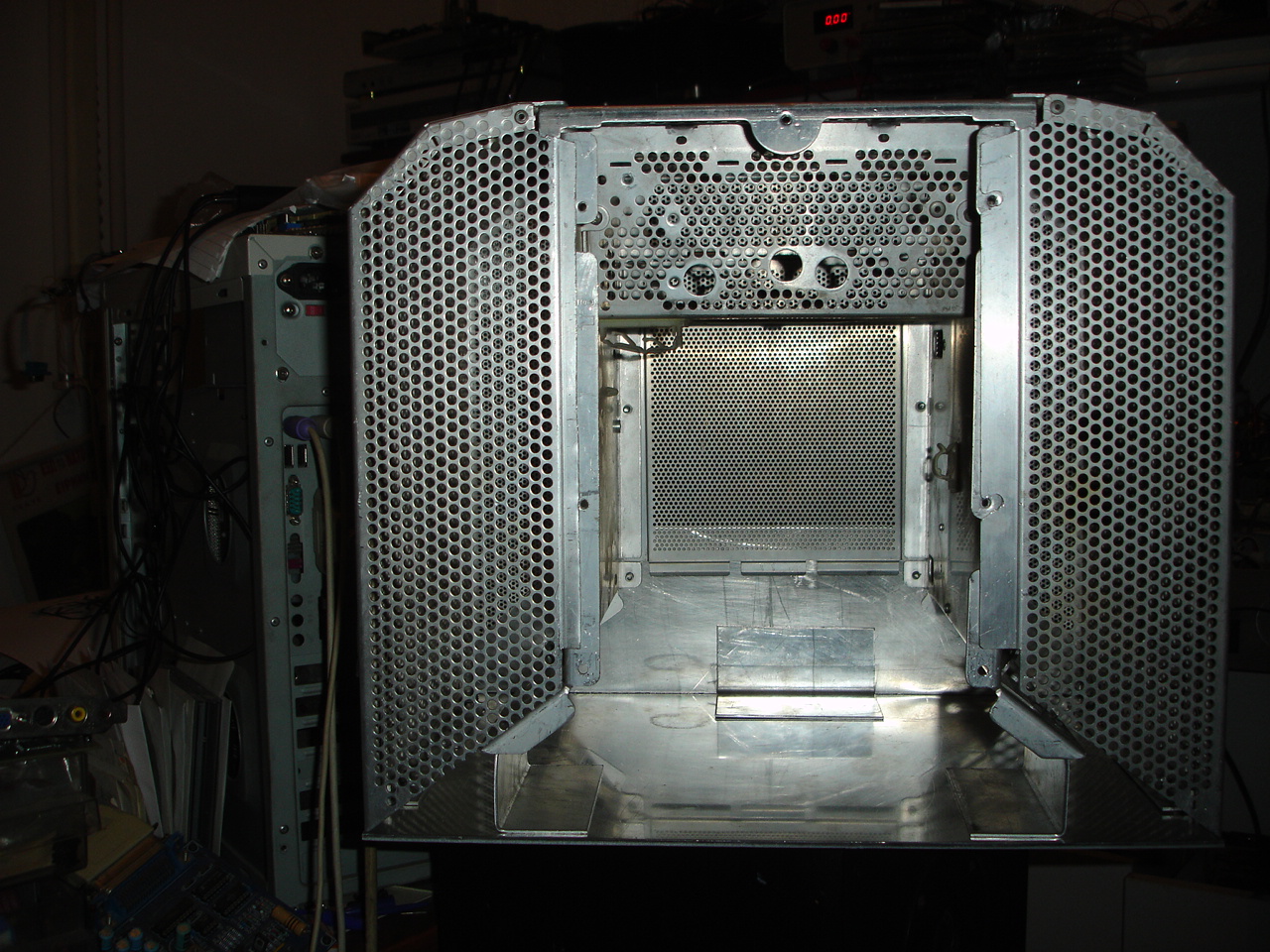

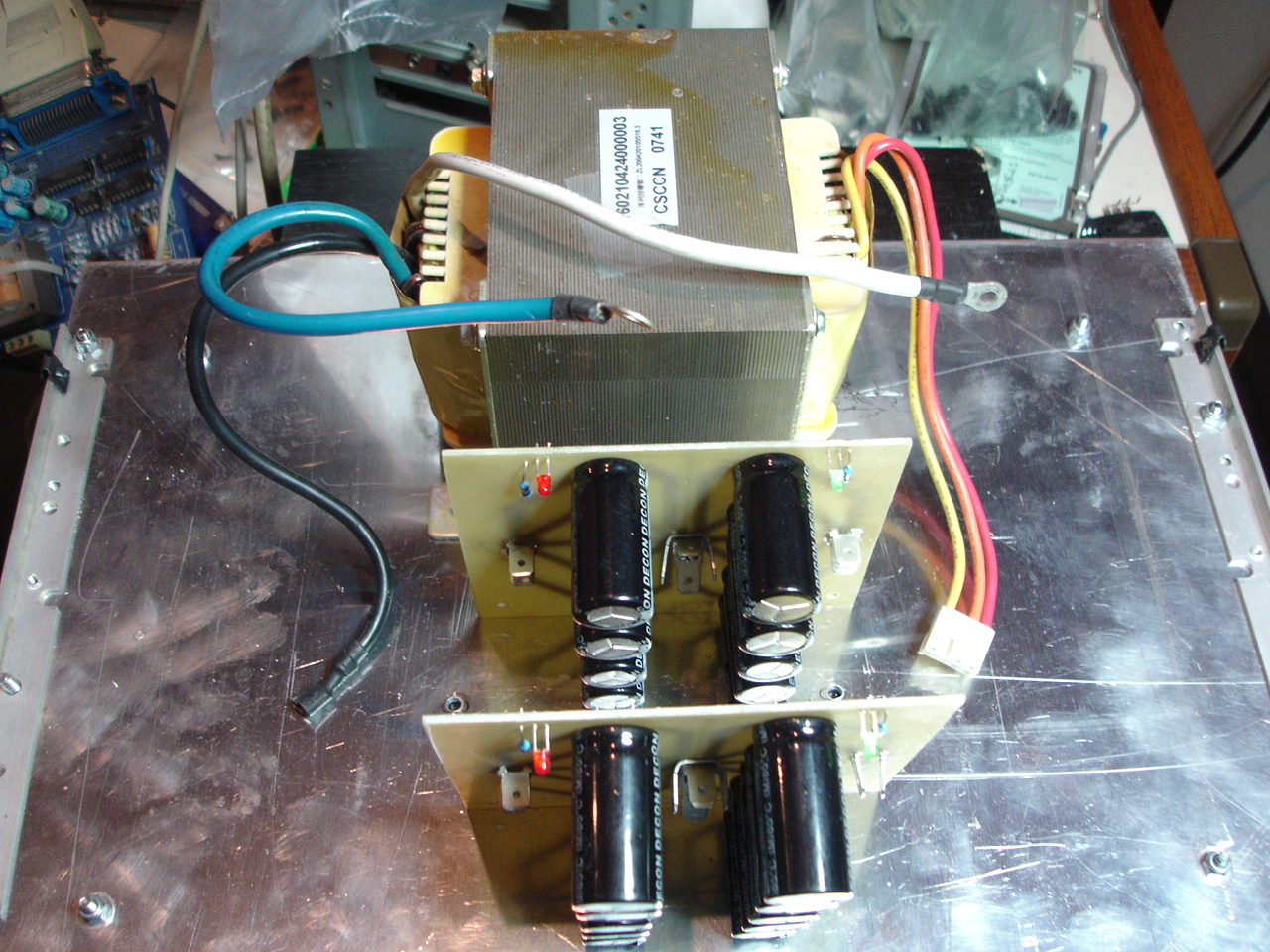

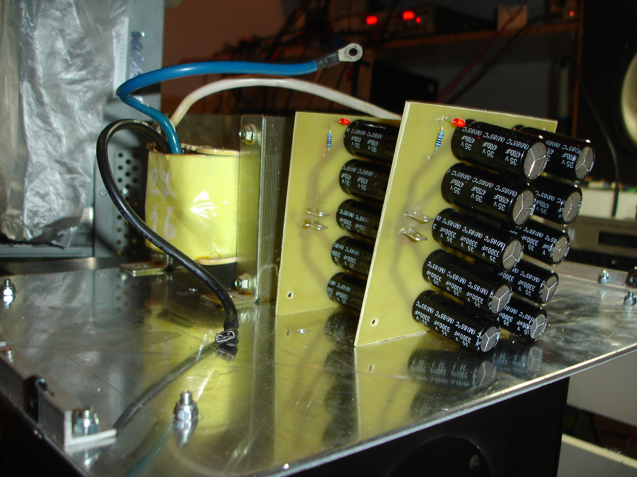

A HOUSE FROM RECYCLED MATERIALS.
Preparing a house for sx amplifier from recycled materials and what i have on hand now.
A Faraday shield from an old monitor ,a big transformer from an old UPS ,two new cap banks ....
