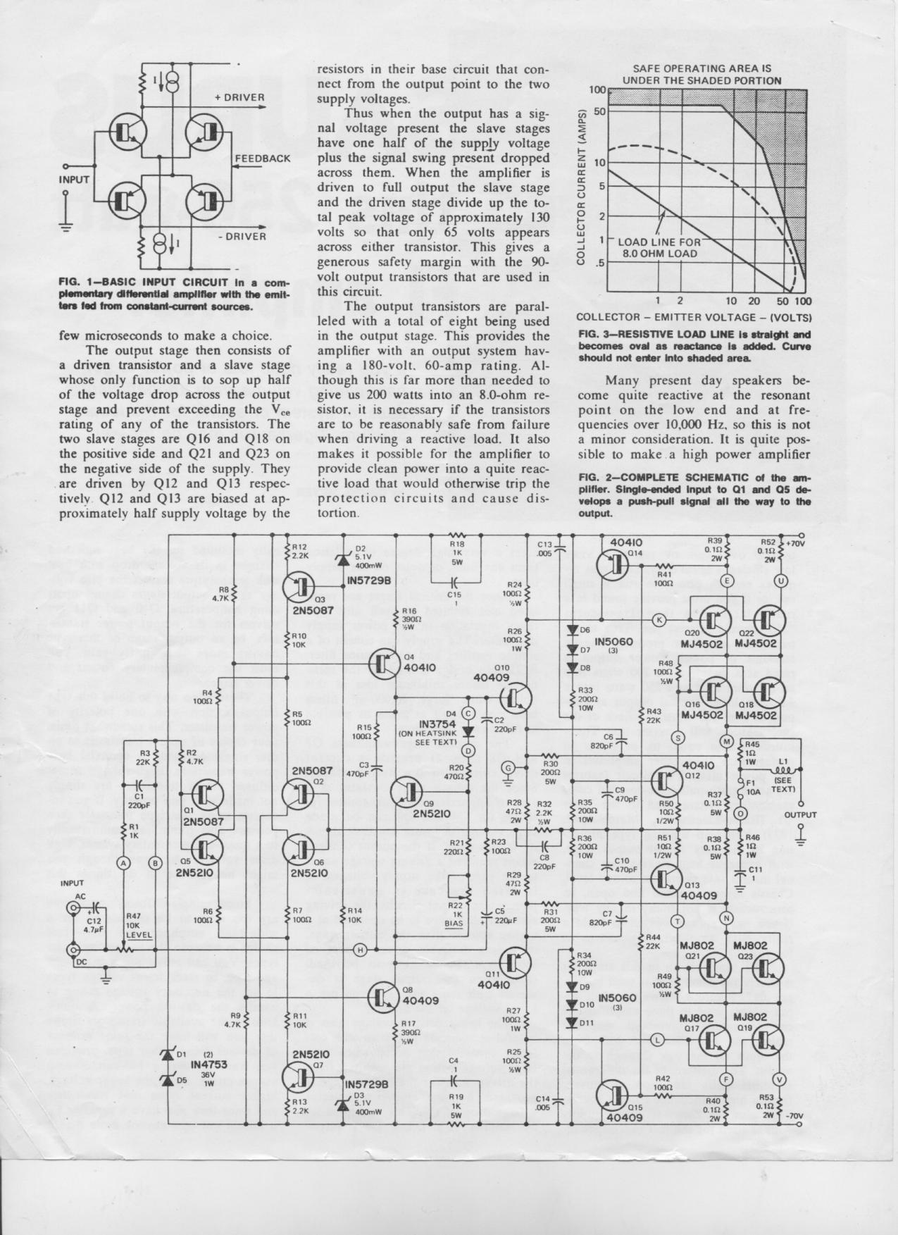

I have a theory regarding the excursion that you saw, note that the protection just essentially turns off the transistor with excessive current and does not pull the output to zero. So, the output hits max current and then the output turns off allowing it to slam back to zero or the other rail if the other side turns on. I think a more traditional protection that clamps the VAS output would be better.
Hi Pete,
I think you're referring to Q14 and Q15?
It's funny where the ground is place on the emitter of Q10. I would think between R28 and R29 would make more sense intuitively. Is this a mistake in the drawing of the schematic?

Hi Pete,
I was considering suggesting a current limit approach like this in the Tigersuarus for the Tiger un except rather than limit at the base of the output TR, connect the collectors of the limiter TR to the bases of the VAS TR and current sink TR respectively.
I saw this done in a similar way in an old Motorola power amp app note in the 70s. I think they called it robbing the current from the VAS.

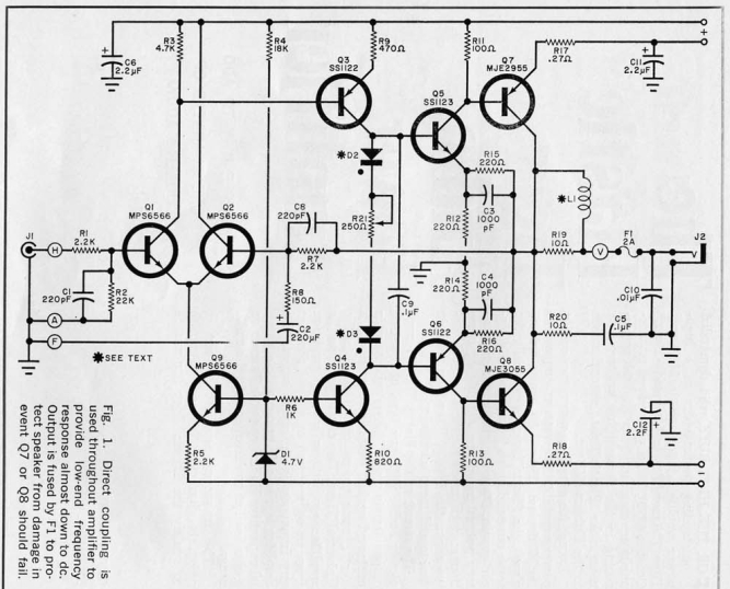

I get a kick out of the people here trying to compare the Tiger to the Tigersaurus. If one takes the time to examine the schematics it is clearly visible that they aren't the same.
Is this the Tiger you are referring to?
Yes it is a drawing error and several component values are wrong right at the output, see the parts list for the correct values.

It looks like R26,27 are current limiting resistors for Q10 and Q11. They are a bit of a compromise. At 100 ohms, I doubt Q10, Q11 are protected enough when Q14, Q15 turn on hard. At 1K, they impose a rather low limit to the base drive current for the output transistors.
If one is to do away with the over-current protection (ie Q14, Q15), R26 and R27 can be omitted.
