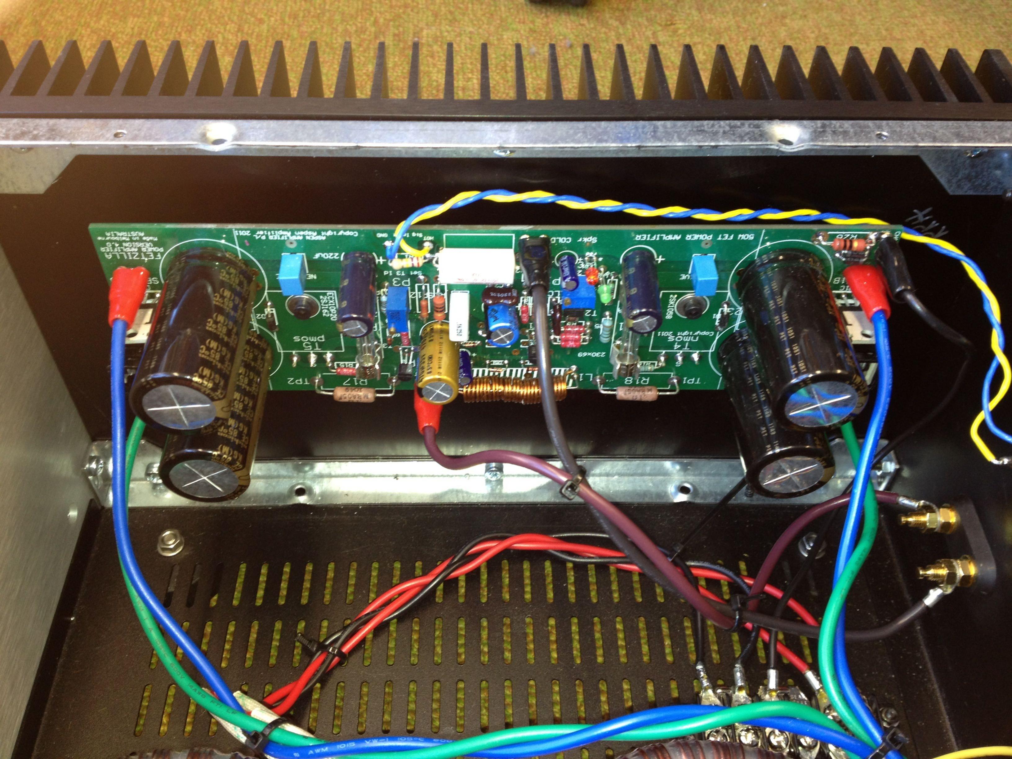

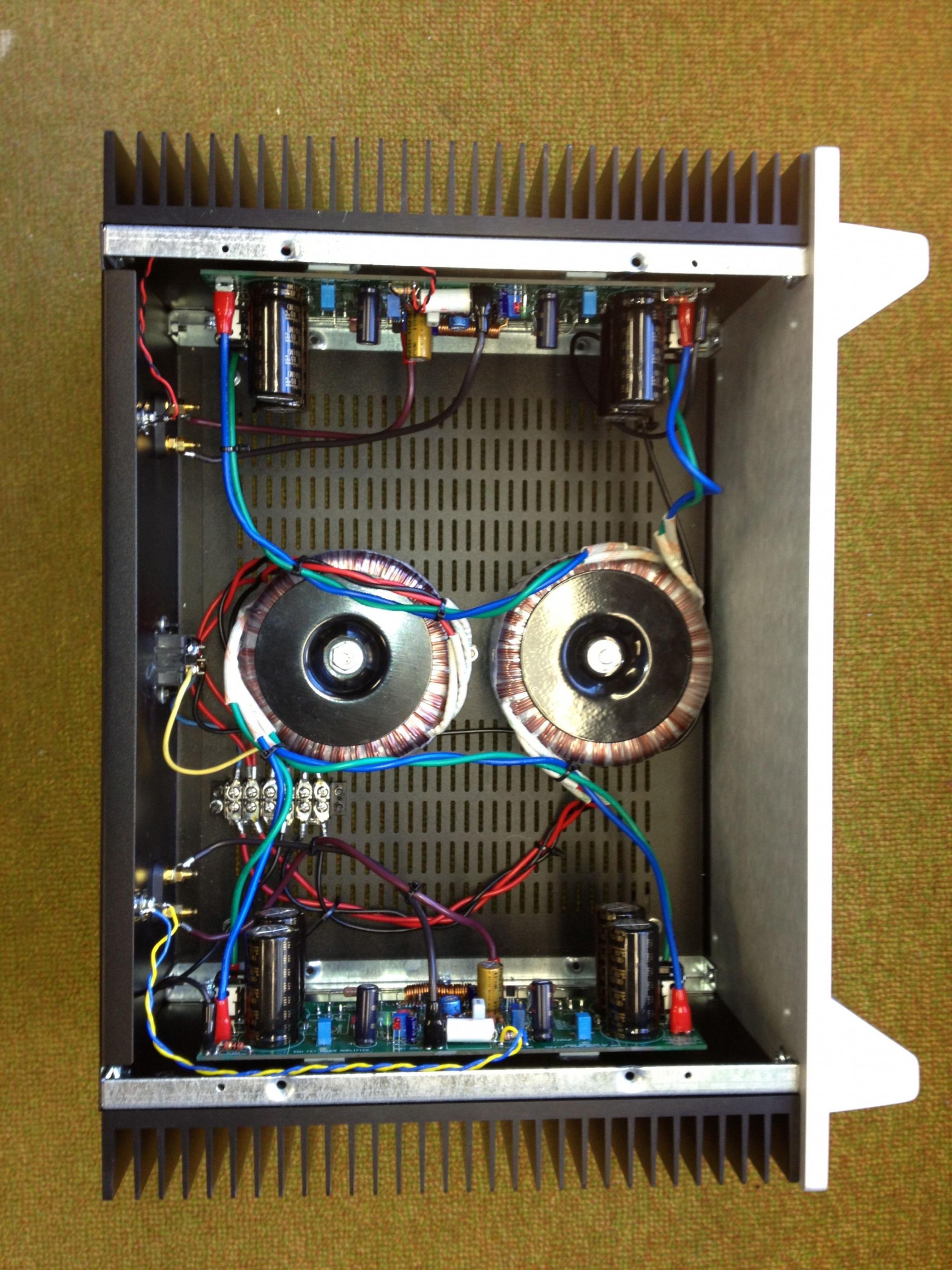

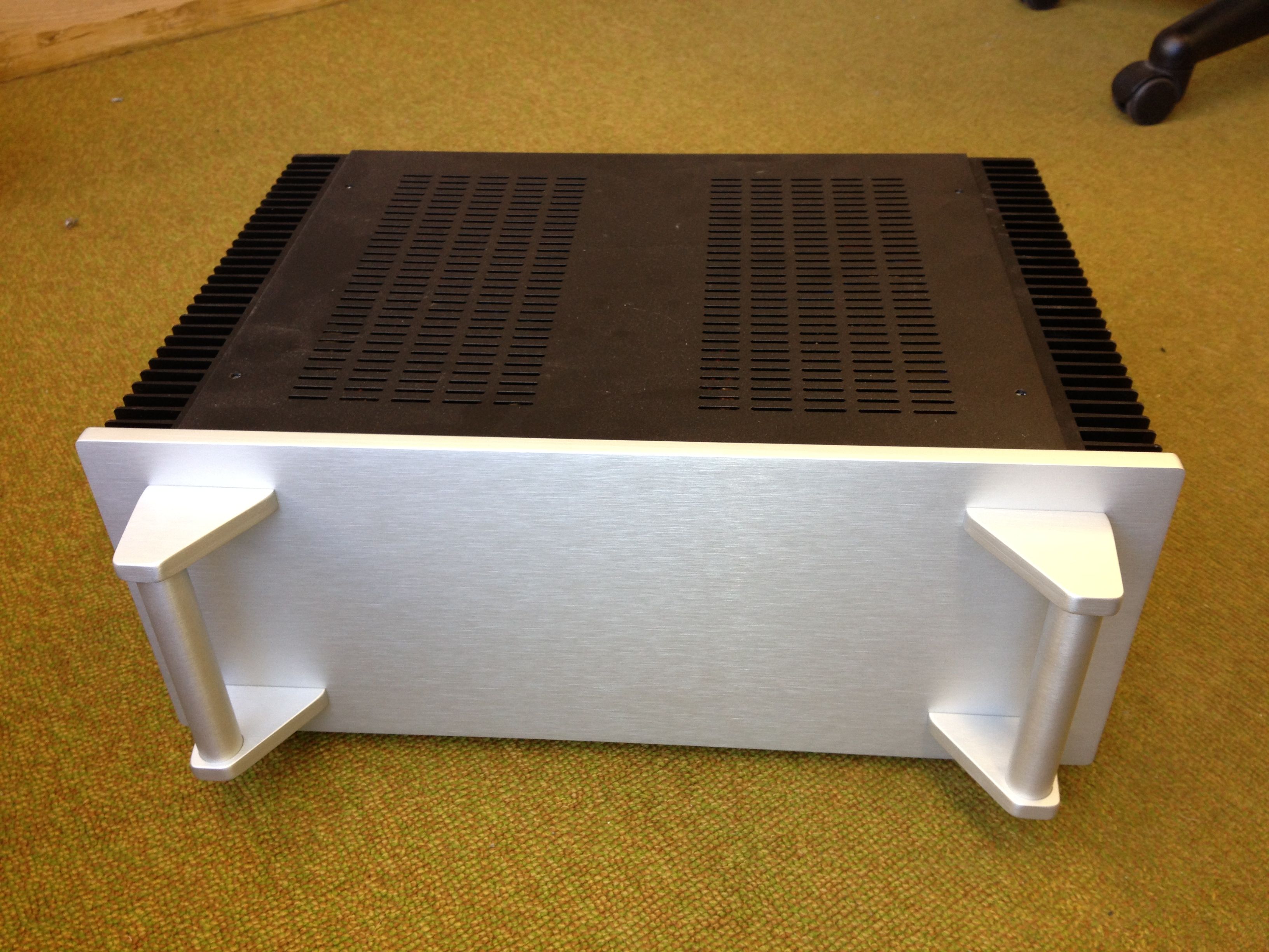

Just a quick update. Where to begin? How about the eye candy first:
Here is my version residing in the DIYAudio Standard 4U Chassis. 2 Antek 25 x 2 @ 400VA transformers. I was too anxious to get it going to bother with any fancy lights on that gorgeous front panel. On-off switch resides on the IEC inlet on back.

When I put everything in the chassis, I rechecked the bias and offset. Now both sitting nicely at 37 (and change) mV. I had to re-zero the offset a bit. I'm running 1uF Mundorf MKP in the input spot. The recommended Auricaps were out of stock when I was collecting parts.
Current set up:
SB Touch serving flac -> CA Dac Magic -> DCB1 (Mesmerize) -> Fetzilla -> MJK Open Baffles (~93 dB/watt efficient)

A wee bit of turn on thump. Background noise is black as night. I couldn't hear a thing. Playing Krauss/Plant at very low levels (the family is in bed). Sound stage is noticeably better than the amp it replaced (for this set up). Detail is extraordinary. Did I say the detail is extraordinary?
I don't write/haven't written much about listening impressions on any of my diy Amps. I lack the words and experience. I'm not here to pit one of my projects against another. My basic 'call' is do I like it or not. I really like what I hear in the Fetzilla. Definitely a keeper:D
This was really a fun build. For me, it's the journey, not just the destination The board layout is great. The parts count is relatively low. Construction was quick. Dialing in the bias etc. was a snap. The availability of the awesome diyAudio chassis was fortuitous timing. I really like it when a plan comes together.
I cannot wait to put the amp through its paces when I can turn it up a bit and listen with more intention. But... after all of 25 minutes powered up, it is great. Really great.
Cheers to Hugh for making the boards available and the support of this thread! :up: As I wrap this up... currently playing Anne Akiko Meyer's Air, (violin conerto) just lovely. :)
