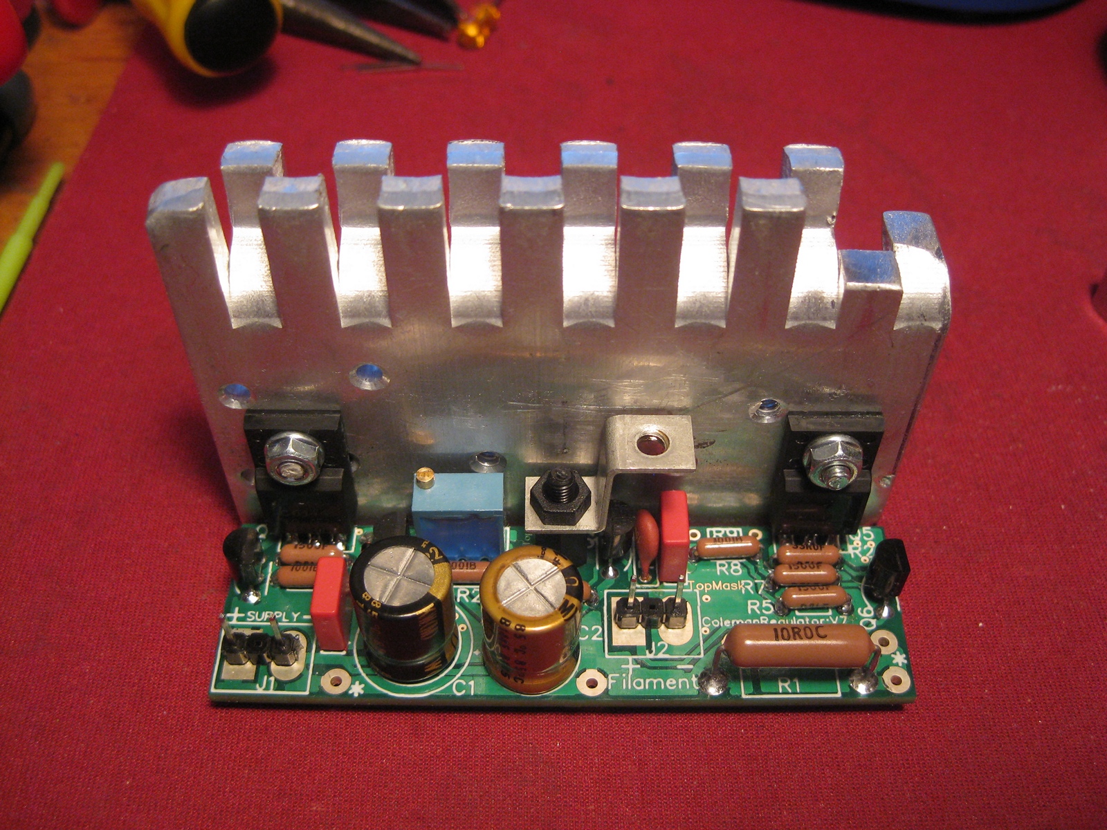

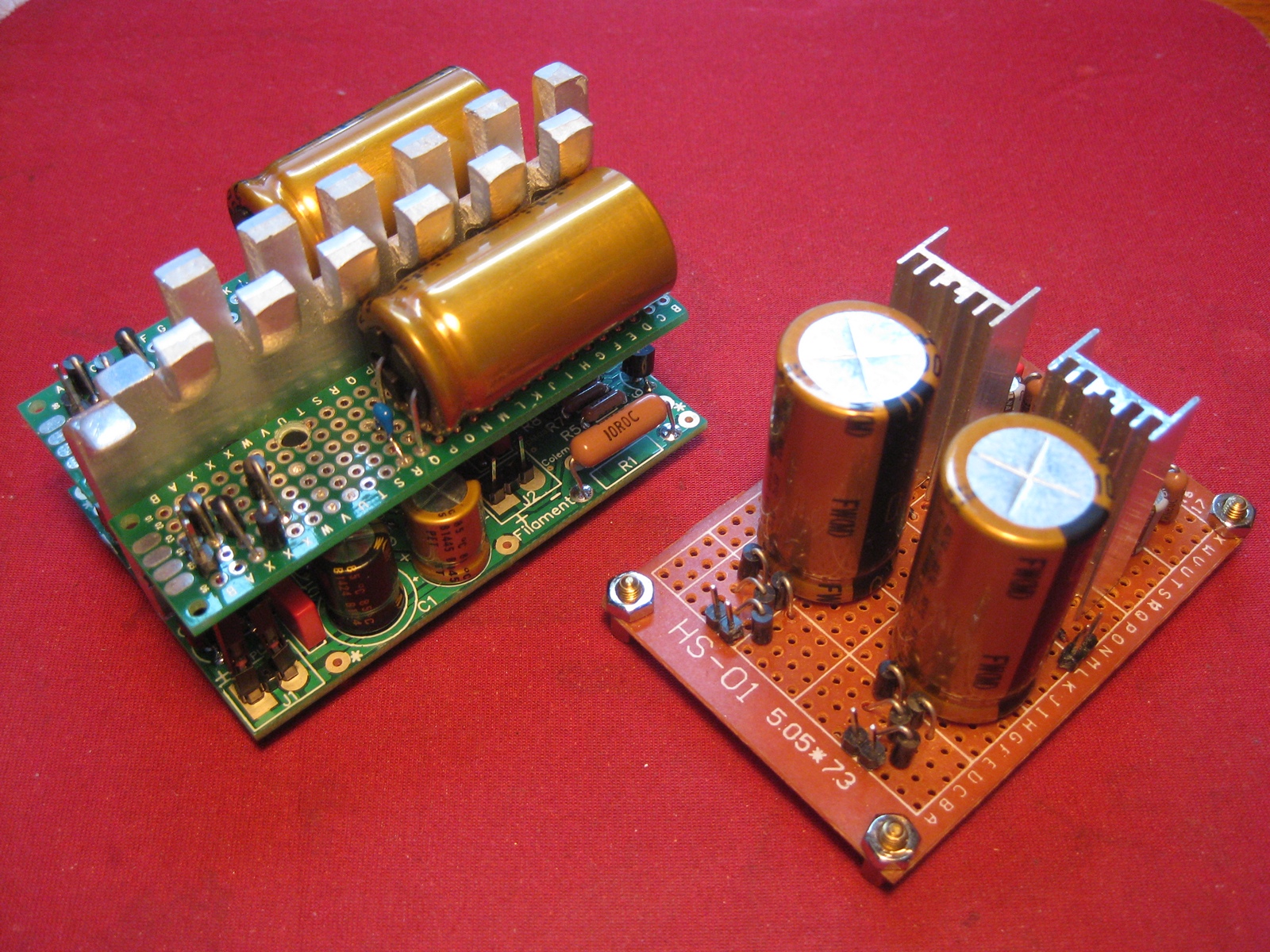

I built a small amplifier with those tubes and changed from simple LM317 regulators to Rod Coleman filament regulators and the difference was night and day. Do your self a favor and forget about those off the shelf switching regulators and just fit the Coleman boards. For the tiny 1.4v 100ma filaments you can build both boards with a simple rectifier and filter cap into a very small space. The heatsink was total overkill, you could just mount them to the chassis.

Have you measured the differences, between a 317 and any purpose-designed current-driven filament regulators?
Start by measuring the ac-impedance: the differential impedance that the filament sees, looking outward.
The LM317 in current-source mode works better than a voltage regulator, but it can be improved a great deal.
One way to measure supply impedance is to load it with a squarewave, a 1Khz square will consist of a lot of harmonics, and can be used to understand loop stability.

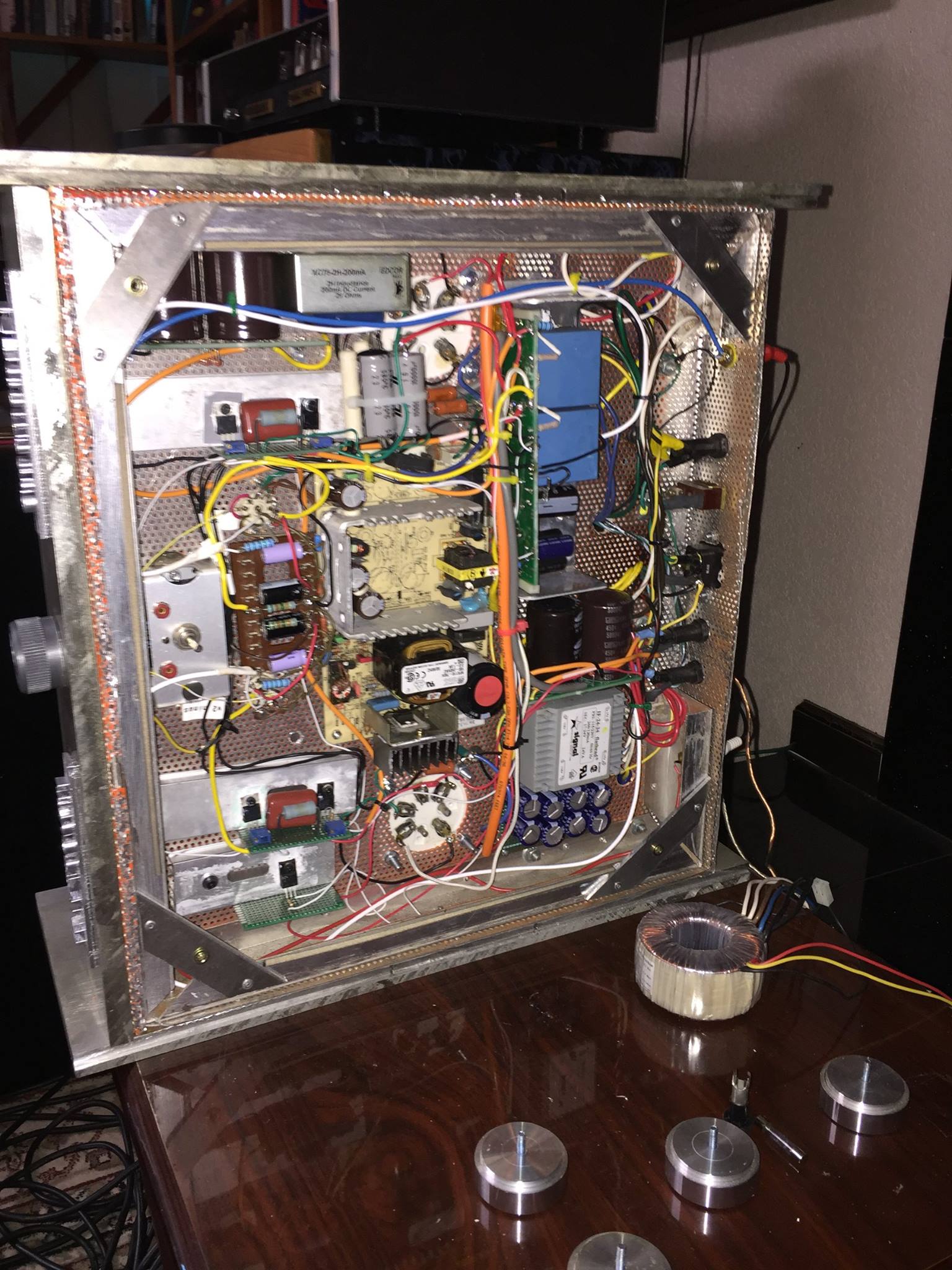

The module in the picture that has a large heat sink is made by Tentlabs that has the best performance. I am also trying those LM317 and switching regulators too to see how they differ from Tentlabs. So far, a switching power supply without LM317 current limiter has the best performance among all and I would say about 80% to that of Tentlabs. Yet, if you think about the cost, switching power supply without LM317 without current limiter has the highest price performance ratio among all.
Tentlabs uses 3 x 10000uF is a bit overkill but those caps are only having 1.8xA ripple current which are just ordinary caps. I ordered some Nichicon UHE with 4.22A ripple current and Nichicon UKA for audio with 1.89A that I will try them out later and see what could be the difference between these caps too.
