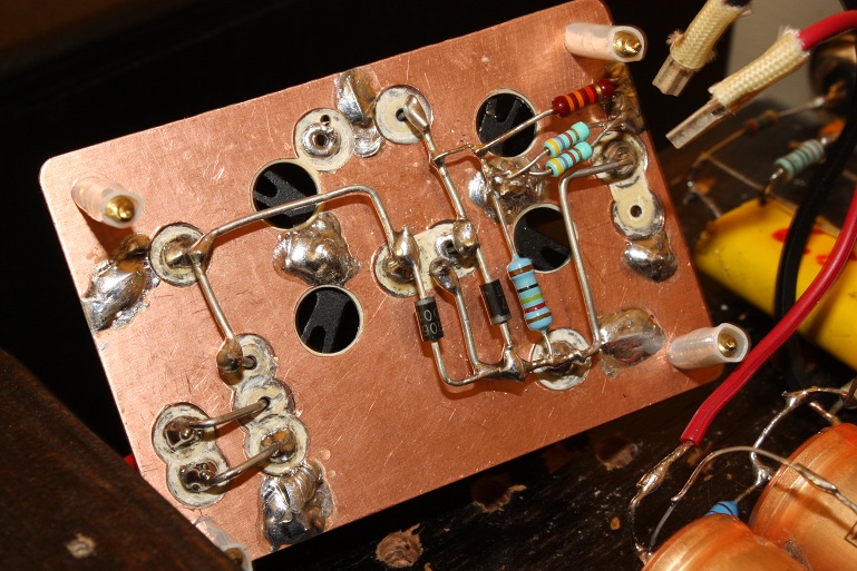

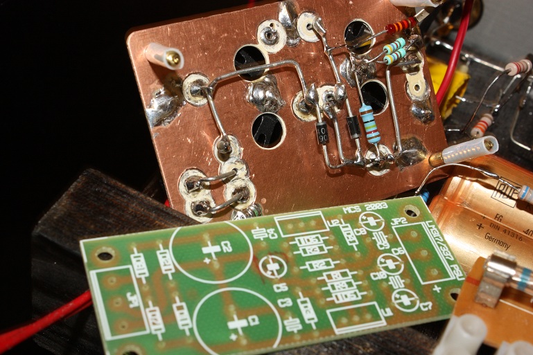

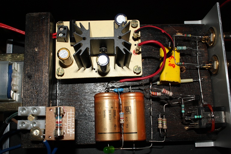

ok, managed to get the supply voltage down to 14.3V
drain resistor 8.2V/1K3, 6.3ma
source res 47.2mV/7R5, 6.3ma
DC before output cap dropped 2V to now 6V
and sounds real good, best yet
feels like I lost some gain
and no doubt that all controls works much better now
will try to up the voltage to 15V
and btw, hum is gone now
but only when I shut down signal on bass guitar
got it to 14.9V
nothing else seems to change
and doesnt seem possible to get higher bias with this voltage
but wow, it certainly cleaned up the sound
gave it a little touch of more power
seems like endless headroom to play with
I can live with this for a week or two
ready to move into a fine home now

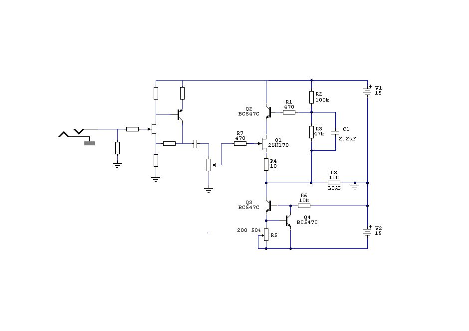

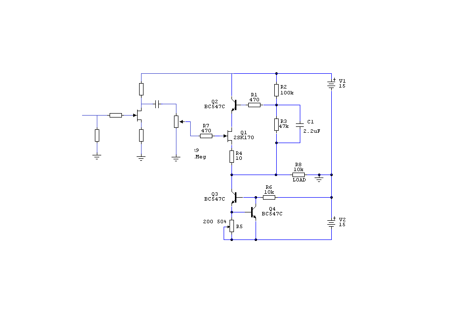

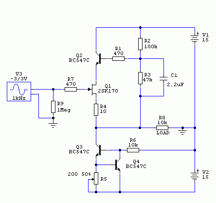

ok, it continues with attenuators, and hopefully buffers
I found a 'generic' simple one with a jfet and bjt
unfinished and a few parts missing
and juma posted a schematic I found interesting
and I have plenty of the BC547
lets see how it goes
yep, it's slowly getting clearer
well, I probably won't need any 'attenuation' of signal at input
att pot will be at power amp input(SS)
jfets are supposed to be the masters of hi-Z input
how high input impedance can we achieve using tube only ?

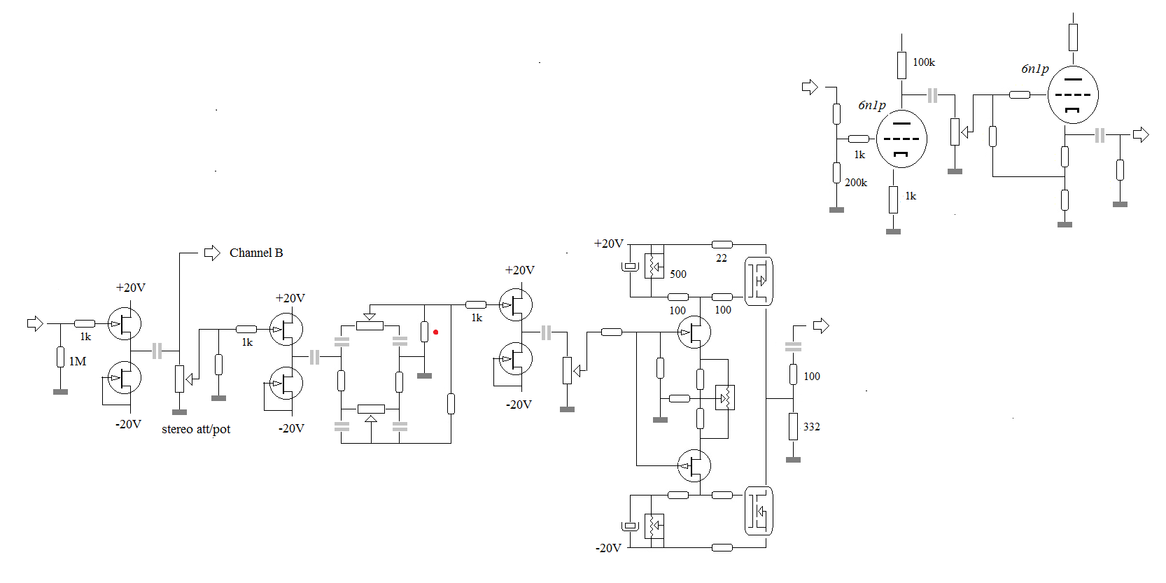

hi juma
yes, gain stage-att-buffer
input signal ? Im not sure
but in any case it will end with having multiple gain stages
the jfet boz I use now is more than enough
but will also be attenuated at input
maybe 12db will do
and maybe even the output 'buffer' could have moderate 6db gain, and still have low impedance
I dont think it have to be a unity gain buffer
whatever will be convenient too
z-in ? about 1Mohm at first input stage
at other places through the amp, Im not sure

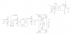

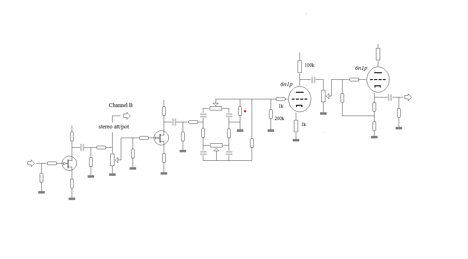

attached a couple of my messy ideas, just to show where I might be heading
and btw, its basicly the jfet related curcuits I want to look at right now

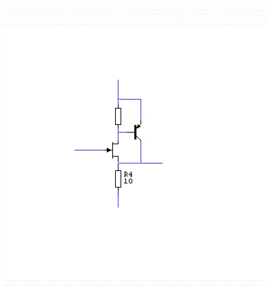

The Zout of J310 JBOZ is practically equal to Rd (680 R) which is OK to drive the Zin of the next stage of 47k or more. The usable voltage swing at the output of J310 JBOZ iz 5-6V peak (with more than that distortion becomes noticeable which might be acceptable in a guitar amp).
