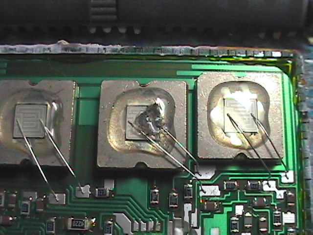

oh SVI3206's arent :down: theese ICs CRANK...
:att'n: MAKE SURE COOLING FAN WORKS :att'n:
Technics skimped out on the Heatsink - its ok w/ working fan.... however dust/heat dries motor bearings out which makes motor draw more current which o/c's the drive transistor, fan stops.
IC will run SO HOT that the output devices UNSOLDER THEMSELVES and SLIDE down (into other output devices or drive components) - annoying thing being is that a perfectly good ic destroyed by shitty fan drive circuit
- Baily :spin:

Did find the construction of the amplifier a bit cheap. +-15v +5v -24v regulators all on the same tiny heatsink with the monster Amplifier Ic. Taking 60 volt directly to the regulators, meaning lots of heat for such a Sink. Worst, the fan regulator was fried, has you predicted. Solution? Outside power supply with dedicated toroidal transformer. No heat, no firework Happy customer.

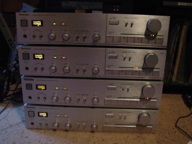

i love the V4X got 12 of em
got a few V2X amps too :)
> check this slice of heaven
Save Your Amp!
I am a repair man
the V4X, i know like the back of my hand
- not cos they break down, simply because theyre my fave amp.
the biggest prob w/ V4X amps are Q501-Q504 Pre Drive / Current Stabilizer 2SA1123/2SC2631 - Replace these w/ 2SA1124/2SC2632 - the faults these transistors can cause are usually ongoing safety operation/intermittent safety operation / safety operation after a certain time/ whistling (soft) / distortion & in the WORST CASE take out IC502 - SVI2004A by both goin short and applying both +&- to their respective input pins at the same time
Save the IC - its no longer Available and what for? the sake of replacing aprrox $7USD in transistors???
*** the abovementioned transistors account for a staggering 90% of the faults in V2X/V4X Amps.
whenever i get one of these amps, i replace these 4 transistors and breathe easy :)
