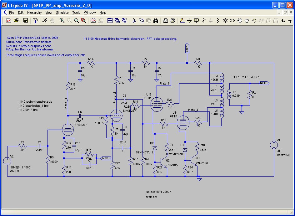

Well, the amp is finally doing what I expected it to. The screen voltage being too low was part of the problem as was the cathode bias.
I've tried RLD bias, Cathode bias (resistor), and my own Voltage bias (LED stack or Zener driving a TIP41 as a voltage sink. The LED string or Zener was from base to collector and a 68 ohm resistor from base to emitter as a voltage sink.
I've run the bias up to the point where I could barely see the plate seam start to turn red (all lights out) and could get over 14W out of it with 69mA cathode current and 252V B+.
I cranked it back down to 60.15mA cathode current which with 2.5mA screen current leaves me with 57.65mA plate current. Still a tad hot and I'll have to adjust it down some more. Zeners and LEDs have the disadvantage of only offering discrete voltage drops and thus discrete current steps.
I'm thinking of adding a small trimpot in series with the LEDs to allow me to tweak the reference voltage and thus the current.
That aside, I'm presently seeing :
B+ - 268V
Cathode Voltage - 8.64V / 7.71V (two output tubes)
Cathode Current - 61.75mA / 60.15mA
Screen Voltage - 252V / 253V
Screen Current - 3.25mA / 3.8mA
Plate voltage - 253V / 254V
Grid drive 28Vrms, Plate voltage 146Vrms into a 10Kp-p transformer with 8.3 ohm load resistor (Hammond 1609).
I can get about 7.58W out before clipping onset takes place (no increase in output voltage with an increase in input voltage). Max output power is 10.85W at 1KHz, but I'm sure this is producing massive distortion.
Sound is FanF&^*%ingtastic!

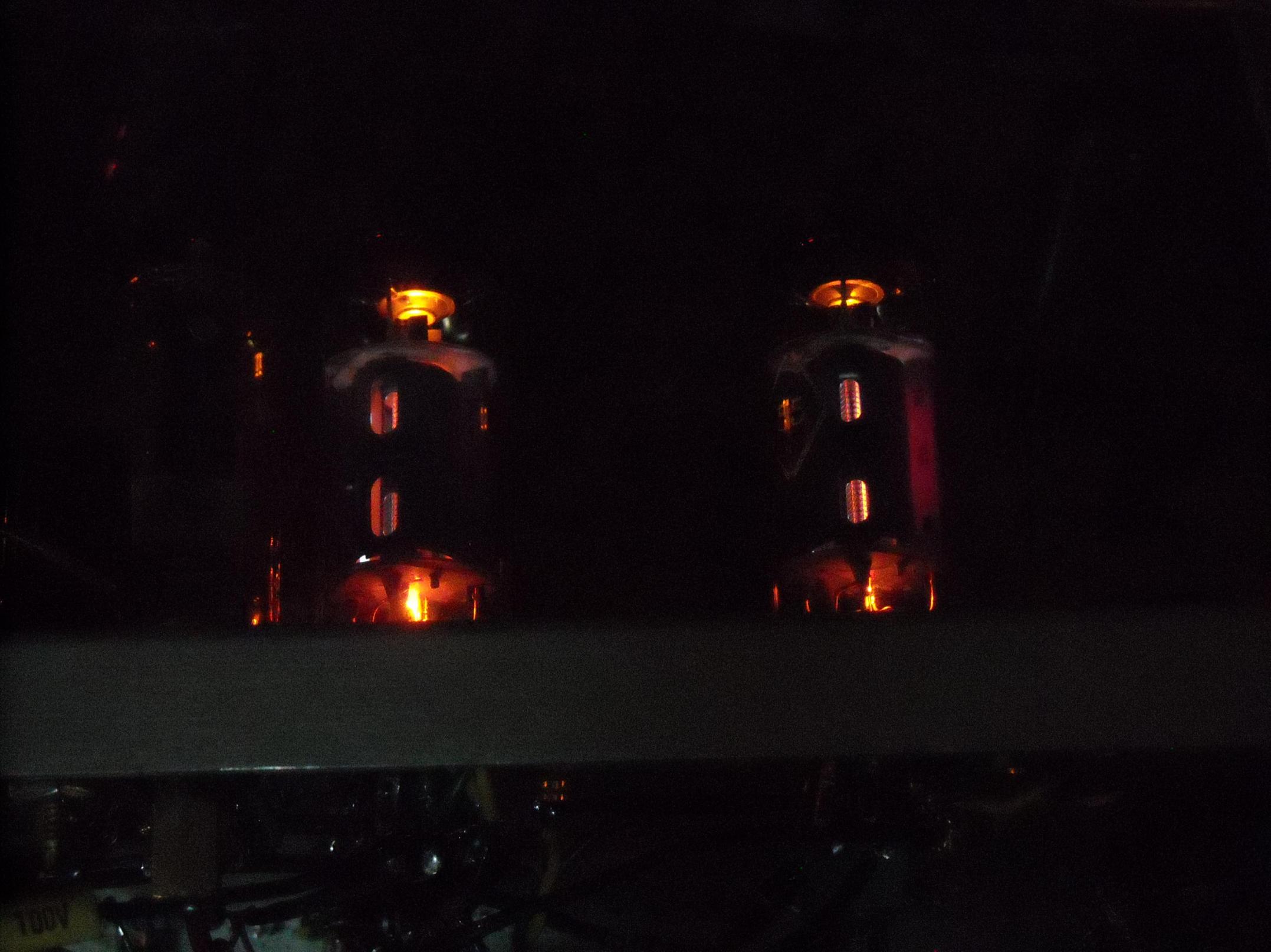

Today at the suggestion of one of the members I went back to simple cathode bias. 200 Ohm cathode to ground gives me 11.02V for 55mA cathode current minus 3.75mA screen current leaves me with 51.35mA plate current.
At 253V Cathode to Plate I've got 12.99W plate dissipation and a slight red fin on one plate so I'll increase the cathode resistors to 220+ Ohms.
The circuit is much less sensitive to Gm variation as far as the plate current running away which is very good.
Out of eight tubes with Gm varying from 3900 to 4950, only the 4950 tube seems to want to go red plate with a 220 Ohm cathode resistor. I can go up to 230 ohms and the bias voltage will go to 11.75V and still glow in the dark. I can't really see it if the overhead lights (17W CFLs) are on. If the bench lights (dual 45W 48" Florescents) are on I can't see it at all.

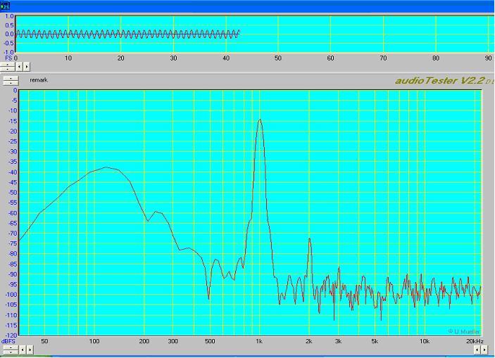

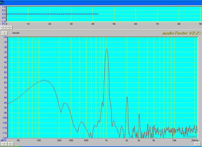

I finally got audioTester working after a fashion. I'm still having issues with occasional stack overflows and other weird problems that may be due to my decrepit system in the garage (Asus K7M with an Athalon 800).
Frequency sweep has a slight hump (<1dB) at the low end, and flat from 100Hz from out to around 40KHz (-3dB point). The top plot is the right channel looped back to itself. The lower plot is the left channel driving the amp, and the output of the amp driving the input with a 10:1 divider.
I got the fft and sweep to run, but because I installed a 10:1 resistor divider and anti-parallel diode protection (1N4148) network on the resistor to ground, the first plot is off slightly (3dB?). The second FFT was with the top of the resistor divider shorted, so no attenuation.
FFT in particular seemed to be very sensitive to the gain setting on the Output Mixer Level.
And I haven't figured out why the Line Out keeps getting set to Mute! Stupid computer (Yea Bill, I'm talking to you!). I still need to find out if the Sound Blaster Audigy SE is reasonable for this application or if I need a better sound card, since I can't seem to get it to operate in 24bit input at 192KHz sample rate. I get red text stating "mmsystem: format isn't supported". I can only get it to operate in 16 bit mode.
The analog input clips with 300mV. Other than this, it should not had any effect on the distortion showed.

Sorry for writing between the lines of your message, i just wanted to comment on the specific points.
I believe you do everything the right way: first simulating to get a rough idea if the topology works and get ballpark values for voltages, resistors e.t.c.
Then building-measuring-listening and adjusting circuit parameters.
Very well done!
Greetings from Athens (Greece)
Konstantinos
Thanks, I'll probably hold off on the sound card till I get Pete M's interface build and am more familiar with the system.
If I understand it correctly, to measure THD at 1W with an 8 ohm load I adjust the input 1KHz (or whatever frequency I'm testing at) to 2.828VRMS in. To measure at 32mW (my normal listening level with my speakers) I adjust the peak to .506Vrms and measure the peaks. Take all the harmonics and use the values to calculate the THD as the sqr-rt of the sum of the squares of the peak values.
The only issue with going over about 50mW is that the peaks may overdrive the input of the sound card, hence the 10:1 divider and diode clamps for higher measurements. I have to compensate for this as the measured values are 20dB lower than actual : V dB=20 Log (Vo/Vi) =20 Log (10/1) = 20dB?
Is this correct?
IM distortion measurements are similar, except I'm using two frequencies (440Hz and 1KHz?) as the input. No?
