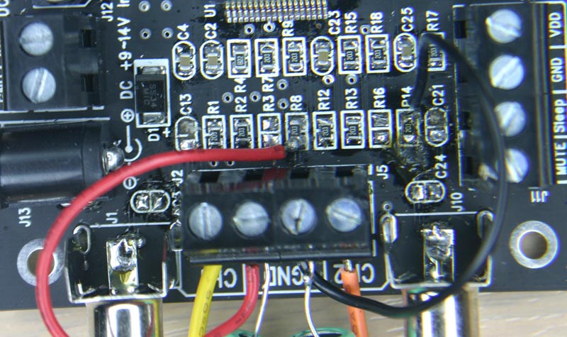

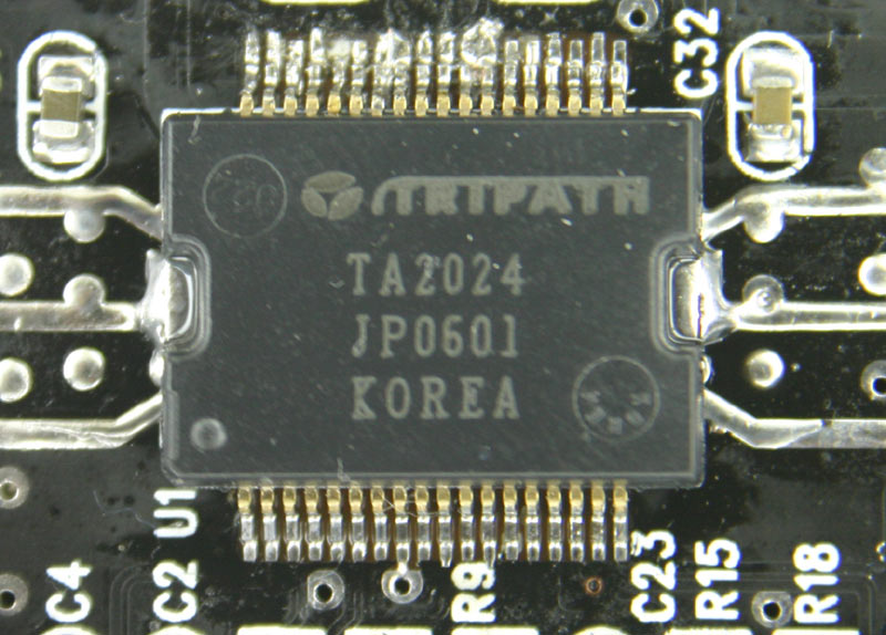

I've noticed that now the tripath chip gets VERY hot (I'm not sure exactly how hot, but it's too hot to touch) within about 5 seconds of powering on (I've checked the powersupply, it's delivering a lovely clean 13.4V, well below max for the tripath). This, along with the lack of any amplification, makes me suspect a short, but I can't see anything wrong.....can anyone suggest some test points I could use to see what might be going on?
TheSeekerr said:
The choice of a 2.2 was mostly dictated by what I had to hand. OK. So, to describe the current setup:
- I removed the quick and dirty hookup wires you can see in the photo
- replace with wire from the centre input terminals to the close side R8 and R14 respectively
- added an outboard pair of RCA jacks, with 2.2uF from the centre pins to the centre inputs.
Methinks this should work, and indeed, I no longer have the huge DC offset problem.....but neither do I have any output. This I do not like. Any more helpful people? (I can post more photos if this isn't a clear enough description)

Fist you are connecting to the wrong end of R14, should be the chip side.. R8 is right as you have it..
If you could post another photo that will help and hope we can rescue the chip..
I'll try to get that photo posted here sometime in the next hour or two (Eastern Australia is at GMT +11 at the moment, so it's 9PM and thus getting late - forums are a pain as a result). In the meantime, I'll reverse that connection......wouldn't be surprised if that's what's freaking out the chip, since that resistance regulates the input gain, doesn't it? Anyhows, we'll see.

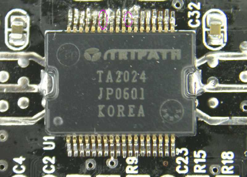

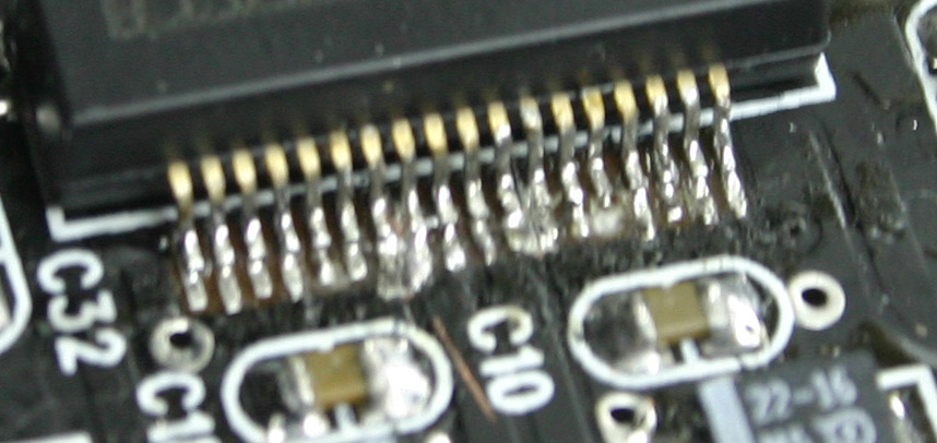

Here's the photo's - looking closely, it seems that some pins are bridged on the chips output side - but maybe they are V+ and V-? and that there's a lifted pad on an output channel pin (from me trying to remove some excess solder bridging that pin)...but maybe I miscounted. Have a close look please, any help is greatly appreciated.

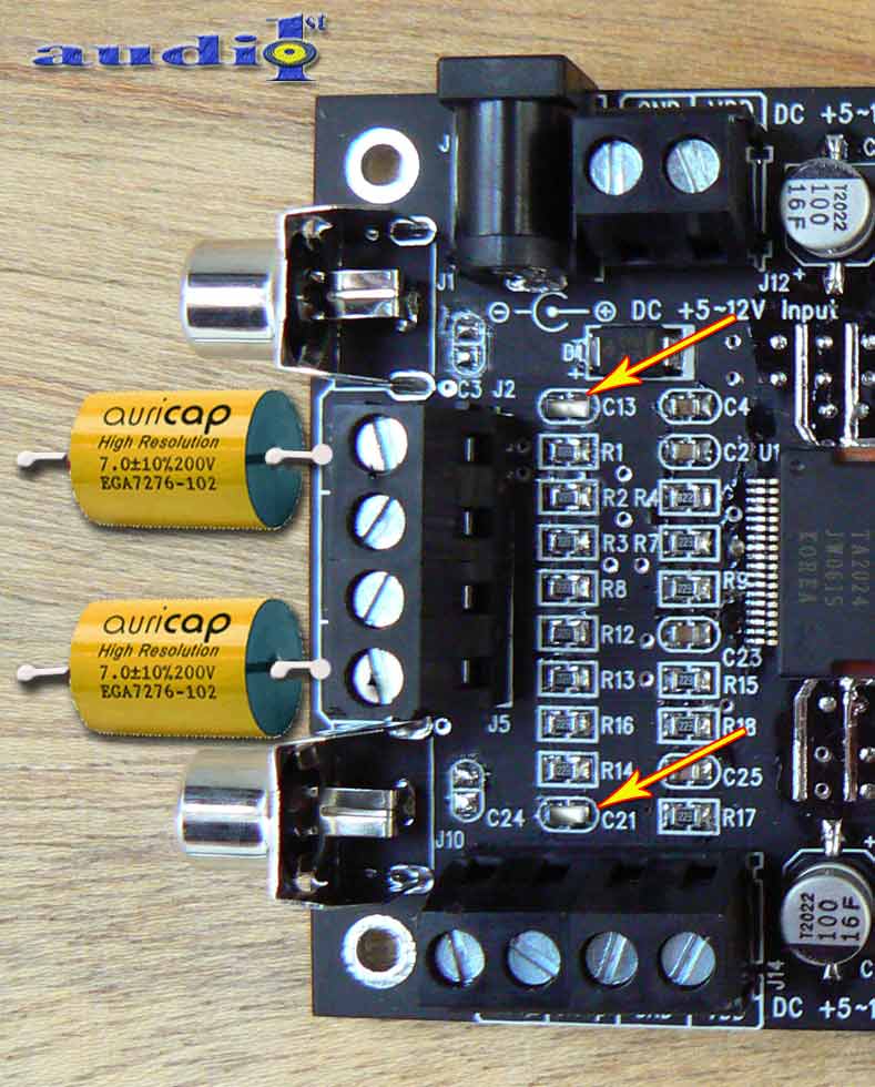

Hi , you are connecting the resistors to the wrong terminals.. Your caps are also connected to the wrong terminals.. R8 connects to CH1 not GND and R14 connects to CH2 not GND. The caps connect to CH1 and CH2, the other end of the caps connect to the centre pin of your new rca's. The ground of the rca's connects to GND..The attached picture just shows where the caps connect to the board. Ignore the arrows..
Those pins are supposed to be bridged. You DID test the amp before you modified it, didn't you?
Yeah, I did test the amp before playing with it, so I know it DID once work. Unfortunately I started modifying it to add a preamp and volume control, without testing it along the way....I've reversed what I could to get it back to this state. My concern over those pins was more about the general ugliness compared to the other side of the chip, so if anything was to be wrong, I figured it'd be over there. I'll reverse the connections you mentioned (will take ten seconds, just need to swap what's in the screw terminals) and see if it helps.
Often cleaning the flux/rosin from the board can make things such as shorts a lot easier to see. Ideally use isopropyl alcohol or methylated spirits for this.
My TA2024 is still sounding excellent btw. One minor complaint is that at times it can sound a bit saturated at the top end, with certain trebles turning into more of a hiss. Also the board is very revealing and any track hiss (white noise) makes it's way through to the speakers. I'm driving it with an unmodified squeezebox 3 as the source.
No clicks or pops when plugging in power or RCA jacks. Hard to say without a 'scope, but it doesn't seem like anything is making it to the output at all.
No measurable DC offset at input. 10mV at output without speaker connected, 1 - 4mV at output with speaker connected.
Still the same problem. Chip gets very very hot very quickly after applying power.
