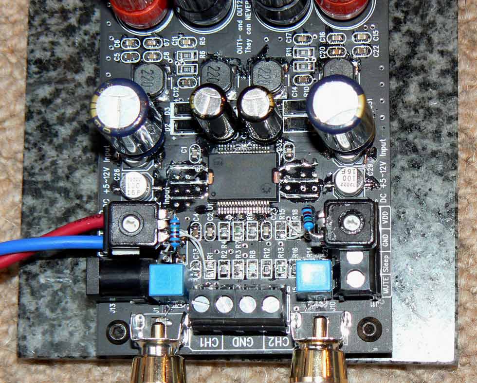

I've tried one of my boards after giving it a good scrub with isopropyl alcohol and as noted previously it sounds really dull and boring, nowhere near as bright as it should.
Mods so far...
Removed: C3, C24, C13, C21, R3, R16.
Added better input caps (3.3uF OSCON I think?), to replace C13, C21.
Added a 10,000uF tank cap across the power supply.
Powered by a dinky IBM Thinkpad SMPS 16V 4.5A
After the modifications it sounds pretty good into my Richard Allan 8ohm monitors, and with 16V it seems to have a bit more go with it. I guess that the tank cap will have helped also.
There is definately bass there, but I think it still lacks definition when compared to the more beefy TA2022 based AMP10-BASIC. I don't have a SI T-AMP to compare against unfortunately, but I suspect the same. Who knows, maybe those little SMT caps will run in.

A couple of pictures.
..tie wrapping the tank cap through the speaker post holes seems to work a treat

thanks for the summary and clear cut pictures will try to duplicate your efforts when my board gets here.

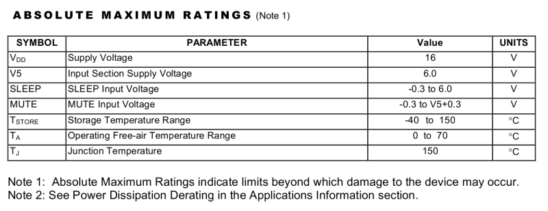

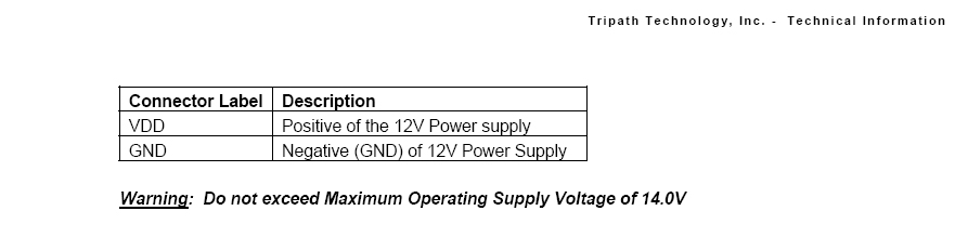

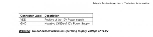

How is it still working??. I wouldn't take mine over 13.8V at the chip as per Tripath recommendation.
...well mine ran fine for about 3 hours without damage, I don't want to be responsible for any explosions!
I might put a heatsink on the chip, my guess is that the core temperature could be approaching 150 degrees at 16V VDD when played loud.

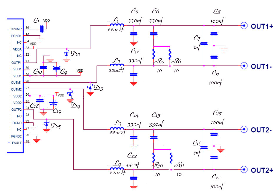

C8,C11,C17,C20 (The last caps in the output filter) all seem to be not needed if I'm reading the datasheet correctly. Let me know if removing them has brightened up the top end and I'll do the same. It just seems like an unnecessary low pass filter and could be attenuating the higher frequencies.

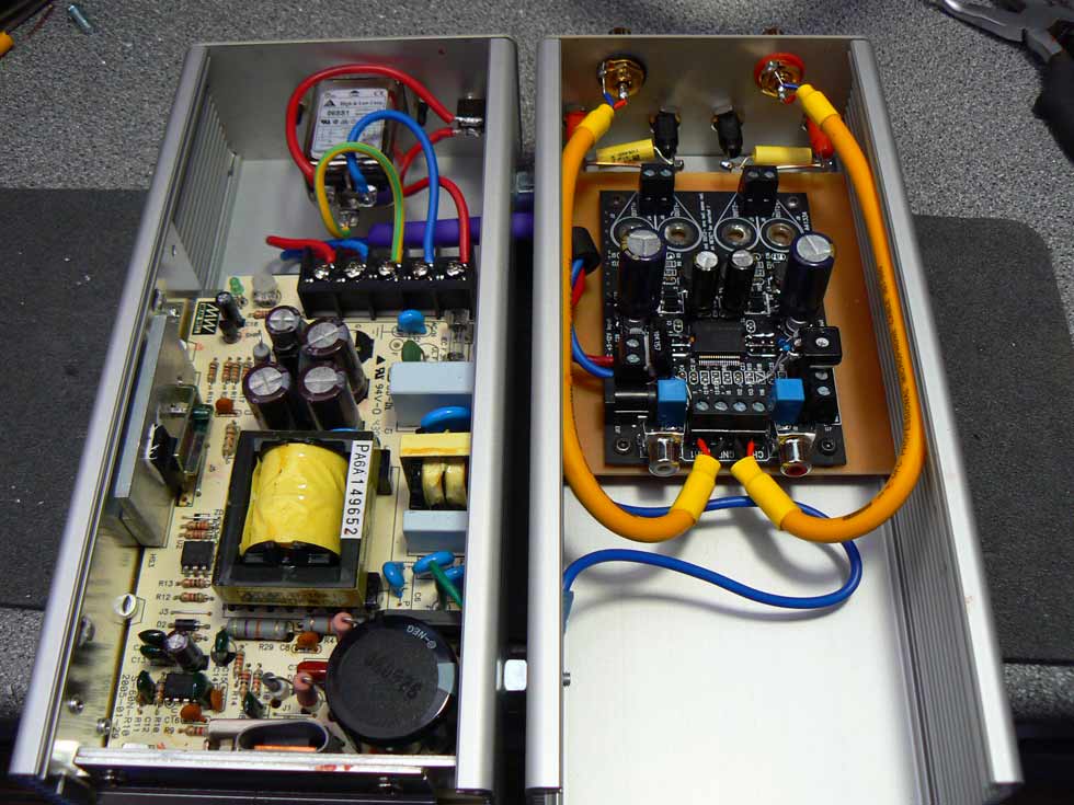

Cases are just the plain Hammond (Maplin), or if you need a longer case, as I did, then Rapid .
That's also where I got the 0805 surface mounts. The reason for the strange value of input and feedback resistors I used is they were cheap, none ROHS (my first time with new SMD's)..

PS the fist stage is more like 500nf than the 330nf shown on the diagram. (very hard to measure as they vary with temp)

I think for this project I'll get a small Hammond case, they look better than I thought they would actually. For the AMP10-B I think I'm going to fabricate a box from aluminium sheet as it has a rather large 500VA transformer that needs a bit more room.
