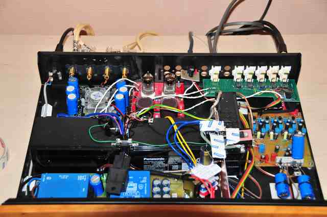

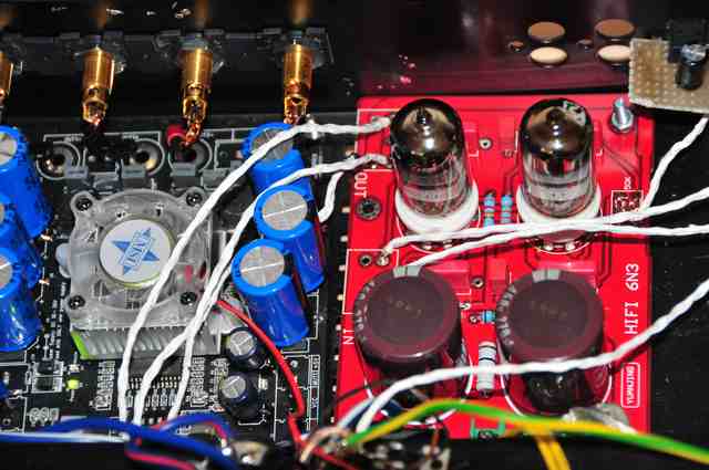

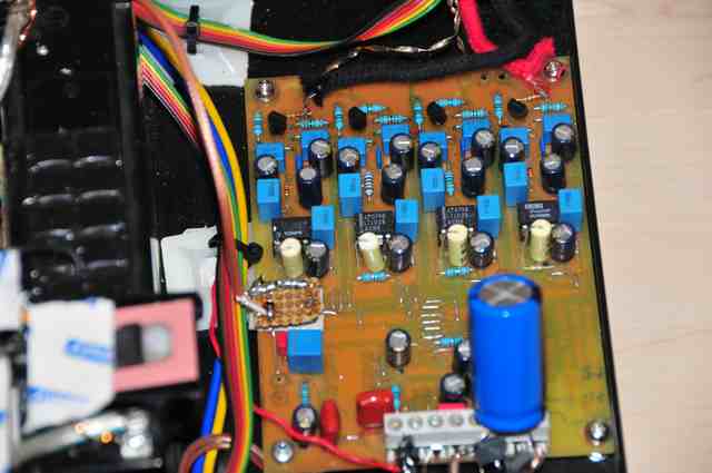

Just received my board
One of the buffer caps (220uF) is mounted with only one pin
I was replacing those anyway, but it says something about the quality they tend to use...
Will post a page with all my mods next week or so
One of my input caps was slightly melted so...
But they're not alone - in another of my Chinese amp, one of its input caps was also slightly melted.
If everybody does things badly it becomes average.
