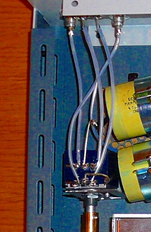

Some thoughts:
Why the big input caps? As v-bro said, they pick up RF and make the sound go bad
Why are you powering 2 sets of speakers with one board?
What are those diodes doing there, still onboard?
I think your right channel will be shorted quickly, as I can see the copper of the wires almost touching one another.
I dont like the soldering on the potmeter.
Go test it!

Hi Teamacc,
Thanks for the feedback.
The physical size of the caps were not intentional. I had to hand some 4.7uF LCR metalised polypropylene caps that I know sound great. They also fit the horizontal cap clamps - keeping them mechanically fixed.
This board will never be used to power two pairs of loudspeakers (i.e. min 4 Ohm impedance rating). The two pairs of terminals per channel are used for bi-wiring purposes.
D1 and D2 are still onboard for the time-being and I can easily de-solder them later. BTW, do I also need to solder pieces of wire to bridge the D1 and D2 pads? I guess I do.
Thanks for pointing out the right channel loudspeaker connections, it's actually the camera angle. However, all the same, when I add the Zobel network I'll heat shrink these further.
With the pot, I think it is the camera angle again. Although I love the sound of this Alps pot, the issue is that it uses pins not tags. For each pin I had to tightly and neatly wrap the solid core hookup wire and then flow the solder through it. Below is part of another photo taken from a different angle on the same night - I really still need to take a proper close-up as the reality still looks better.
BTW, I have it running at a low volume (daughter asleep) right now. Already showing a nice mid band and detail. Likely to need further tweaking, e.g. pushing the PSU voltage up, Zobel & D1/D2.
Cheers for now,
Andrew
Solid core silver hookup wire loosely insulated with teflon tube? Cool. You might have to run twisted pairs instead of the separate wires to keep noise pick up down especially after the pot.
Well spotted! Yes I realised a bit too late that I should have twisted the hookups to the pot. Maybe for a later day.
BTW, the rest of the cables are taken from some spare Linn K400 loudspeaker cable - where I extracted the cores from their massive PVC jacket.
Andrew
Supply in
I looked at the photo again and I see your power supply is coming in from the far side. That makes the path take the long way around through the diodes and then back around to the chips. If you want to eliminate the diodes you can attach the power wire to the output of the diode instead. I plan to try adding a larger tank cap and then sneaking the power wires under the heatsink to attach them to either side of c46.Well spotted! Yes I realised a bit too late that I should have twisted the hookups to the pot. Maybe for a later day.

I don't implement the Zobel because its main role is to reduce the filter overshoot which is widely out of audio spectrum.
After the output filter I was not satisfied with Bass So i've implemented 2x4700uF low ESR in parallel with existing capacitor, directly soldered on it according to the power rail. The bass the are dryer and clean.
The next step is to modified the input stage of the Amplifier even if the modifications made at this time increase very much the amplifier performances
I'm running the amplier with the Tripath typical voltage recommendation 24V using a 120 W SPS (6ohm Speakers = 2x45W typical)
- Class D
- Sure Electronics New Tripath Board tc2000+tp2050
