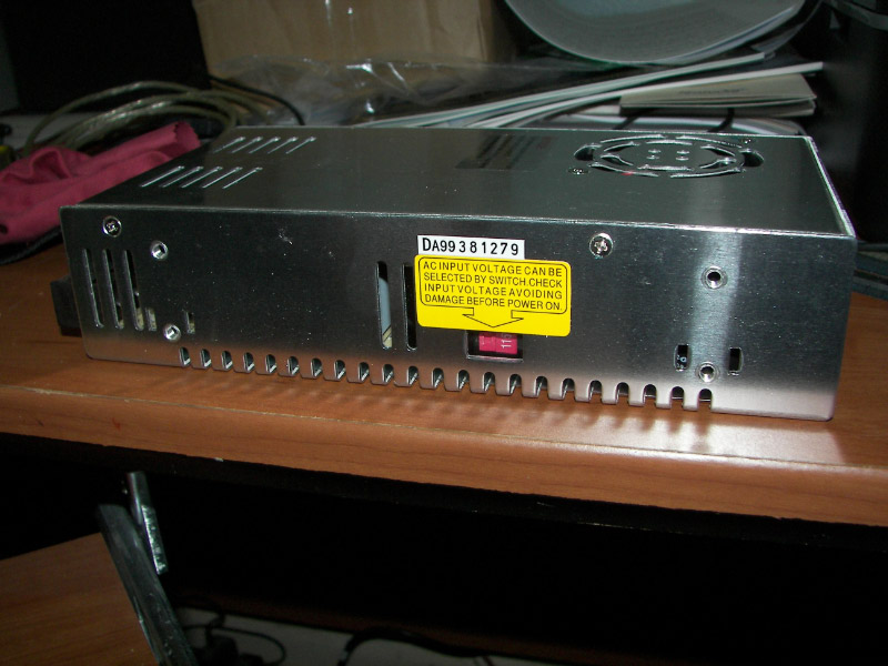

Meanwell comes set to 230v
I can’t believe I forgot to do this.
Well, I now know that when you buy stuff from China,
They don’t know what you’re going to do with it.
Remember that hum I have in my Class-D audio amplifier?
Well it ain’t there no more, thanks to a little switch on the
Power supply. This is the one that say 230/115V.
Slide it to 115V. Duh!
Image Of Meanwell Slide Switch
OK, here's the switch!

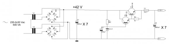

i'm still listening with a linear regulated supply.it's ok.

Hence my preaches to avoid anything with a fan and just build a plain and simple good 'ol linear supply!

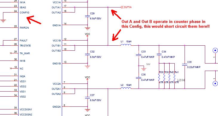

Found something:
According to the Tripath datasheet, the config pin (pin 24) should be connected to Vcc, whereas sure connects it to the ground.
With pin 24 to ground, the TK2050 acts as a stereo amp chip, whereas it is a bridged amp chip.

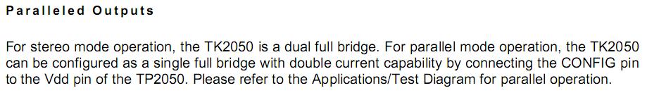

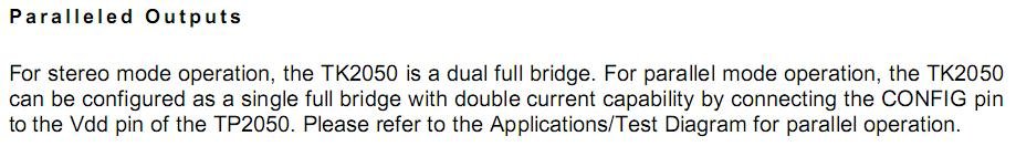

For stereo mode operation, the TK2050 is a dual full bridge. For parallel mode operation, the TK2050 can be configured as a single full bridge with double current capability by connecting the CONFIG pin to the VDD pin of the TP2050
If this actually is something that might work, all credits go to elfishi, who first posted about him connecting pin 24 to Vcc

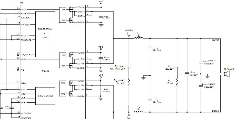

The board design is for non paralleled operation!! So NO don't connect Config to VDD I'd say. This would halve all series components in the output filter and place all parallel parts (like the zobel) offside!! It would turn the whole output filter in to a gigantic mess!!
EDIT: At hind sight the Sure board IS for parallelled TP2050 configuration, the Sure documentation present something that in my view wouldn't even work. If both bridges in each chip would work in counter phase (Config pin to GND, 'stereo' operation on the chip) then a board design for parallel operation would short circuit them out completely... Config would HAVE to be tied to VDD...
There is just an error in the sheets I hope... it couldn't be like this on the Sure board!!:confused:
Pic1 From the Sure sheet
Pic2 From the Tripath datasheet
Pic3 Description from the Tripath datasheet
