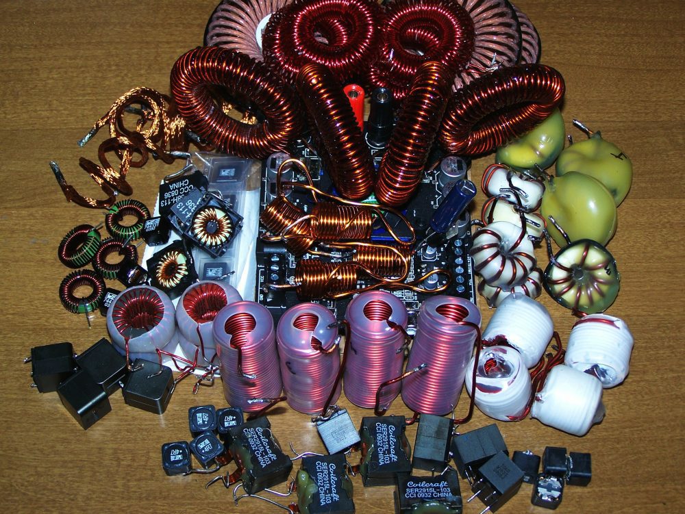

The importance of the output filter chokes is often underestimated, I have noticed several improvements of using really good ones. One advantage is lower current draw, another is less saturation at higher frequencies and higher power. All those cheapo ebay boards use output filters of the category "pure crap".

Regarding the coils, will these do the trick do you think ?
WUERTH ELEKTRONIK|744824622|CHOKE, COMMON MODE, 2.2MH 6A | Farnell United Kingdom
Nope, TOTALLY unsuitable. What you need is something that responds well with high current signal of more than 1Mhz. Common mode chokes filter fairly low current high frequency noise. You need a choke with a low perm core of sintered iron powder or MPP. Ferrite is quite unsuitable too. Beware that on saturation the cores can become excessively hot and even mess up the current sensing of the amplifier. Stuff blowing up due to this is not unlikely.
Apart from the risk of more emission I would rather recommend to use no core (aircore) than the wrong core material.
I have had TA3020 amps that went down from 90mA per rail of idle current (already quite good) to a spectacular 60mA per rail with a different inductor. Always beware that the output filter Q determines much of the in band linearity of a class T amplifier. This means you can have a rise of higher frequencies in the audio band. Some may experience this as pleasant and write raves about such an inductor, while in fact a treble boost would have the exact same result.
It's OK to fool yourself but best to try to stay objective in public. Also for this reason do be careful with what you read on forums.
This is not easy, I don't think they have any suitable ones at Farnell. There are suitable ones from Panasonic, but the cheapest ones and probably the best ones are what you can wind yourself. Core manufacturers often are willing to send you samples. MPP cores are by far the best and I would recommend low perm (something like 20 to 60) Iron powder cores are also very suitable, this is what Tripath used themselves.

I've listened to quite a few different coils including the ever popular T106 type 2 toroids from 41Hz and the Ferroxcube toroids as found in the ClassD audio amps (much better sounding but leak like an air core) with three different types of wire. 14ga Litz wrapped and unwrapped, 18ga solid, and Belden hard insulated 14 guage solid. And other recommended favorites from Toko, Sagami, CoilCraft, ect. The Wurth XXL were tried on a tip from another member or I wouldn't even have glanced at them. They look just like what you are taking out. Luckily I am open minded. I like them by far the best. They even sound better than my Belden air toroids in many ways, have a 13 amp saturation rating and they fit right in the stock location. I will use them exclusively. There are tens of very similar looking coils and tens more of larger types but the Wurth XXL have the best sonics of the ones I have tried.
Be careful with this to check the saturation frequency it was tested on!! A 13A saturation current at 100Khz can become a whole different story at 1Mhz!
Just connecting a million chokes doesn't necessarily make you an expert either... Have you done any measurements with all these chokes? It is not that hard, just connect up a tone generator and the amp on a lab supply (or PS with Ampère meter(s) in line) , make a sweep up to 20K and check the current consumption of the amplifier. When the cores hit their saturation point the current will go up rapidly.
Not to say that I'm personally an expert, but not a noob either. I have understood from application notes and personally from an expert I know that ferrite is an inherently a bad material for this purpose because it has very poor high frequency/high current capability/HF saturation. What you may find providing a "nice sound" can perhaps be mere distortion....

I have some Sagami 7G17B. They sound very nice but 10uH is the lowest value and I have found that going lower than the text book predicts is very beneficial to the sound.
If you look at the Wurth XXL docs you will see that the 13 amp rating is conservative, the current vs inductance charts showing a very gentle saturation characteristic similar to the carbonal toroids and they have a high resonant frequency. The Wurths XXL are very safe to use with the TK2050 chip set and have a much higher current capacity than the hair fine coils that come in the Sure 2X100 amps.
