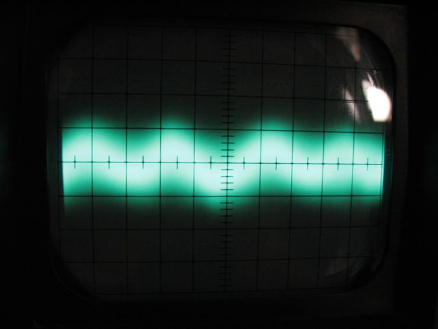

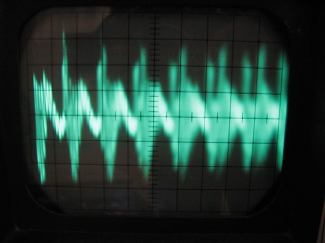

I wonder what the scope pattern would look like with the power supply actually powering the amp at high listening volume and with the supply outputs left floating as in the poor example? Would the amp pull the negative supply leg to audio ground and stabilize it with out the need for the jumper? It would also be interesting to see if the music power demand can modulate the supply at all. The MeanWell supplies sound very stiff to me.
The effect is swamped by the switching noise of the amp feeding back (through almost 20mF, mind you) to the PSU. The first attached pictures shows the scope reading taken at the PSU output terminals with the amp powered but idle at 20mV/div and .5us/div. The second with a 85Hz signal at quite loud, 20mV/div 5ms/div. Both taken with the cap btn COM and Earth in place. If the cap is removed the result look slightly different, but the signal basically spans the same voltage.

So that's close to 40mv ripple? coming back from the 650kHz and almost as much from the 85Hz which would be the .012 seconds per cycle wave in the second shot. Doesn't look all that impressive but the MeanWell power supplies certainly sound great. You added an additional 20,000uF capacitance? I would have thought that would knock the 85Hz ripple down more than that.
I replaced the tank caps on board with 4 x 1800uF Pana FM and I have 3 x 3300uF Yageo low-ESR caps and a 0.39Ohm resistor btn board and PSU.

I would be curious to see the phase versus the speaker output on a B channel. Is it possible that the inductors in the power supply are pumping like a current source and actually boosting the voltage as demand from the signal modulates the positive rail? The patterns don't seem to jive with the sound improvement I get when changing my linear supply to the MeanWells. They are in a whole other league. Much faster and more dynamic sound.
