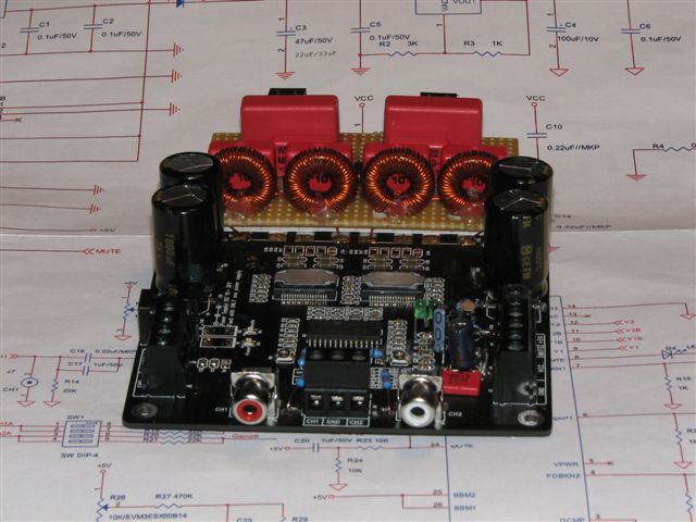

I have some spare time while I wait for the new sure board to replace the one I scorched. So I completed the list of mods and things around the board I did. Maybe you find that interesting.
PSU Mean Well 24/145:
- cranked up to almost 30V
- 0.47uF MKS btn GND and COM
Sure board:
- changed PCB traces per audio1st suggestions (http://www.diyaudio.com/forums/showpost.php?p=1855510&postcount=145)
- removed D1,2
- added 0.1uF parallel to C6 from the underside of the board
- exchanged C22&27 for 470pF as per the TC2000 data sheet
- re-wired pins 24 on both TP2050s to 21,22 (Vdd) instead of gnd
- removed tank caps from rails and replaced with 2 x 2 Panasonic FM 1800uF/35V on the rails
- replaced C3 with same type Pana FC
- added 0.1uF/100V MKP4 parallel to C3
- replaced C4 with standard-middle-of-the-road cap 100uF/10V
- replaced R2 with 2 green low-current LEDs, V_F=2.0V
- replaced R3 with 470Ohm
- added diodes 1n4001 btn Vadj/Vout and Vin/Vout
- replaced output filter
  • 12uH self-wound toroids: T68-2 with 46 windings of 0.6mm enameled wire, sets of 2 plain windings followed by 1 clove hitch to double up the wire layer on the inner perimeter of the toroid
  • .47 uF/250V MKP4 as common mode capacitors
  • .22uF/630V MKP4 (had those in the box) as differential mode capacitor
  • .22uF/250V MKP4 as Zobel capacitor
  • 10 Ohm/1W Metal Oxide as Zobel resistor
- replaced R16,30 with 22kOhm metal film
- interrupted traces btn input RCA and screw terminal
- removed R11,27 and replaced with 22kOhm metal film connected btn old solder pad and screw terminal
- removed R4 to open loop over SignalGND, Earth and B1
- added modified Pass B1 buffer (http://www.passdiy.com/pdf/B1 Buffer Preamp.pdf, http://www.diyaudio.com/forums/showpost.php?p=1539729&postcount=1) to input
- 1nF/1000V MKP4 from speaker terminals to chassis
B1 specs
- R1 2.4 Ohm
- C1,2 2 x 3 x 3800uF/35V Panasonic FC
- C3 1uF MKP-10
- Cx00: 1uF MKP-10
- Cx01: 2.2uF MKP-10, directly linked to input resistor of sure board
- Rx05,x05: dropped
- 50k Vishay conductive plastic, log taper
- added 1N5401 to input of positive rail, bypassed by a 1k resistor for a controlled discharge of the caps (otherwise the sure amp makes an ugly noise when going down)
Soft Start/ Mute On Off Circuit
- 24V/0.4W relay 8A 2CO contacts (tyco RT424024)
- 2 white LEDs (~6V drop) in line with coil
- 47 Ohm/ 5W resistor to fill the tank caps up to operating voltage for the relay
- 1N4148 parallel to relay coil
- 0.39 Ohm/5W resistor to filter the power supply and to sense the current
- TL081 as comparator (TL081 can work in high-side applications)
- 2 x 10k voltage divider to drive a
- BS170 that mutes the amp when power is switched off and the tank caps unload via the SMPS and the current sensing resistor
- 100uF btn MUTE and GND to keep the amp mute a little longer
- 3 x 3300uF/35V Yageo SY tank caps
- 1800uF/35V Panasonic FM next to output (close to amp power input)
piccie of the board w/ toroids and schematic of the "mute on off" circuit attached

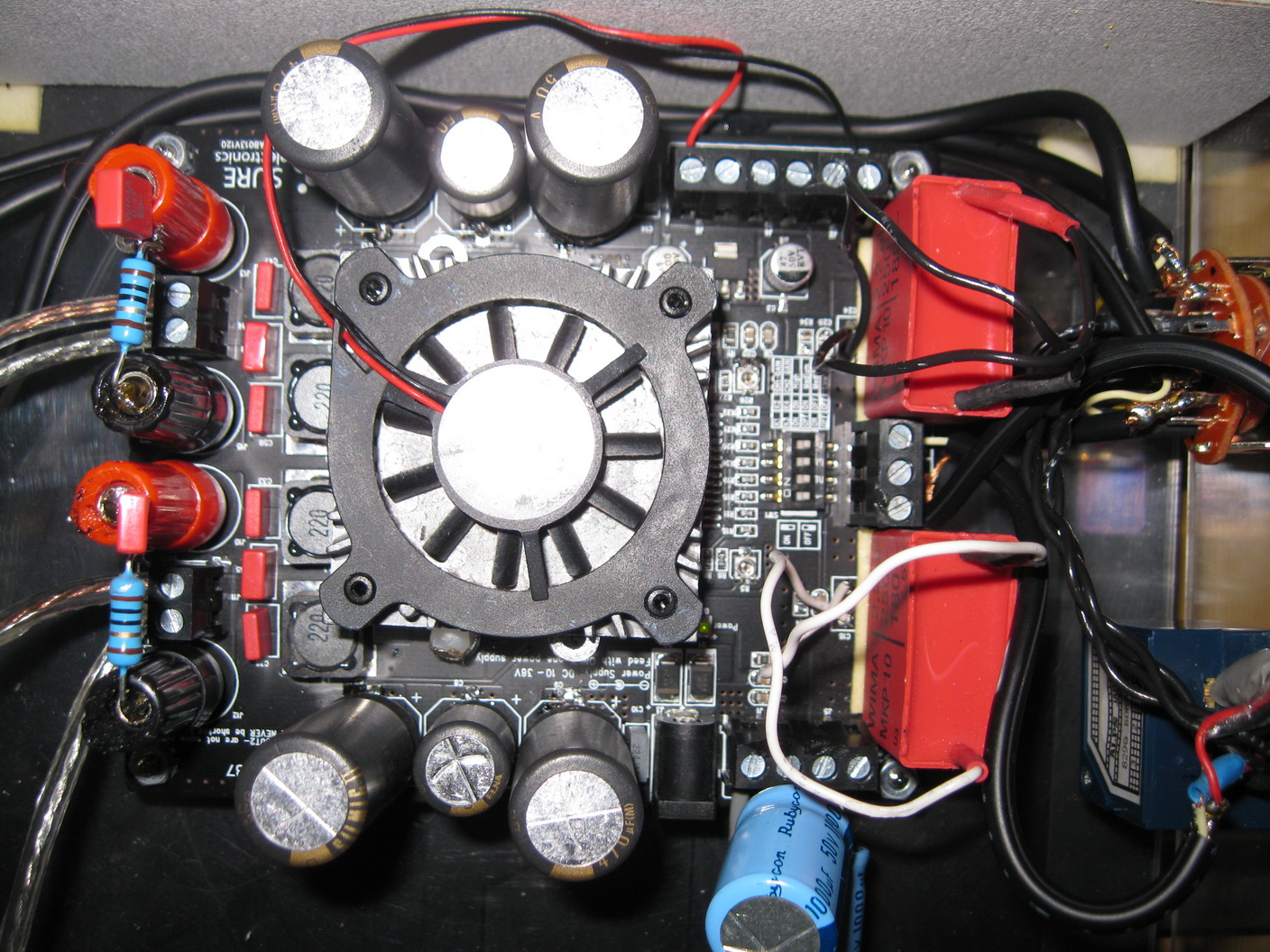

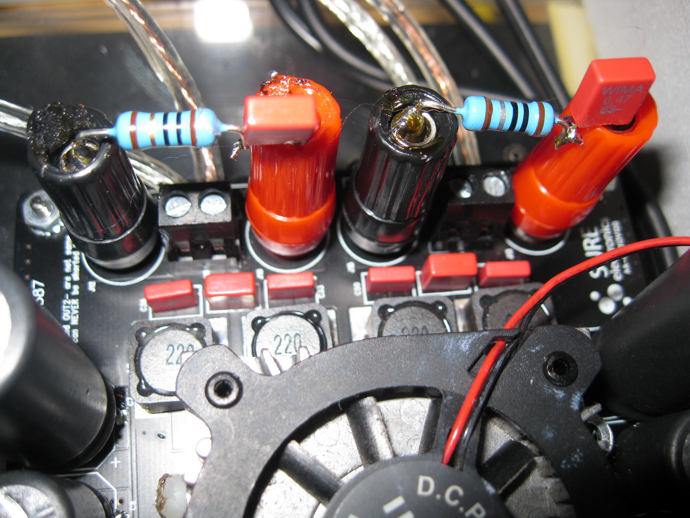

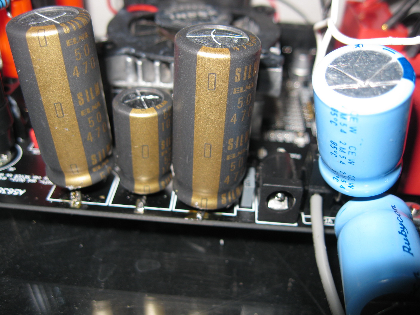

My latest mods!
I went shopping in a local electronics haven, but could not find the inductors that I wanted (11uF with Carbonyl-E toroidal core). And I was not also confident of being able to remove the existing inductors without damaging the board. So I decided to keep the existing inductors meaning I got stuck with the cut-off frequency of 41Khz (at my speaker's load of 8 ohm).
I decided to try the "simpler design" I mentioned in my previous post so I bought some WIMA MKS2 as I was not able to find MKP2 or FKP2. The differential caps are 0.33uF and the shunt caps are 0.068uF. I also added zobel caps rated at 0.47uF along with 10 Ohm 1W 1% metal resistors.
While at it, I also thought I would try replacing those tank caps. I visited a dozen shops in search for Panasonic FC or ELNA SILMIC remembering their mentioning in the forum, but none of them stocked the caps to my disappointment. So I ended up buying two 1000uF Rubycons. But then when I was about to head home, I found a small shop selling ELNA SILMIC II after more than two hours of walking and searching! I bought 4 of 470uF and 2 of 100 uF because they were only the SILMICs she had in her shop! Also in my shopping bag were an ALPS 50Kohm potentiometer and a 4 pole 3 position rotary switch.
After half a day of tinkering around filled with anxiety and frustration especially with the wiring, I finally made it! You can see my shoddy soldering and wiring work in the pictures attached. :eek:
So how does it sound after the mods? Well, one thing I can say with certainty is that bass has become A LOT more powerful yet controlled. I can hear more clearly when the bass comes and goes. However, I am not sure if it has lost a bit of clarity and sharpness. Initially, I felt it sounded less sparkling as it used to, but then more I listen to it, I am beginning to like the new sound in that it sounds a bit more balanced and natural. I just wonder how much sound I have lost due to my shoddy wiring and soldering. :eek:
