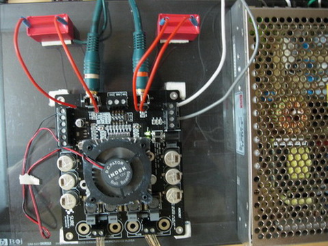

I am happy to report that I finally collected the courage and have replaced the input caps following the excellent instructions from Audio1st, Whelibob and others here. Thank you all!
I tried to follow the path taken by Whelibob as it seems to require minimum "desoldering and soldering" except that I had to use some extension wires as my WIMA MKP10s are bigger.
I removed C16, C24 and removed C17 and C25. Then I soldered the wires from the WIMAs to where C16 and C24 used to be. I hope I have done it right. Do I also need to remove the registers R14 and R34?
I get popping sound when I turn the board; not too loud but still audible. Is it normal or have I done something wrong?
I just used the wires I salvaged from an old computer PSU cables. Are they ok for connecting the capacitors? Or Is there any special kind of wire that I should have used?
Good looking work, swkbkk! The wire looks fine. If you get any noise on the line, you can twist together each pair of wires. Not necessary, but it will help in an electrically noisy environment.
I generally use Cat5 or Cat6 wire because it is easy to get, easy to work with, solid core (so it stays where you bend it), and it is a very good quality conductor. Plenum rated Cat5/6 has teflon insulation, which is very nice.
I don't know what resistors R14 and R34 do. They aren't on the Tripath reference schematic. I left mine in place.
The popping sound is from the capacitors charging. It is normal. If you add more power supply caps, it will get louder. You can do muting circuits, either with the mute control or with relays on the speaker outputs, to keep the speakers off until the caps are charged, but that's a bigger project.
Just one suggestion, if you're running at high volume, you might want to replace your power supply wire with heavier gauge.

Thank you, dr_vega for the compliment and suggestions. After having braved on my first diy project, albeit being a rather small mod, I feel a little more confident now :D
I just used "Sure" supplied 16AWG wires that came with the board. I will replace them if I can find thicker wires somewhere.
