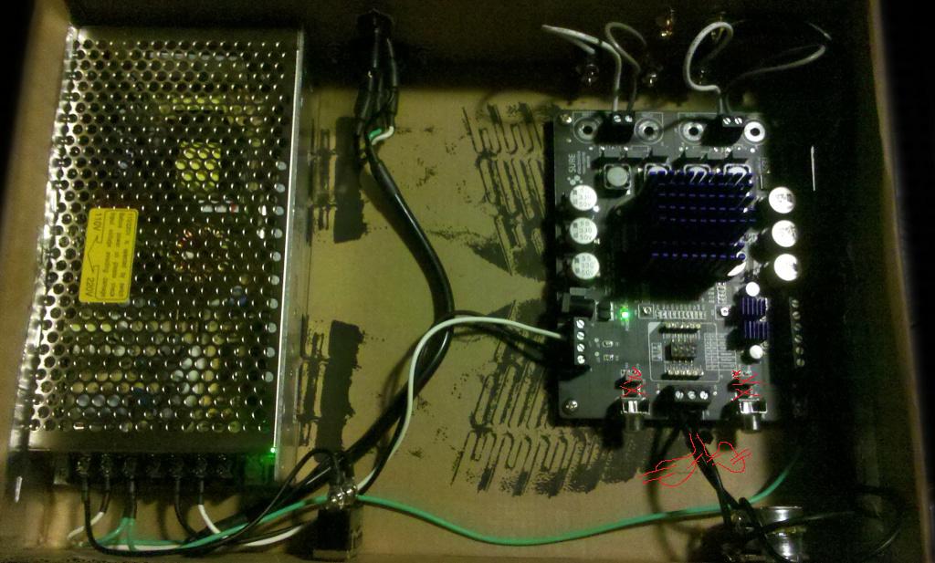

First post, plenty of questions...
Hey gang,
First post. Been doing PLENTY of reading/research on here and the net before attempting this project. I just got myself one of these amps (AA-AB32181 to be exact). Powered with the S-145-24 MW amp (28v). I have put the infamous blue Zalman heatsink on it already (with Arctic Silver Ceramique 2). Been listening for a few hours, definitely a fun project and likely has a lot of potential. There are a few questions I had on it.
1. U2 on this amp gets pretty dang warm. This is what makes 5V on the amp? Sorry for my ignorance, I'm no electronics guru, just read the diagram am guessing that's it's job. Anywho, I put a small heatsink on this, as well as U3 (which stays cool). I doubt there is any harm in this, but is this worth doing? Ease of mind, if anything?
2. With the stock heatsink, the fan turned on after 5 minutes or so. I kept the fan plugged in for testing to the side and, with the Zalman on it, I have yet to see it turn on after about an hour of play. Curious, anybody know what temp the fan is supposed to turn on at? Also, multimeter says only 9v at the + prong on J2 fan connector, with grounding directly to the COM from the PSU. Grounding to the - prong on J2, I get around 1v. Not sure why that would be, but I can feel and here the fan sounding like a hard drive, clicking away. Just no movement. Hoping I didn't hurt something when I swapped, as the fan simply never turns on properly.
3. My board came with 2 completely different set of tank caps. The side closest to the power input is the same I have seen in all pics, but the right side say "nichican, 330MF, UG 50V, H0645". It may be a mental thing, but it bugs me to think that each channel has different caps (or, at least, labels on the top :p). With that, I was debating between adding tank caps and replacing. Should this be more motive to replace rather than add to?
4. The input sensitivity switches (SW1) completely mute the sound when all switches are off. It seems the older version did not do this, as it was recommended to turn these all off in prior documentation here on the forum. What is recommended here? I ended up buying a bunch of 1W 22K resistors with my order, just in case I wanted to play with anything. Are these worth changing, or are there better options?
I think that completes my questioning. I have plenty of plans for this amp and lots of experimenting to do. I'm hoping this amp can really help me learn electronics better, especially with the diagram available and plenty of great help from this forum. Sorry if this is long winded at all. ;)
I attached a pic of my current setup. Don't lol too hard at my shoebox enclosure... :D It's only temp until I decide how I want to build it.
You are right here, it is the 5V regulator. Don't know if the heatsink is needed, but it won't harm to put a heatsink on :) cooler is always better.
the problem with the fan(controller) here is that it is PWM controlled, and not very well done... the PWM controll starts at a specific temperature, but not on a duty cycle high enough for the fan to start turning, this is probably what you are hearing....
don't know if it really matters, the audio purists here will surely tell you to remove them ;) and get bigger better pricier good brand ones instead. ;)
better options?
look at the pic,
firstly remove the transient voltage suppressors (black ones),
secondly remove the input caps on my board C18/C19 and C24/C26,
and add some good quality caps on the place I marked before the board.
look at my previous post for an example of good input caps :)
I noticed a dramatic improvement of sound :) (I think mainly because of the voltage suppressors)
