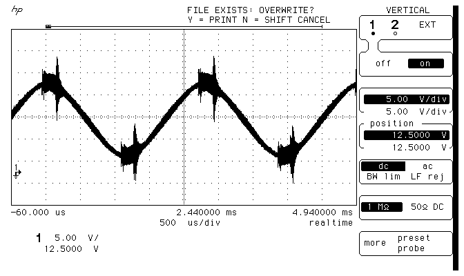

I just bought one of the new SURE Electronics "2 X 25Watt Class D Audio Amplifier Board - TDA7492." When it arrived it actually had the TDA7498 chip on it, with the 2 X 100W capability (no fan on the heatsink though, and you would probably need one at 200W ). I paid $23.66 for it - a bargain.
So, even though I might be accused of 'looking a gift horse in the mouth', here are the problems which I found in this new SURE design. There are 1500uF of supply capacitors, made up of seven 220uF/50V caps, which is probably enough, although barely. The board is well laid out, with a gain switch for 4 selectable gains. Ground and power planes are designed well. The heatsink is easy to remove without damage - don't lose the spacers, though...
However, SURE need to send their designers to a training course on Class-D output filters. The data sheet for the TDA7492 shows, for 8 ohm, 33uH and 220nF, with 100nF to ground and no Zobel output damping network (to understand why these components are there, look at, eg: Class-D Amplifier Output Filter, Class-D Output Filter, Class-D Amplifier, Audio Power Amplifier, Low-Pass Filter, Common-Mode Filter, Sinle-Ended Output, Yun-tao Zhao, Class-D, Audio Amplifier, BTL Output, LC Filter, Hybrid Filter, John Widder, Audi
For the TDA7498 the suggested inductor has changed to 22uH, the main cap is 470nF (for 8 ohm), with 220nF to ground. A Zobel damping network of 200nf and 8 ohms is used with the more powerful chip.
When SURE decided to change to the new, powerful, TDA7498 chip they clearly didn't bother to change their output circuit. Actually, what they have on the board wasn't even correct for a TDA7492, but I have already suggested remedial training for these designers . Anyway, as you might expect, the board is unstable.

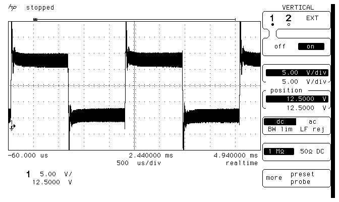

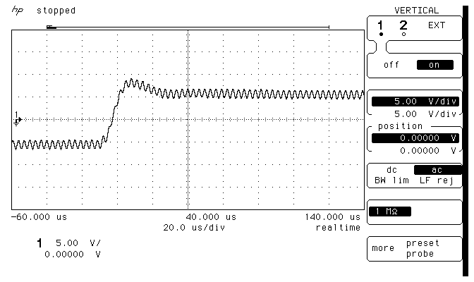

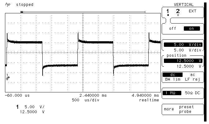

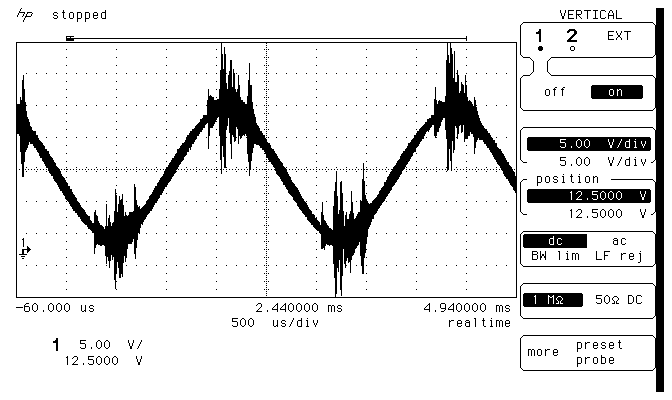

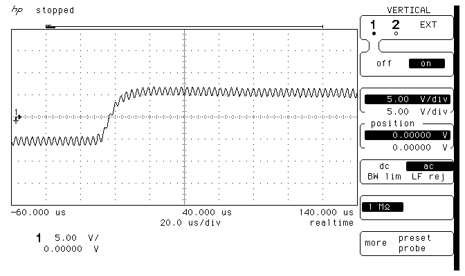

Attachment 1 is a sinewave driven into 8 ohms dummy load showing oscillation of the Class-D negative feedback loop, and Attachment 2 shows how it gets worse as the amplifier is driven more towards its rated power. The square wave response is in Attachment 3. Dismal indeed.

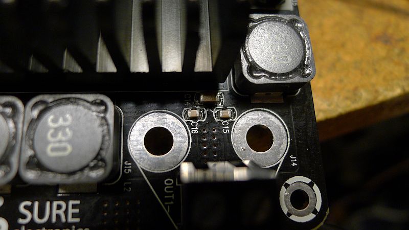

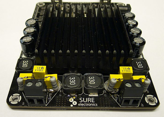

After disassembling the capacitors C14, C15 and C16, which can be fairly easily accessed (see attachments 4 and 5) I found that a 1.0uF was used for C14 and 0.1 for C15 and C16. Since SURE used a 33uH inductor rather than the 22uH suggested for the TDA7498, the output cap, C14, should have been even smaller than the suggested 470nF at 8ohm, or 680nf at 6 ohm. In my case, that means around 470nf for 6 ohms. I didn't have any 470nf surface mount caps which would handle 50V, so I used two 220nf in parallel (by the way SURE, what is the voltage rating on the capacitors you are using?). I used two 100nF in parallel to get to 200nF (approx) in the C15 and C16 positions. I used poly 220nF and a 10ohm 2 watt resistor for the Zobel damping circuits. The fixed assembly can be seen in Attachment 6.

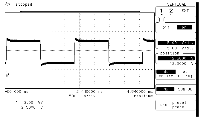

Now the amp is working well. Attachment 7 shows the new 440Hz square wave response with a 12 ohm load (a light loading, worst case) and Attachment 8 shows the square wave into 6 ohms. The sine wave output is now stable, of course. There is some fuzzyness on the peaks, somewhat similar to that in the Tripath Class-D drivers, but a little different. It doesn't affect the distortion or sound, however.
The photos only show 1 channel. The second channels has to be changed in the same way as the first.

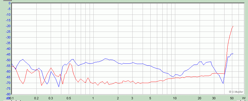

I have retested this amplifier board I received from SURE Electronics which was labelled as: "2 X 25Watt Class D Audio Amplifier Board - TDA7492" and which came with a chip whose top was laser-embossed as 'TDA7498'.
This amplifier seems to be using a chip which does not conform to the distortion specifications in the data sheet for either TDA7492 or the newer TDA7498. My best guess is that the CPU with the board is a "seconds" chip, which, eg, 'fell off the back of a truck'. I have tested the TDA7920B chips from ST microelectronics, which largely perform to their data sheet. But the SURE amplifier has harmonic distortion which is unacceptable, and way above the ST data sheet values of either chip. I cannot believe that SURE could mess up their implementation so completely, although that was my first reaction, and have come to conclude it must be a second-rate chip.
Please find the arguments in support of my conclusion in the other thread at post: http://www.diyaudio.com/forums/clas...diy-t2-ljm-l20d-sure-tda7498.html#post2673643

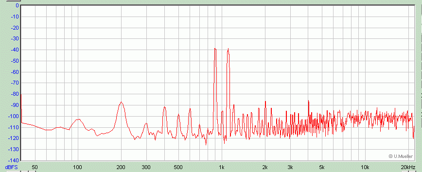

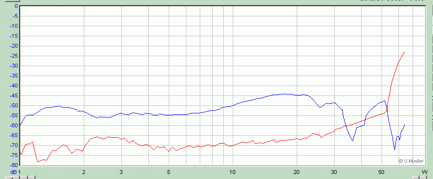

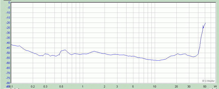

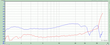

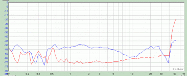

So here are the final test results for the TDA7498L. First, I have attached a photo of the power chip on the board showing the additional components I added (white arrows). It is always amazing to me that this tiny, tiny, chip can put out so much power, with not too bad a fidelity...
Then is the curve of harmonic distortion vs power level at 32 volts supply into an 8 ohm load. Apart from its remarkable irregularity (lack of smoothness) the data sheet shows that the distortion I am measuring is 5-10 times what I should be getting.
The distortion levels of 0.5% to 1% are significant, as the best loudspeakers are in the region of 0.1% to 1%, and an amp should be able to do much better than that, so that the amp doesn't become an audible factor.
I then ran the curves for just the second and third-order harmonic distortions, and it is evident that 2nd-order distortion is dominant. Many people say that the 'warm' sound of tubes is partly due to the generation of even, rather than odd-order, distortions, and maybe a similar reason accounts for why this amp doesn't sound all that bad when you don't listen too closely... The even order curve is in blue.
Next is Intermodulation Distortion (IM) at 1KHz and 1 Watt (8ohm, 32V supply). I have certainly seen much worse IM than this, and I have of course seen much better It is interesting that the 6KHz IM (not shown) test gives about the same value as the 1KHz IM.
Where the amplifier primarily fails is at distortion higher frequencies. Some would argue you can't hear the second and third harmonics of 6KHz, and I am not going to buy into arguing that point here. I do note that the IM distortion does not rise with frequency, which is a mitigating factor for the harmonic distortion. The final curve is distortion vs frequency under conditions as nearly the same as I could get to the data sheet curve - 1W into 8 ohm, 32V, 39K, etc. Yet the measured curve is >10dB higher than the data sheet values...
So there is is. The TDA7498L chip data sheet shows that this out to be a much better amp than I could replicate, at least using the SURE board. As long as you don't try to run it near full power it works reasonably well, but it is not 'audiophile' quality... and please don't expect it to sound nearly as good if you stress it towards the advertised 100W output levels.

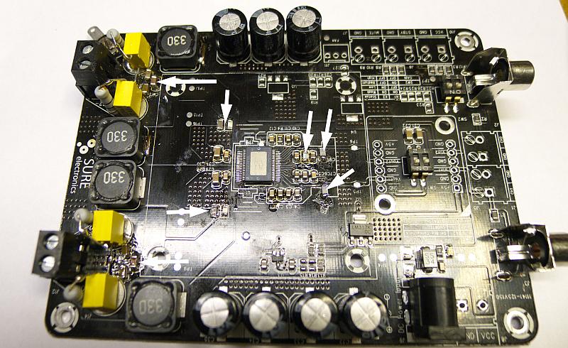

I was surprised that after I had tweaked the TDA7498 board, changing the CPU and the other components, it sounds a lot better than when it arrived from the factory. Back then, I took away the MiniDSP 9Khz +2dB preemphasis, as the original board was 'quite bright' (because of the high level of HF distortion, I guess) but I put it back after the board had been 'brought up to spec' by my changes. I shouldn't have been surprised, but I was. Psycho-acoustics never cease to amaze me...

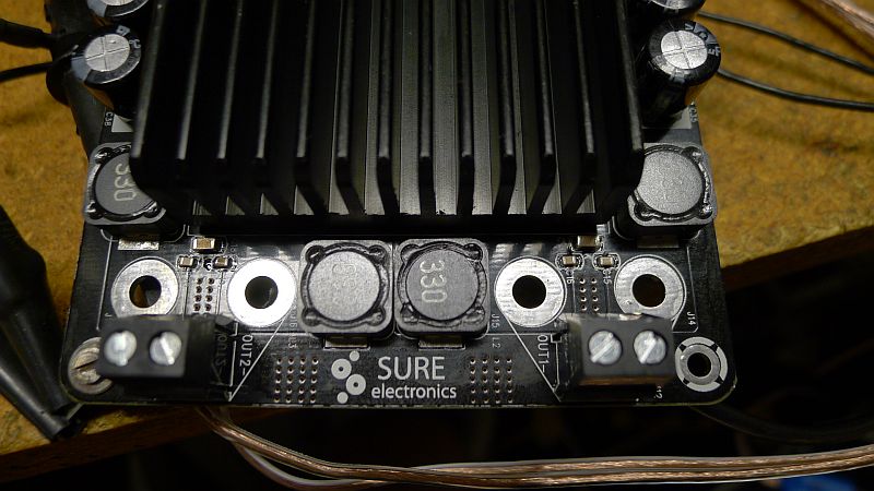

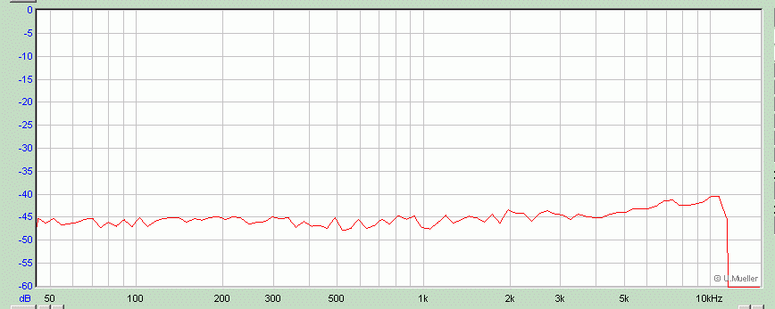

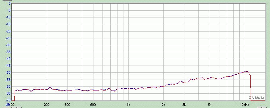

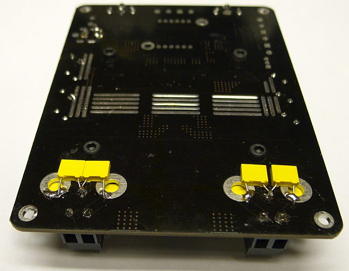

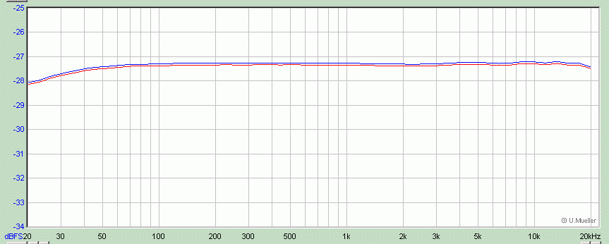

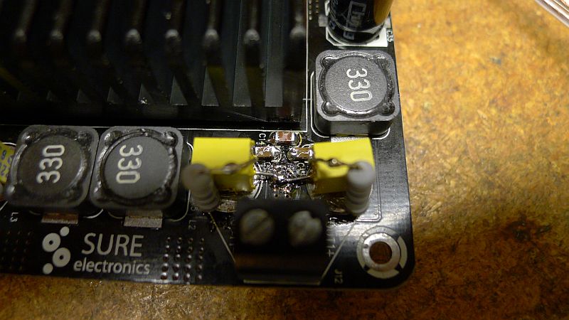

I am gradually getting some decent performance from the TDA7948L I put on the SURE board. The original chip on it was probably OK too, but I know the new one is from a full-spec source.
When SURE designed this new board they decided to use surface mount capacitors as much as they could. In particular, the capacitors in the output network were X7R ceramic. When I changed them to Metal Film I finally started to get some half-decent performance out of this chip.
Attachments 1 and 2 are the photos of the board top and bottom, showing how I fitted the film caps onto it. I designed the new output filter to be critically damped at 8 ohms, which indeed it turned out to be. The main filter caps, C18 and C14 on Sure's AA-AB32189_Ver1.0 schematic, are 330nF film. The four caps C15, C16, C19 and C20 are 100nF and the four snubber caps I added are 220nF in series with 10ohm 2W resistors. The 100nF caps are soldered on the rear of the board.
I compromized between having a high attenuation of the Class D switching frequency and having a good clean audio response. You will see significant high frequency signal on the output, but it is not nearly enough to zap a tweeter.

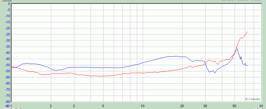

The 1KHz square wave responses with 6 ohm and 12 ohm load are shown in the scope photos of attachments 3 and 4. One is underdamped, one is overdamped, as the design point is critical damping with an 8 ohm load. Attachment 5 is the frequency response with an 8 ohm load, showing a correct, critically damped, frequency response in the 10KHz-20 KHz region.

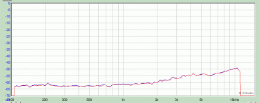

Attachment 6 is the THD vs Frequency curve that used to be so bad. The distortion is now acceptable, staying below 1% even at the highest frequencies.
To double-check this I took the distortion vs power curves at two different frequencies, 1KHz and 6KHz, just to make sure that the HF anomalies are now under control. The curves are in attachments 7 and 8. I used a 6 ohm load, the maximum rated load on this amplifier (although mine does drive 4 resistive-ohms quite happily). Note that I have spilt out the even order harmonic distortion components in blue, and the odd-order in red, as is my habit when trying to match up how an amp sounds, versus how it measures
So there we have it.
