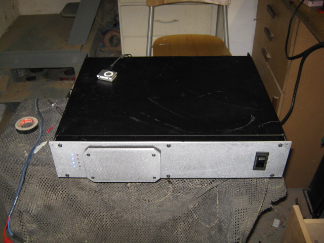

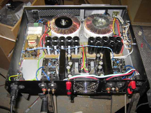

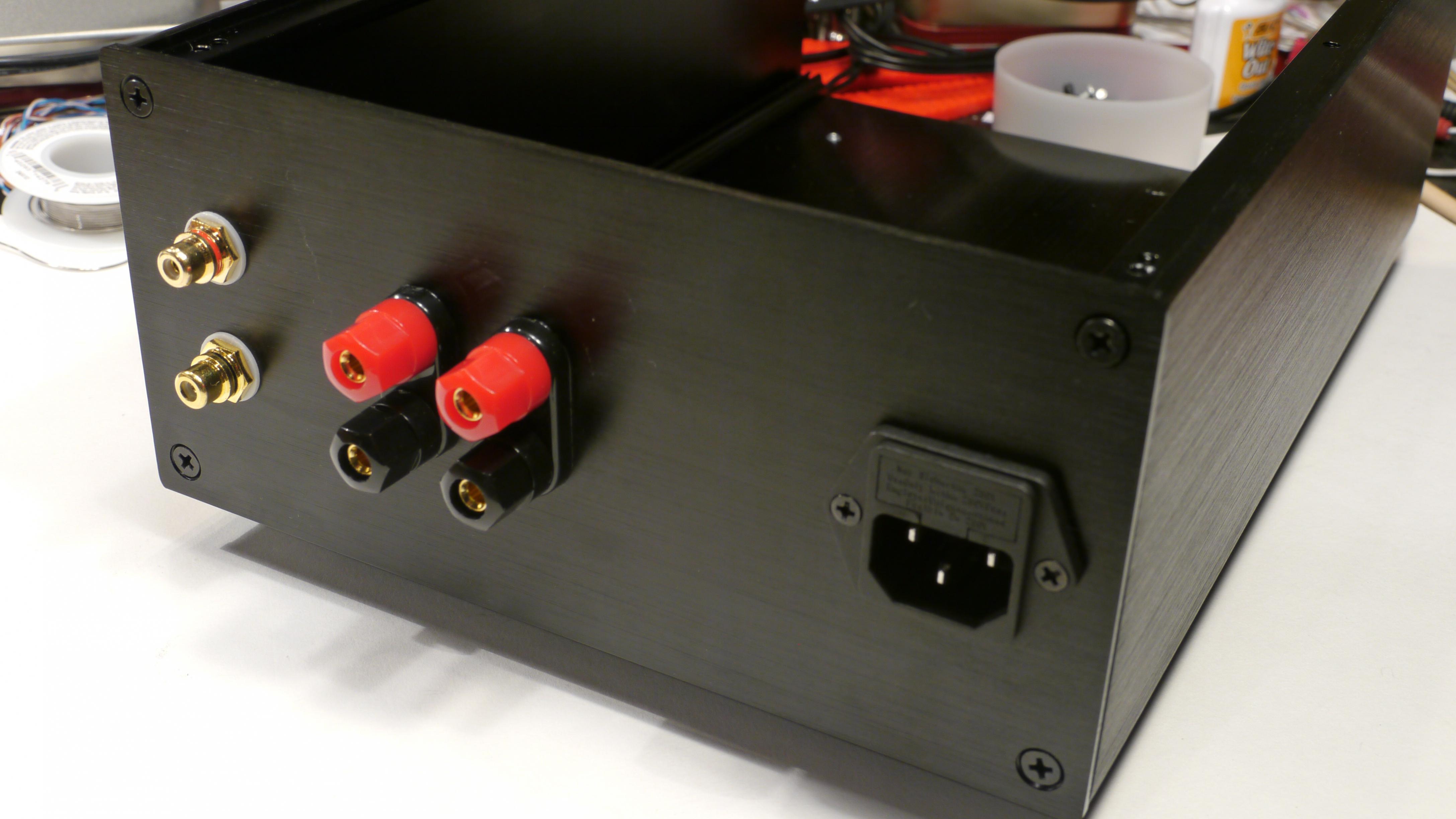

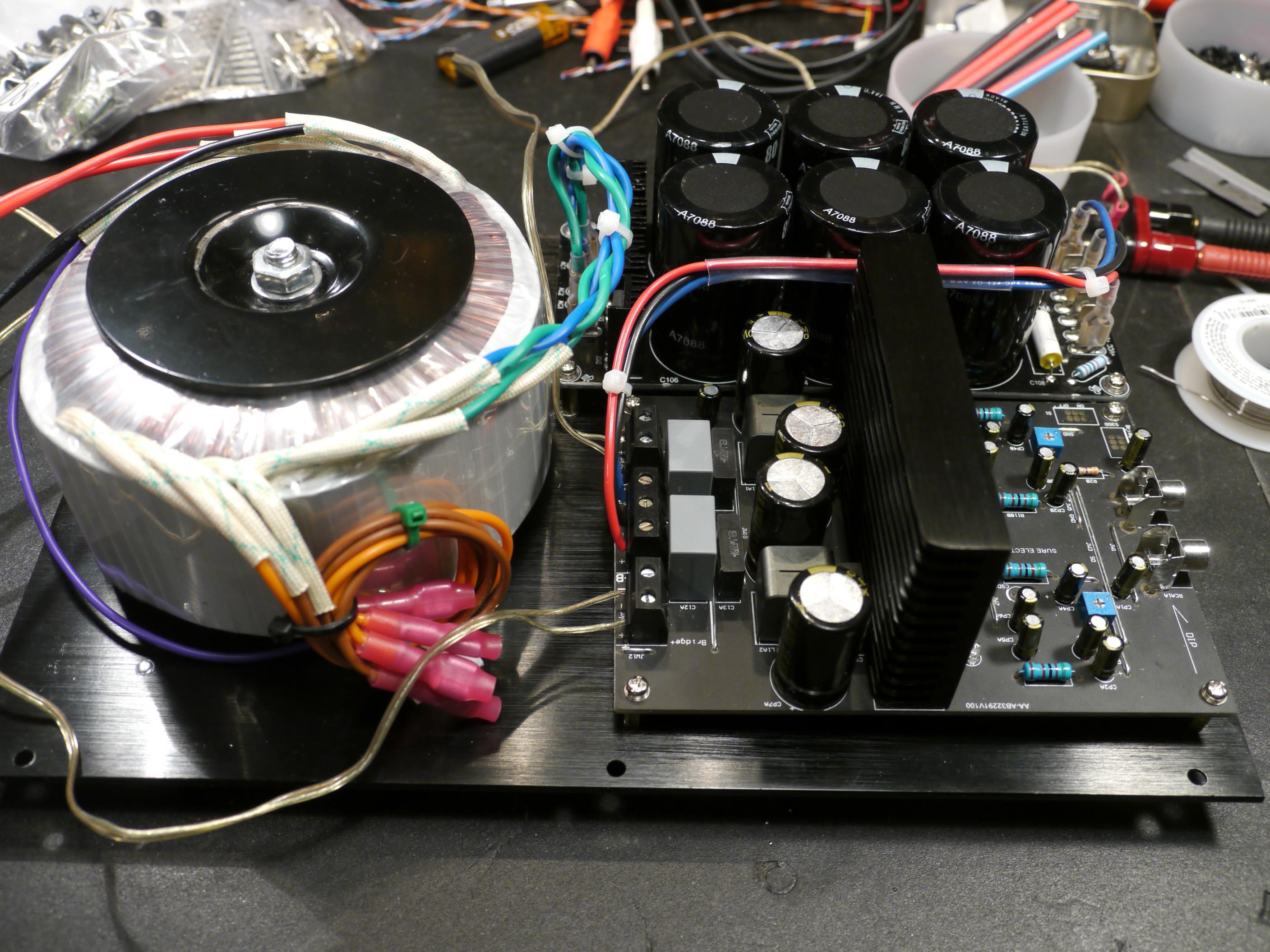

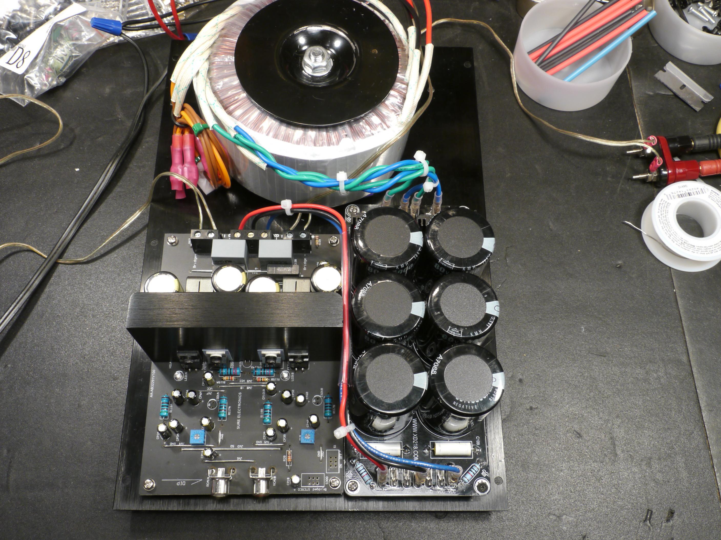

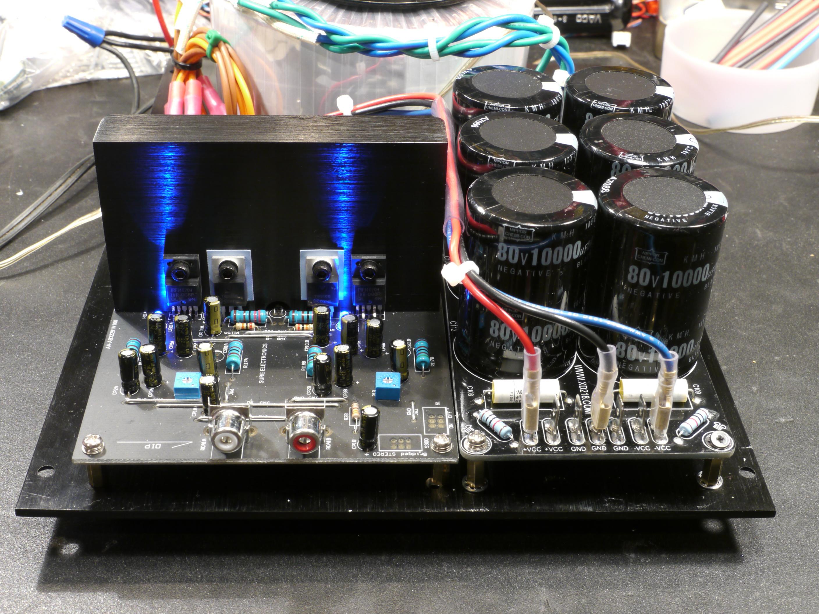

This is my first fore into building a Class D amp. I selected ready-made modules for the PSU and amp. I also selected this enclosure to house everything. It will be powered by a +-65VDC linear power supply. The enclosure is turning out to be a little snug, but using a linear PSU means a big fat torodial has to fit somewhere. :p I've powered it up and did not get any of the 'magic' smoke. I measured the DC-offset and got -.7mv on the left and -1.9mv on the right. Here are a few pictures of my progress.

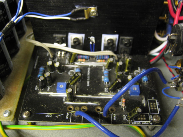

Neat work. I'm just finishing up my implementation of the same board, but I'm using four channels and two PSUs. One thing I did note is that the overtemp sensor isn't really connected to the heatsink, so I drilled a snug fitting hole further up the heatsink and extended it to fit. It does run slightly warmer than I was expecting, but I suspect that's down to the TIP31s.

What's that sensor under the little brass bracket further up on the HS? Is that another one you moved? With 4-channels yours is a beast for sure. :p

That's a sensor for the fan speed controller. This amp may occasionally get pushed, and the heatsink is no way big enough for that without help.
I've also added the missing bridging op-amp and bits, and cut some traces so one side is permanently inverting to avoid bus-pumping. I also cut holes for and mounted XLRs, but haven't fitted the balanced input circuits yet.
I had it playing a CD tonight on my bench and within about 30 minutes the HS was very hot to the touch. I was surprised since I was playing at a very low to medium volume level. :confused: Is it due to the fact that this HS is underrated for a typical operating environment? Odd. I know this is rated at 250wpc, so maybe I should be playing it louder! :p

Here's my first guess:
Amp is rated for 8 ohms only. Were your speakers an 8 ohm nominal load?
Next culprit:
You might also want to measure the DC rails to see what you are actually pushing the amps with... the higher the rail voltage, the more dissipation might be taking place.
Finally:
You could have a high frequency (supersonic) oscillation causing the amps to heat up. You would need a scope to find that.
-Charlie

Yes, 8 ohm load and 64v rails. Don't have a suitable scope though. :( I'm curious if this temp is standard operating spec. Mine will be in a vented enclosure, so maybe I have nothing to worry about, and then maybe something else is going on that needs attention.

With the heat sink finning horizontal, natural convection is largely ineffective.
A small fan blowing along the fin direction would do the trick.
