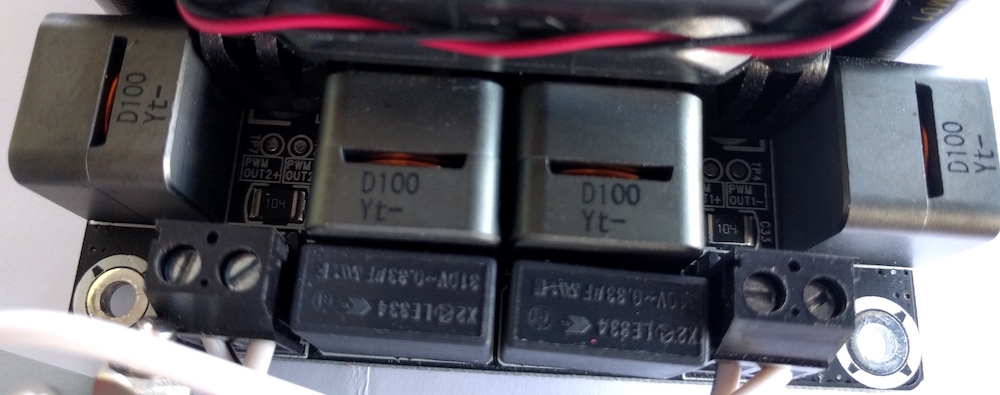

Bought a Wondom Tamp2400 mkii Gremlin from Germany and Hobbyhifiladen. Wondom is apparently the new name for Sure Elecronics consumer division.
As far as I can tell it is the same as an upgraded AA-AB32313, the coils are bigger.
Problem is, I can't find this exact model in Sure's homepage. Anyone has more info on this?

Model number is WONDOM AB23251V120. Output filter look like picture below.
attachment.php
