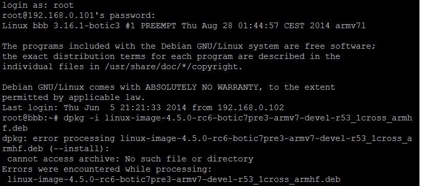

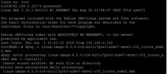

yanpetr, it seems that you are executing the command in the wrong directory.
If it is in the root, then try to change current directory first. I.e. use the following command:
But ... it depends where is your root directory of SD card mounted.
try also the one of the following:
or
cd /
dpkg -i ...
cd /boot
dpkg -i ...
or
cd /boot/uboot
dpkg -i ...
or
Meero, thank you, Yes that was my mistake.
Now I tried three directories,the installation is successful, after the sync command is on the screen there are no errors, reboot,
but when you check with the command uname -r says the old version 3.16.1-botic3
