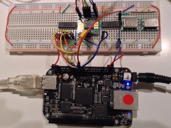

Shown below is an example of experimental Botic system with external clocks (and with an isolator), that was best refined as Hermes and Cronus boards by TPA nearly a year ago.
O.K. I will buy an 22.579 clock to make it happen.
I will only use the external clock for 44.1 (and 88.2) and use the onboard 24.576 for 48k and up.
My "wooden" breadbord with my other BBB looks like this with the Tentlabs between the 2 power supply boards. As you can see the external clock is not connected to the BBB yet.
I am still learning and getting closer to get it working but I am still struggling for many days now to nail it.
My setup will be to use an external clock for 44.1k only (ext_masterclk=1) but for testing I am using only the onboard clock (ext_masterclk=0) before I will implement the extra clock.
The behavior you describe is what happens when my BBB is powered but the DACs and clocks are not powered. Because your hardware is different, it is very difficult to troubleshoot by speculation. My only suggestion is to double-check that all of your GPIO connections are correct and, if possible, confirm their output with a fast scope.
Debug info can be hard to come by. The command 'aplay' has a good amount of debug information if you use the -v flag (verbose). I suggest moving one music file to your local memory and try to play it with, for example:
Code:
aplay -c 2 -v -D hw:0,0 /pathto/somefilename.wav
Don't get mislead by the picture or previous info.
The picture is of my other BBB which serves me fine in the meantime with I2S direct without the botic driver.
So I have all the time to play around with the second BBB but have to admit playing around too long is no fun anymore ;-)
I started again from scratch and only need to confirm for myself that the Botic driver works although at first with the onboard clock only before I step up to include the external clock for 44.1k (I have the 22.579 clock availale now).
I am not using Volumio / Squeezelte or any other additional modules besides plain MPD.
Later today I will try to play a local file with debugging as suggested.
One question ... Is the single line what I posted for /boot/uboot/uEnv.txt all there should be ? With the different configurations whih I tried until now the file uEnv.txt was always empty so I have to put the correct info in there myself.
I am not sure if it is supposed to be empty when setting up with Botic distro or driver.

Guys,
I am just starting on this...and need your help:
- First of all, I bought a Beaglebone GREEN. This is the one WITHOUT HDMI. So: Will this Output I2S or is only the black Version capable of doing so ?
- I have downloaded Botic 4 from the Webpage, wrote it to SD, boot with "User/Boot"-buttom pressed.
- I do not have anything connected to the BBB, it is just the standalone board attached over USB to Putty.
When I am booting WITHOUT the SDcard: I can connect with Putty at 192.168.7.2. No issue. When I boot with/from SDcard: No Connection possible anymore.
So, I am not clear what booting from the SCcard should accomplish: Is this a Kind of Live-USB-Boot, so the whole System Comes from the Card, or will it install just some Drivers / Settings onto the internal eMMC and Need only once applied ? Or is the GREEN-Version the issue ?
THX for your support

I suggest using the ethernet connection. Then login directly from a terminal as root - like 'ssh root@xxx.xxx.xxx.xxx'. Password is 'botic'. You can find the BBB's IP with a network scanning program (like 'Fing' for smartphones), or perhaps from the terminal by executing 'arp -a'.
That gave me the connectivity, thanks a lot !
How do I know now if the Green Boar Supports I2S ? I am a bit concerned as I2S was part of the communication with the HDMI-chip, which is no longer present....
I haven't read of any others who have used it, so you may be exploring uncharted territory. I imagine all will work fine...
Debug info can be hard to come by. The command 'aplay' has a good amount of debug information if you use the -v flag (verbose). I suggest moving one music file to your local memory and try to play it with, for example:Good luck!Code:aplay -c 2 -v -D hw:0,0 /pathto/somefilename.wav
This is what I get playing a song:
root@botic:~# aplay -c 2 -v -D hw:0,0 /mnt/music/GetHere.wav
Playing WAVE '/mnt/music/GetHere.wav' : Signed 16 bit Little Endian, Rate 44100 Hz, Stereo

aplay: pcm_write:1939: write error: Input/output error
But I have no idea what I should be looking for ... besides that it gives an error in the last line.
If your DAC is not powered and connected, do it now and try again.
SOLVED !! ... but there must still be a driver / software bug
As I wanted to test it first with minimal components before I put all extra bells and whistles on it I deliberately set "optargs=fixrtc snd_soc_botic.ext_masterclk=0 snd_soc_botic.serconfig=I--- snd_soc_botic.dai_format=16385" in /boot/uboot/uEnv.txt to use the internal clock only.
But I had to connect my 22,579 clock anway at input 25 before I could play the song without error.
Now I can play my complete library via the iPad without any issues too
Why is the clock setting=0 not working properly ?
The typical thing is that in "/sys/module/snd_soc_botic/parameters/" the value for ext_masterclk stay at value 3.
Is this a software bug ?
Even if I try to edit this value mayself to change from 3 to 0 as I tried in the beginning I get a "PERMISSION DENIED" so could this preventing Botic from the ability to change the value internally ?
I could edit serconfig from MMM to I--- without problems but did I have to edit this at all ??
What is the exact relation between uEnv.txt and /sys/module/snd_soc_botic/parameters/ ??
Maybe Miero knows ??
