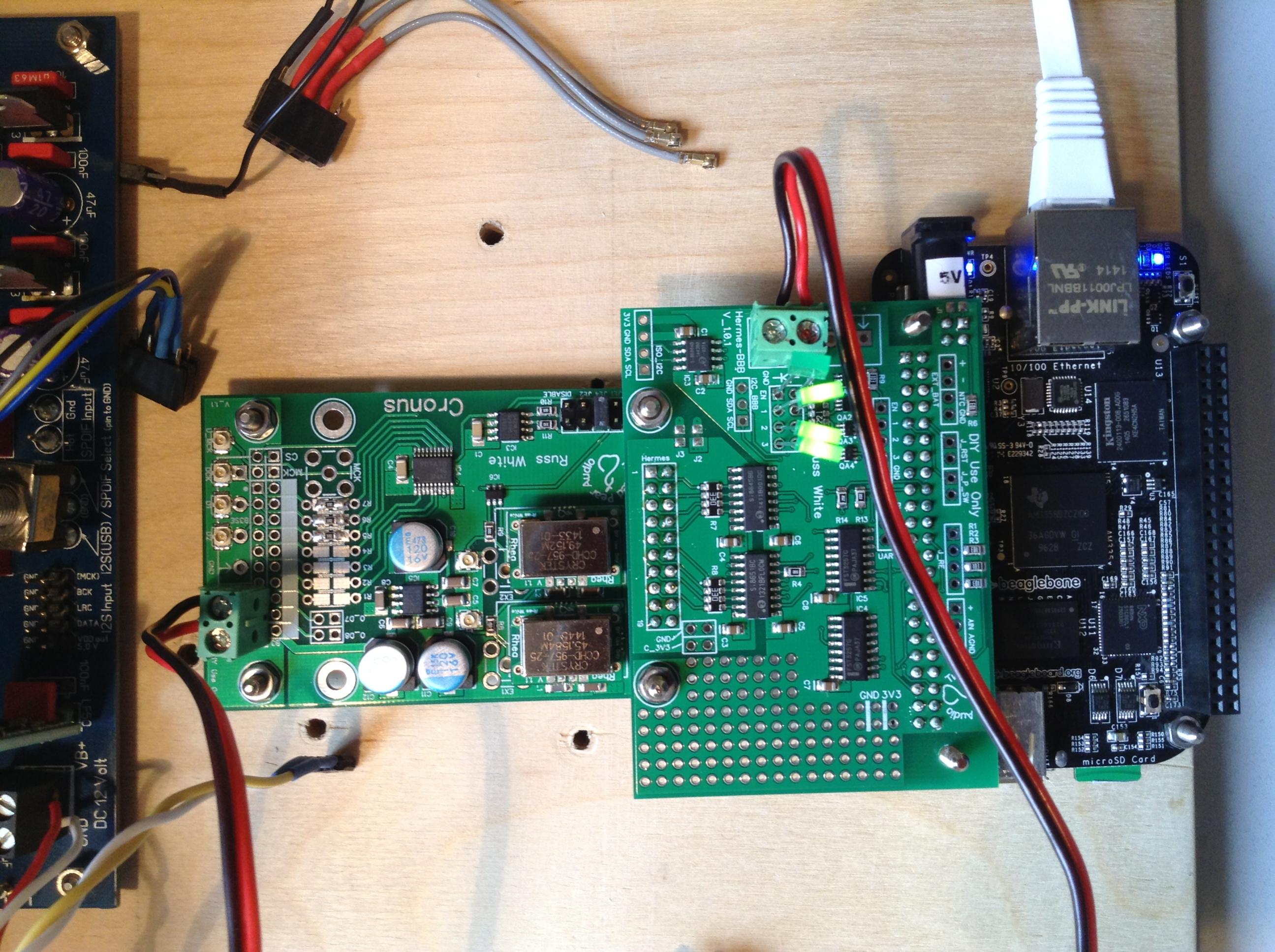

Hi Miero,
I have build the Cronus/Hermes, plugged into the BBB and flashed your botic to a card.
I have been able to connect to a remote directory using SSH into the BBB. Ympd is running fine but no music output yet.
So far so good for a Linux Noob
Now I am reading your configuration notes and it seems that I need to make some configurations before I am able to get it to play music.
Do I need to configure the external clocks? I have 45mhz on ex1 and 49mhz on ex2 on Cronus board.
I want to connect to a dddac1794. Do I need to configure the channels in SW?
Is there no software volume control?

Use the 1:2 jumper for hermes BBB then the BBB will see the default frequencies 22/24Mhz. Follow the guide for setting up for external clock here:

You want 3
http://bbb.ieero.com/
Clocks configuration
Installed clocks are configurable via:
- kernel option snd_soc_botic.ext_masterclk
Examples:
0 ... no external clocks, just onboard for 48k freq (default)
1 ... external clock for 44k1 + onboard for 48k
2 ... external clock for 48k only
3 ... external clocks for 44k1 and 48k (needed for cape)
+4 ... invert polarity of clock selection switch GPIO0_15
9 ... external clock for 44k1 only
You want 3

You have connected ground too?
Cronus => Dddac
Dck => bck
D1 => lrc
D2 => data
Ground => ground
Yes, I just figured that out.
I had my previous streamer powered from the DAC PS so ground was already connected. Now I am powering from separate supply...........
After making some modifications in mpd.conf (thank you Stijn!) I can now connect with an external mpd client and use extended browsing facilities. Also software volume control is enabled (for serious listening always set at 100% but during the day it comes in handy )
A BIG thanks to Miero for putting it all together!
