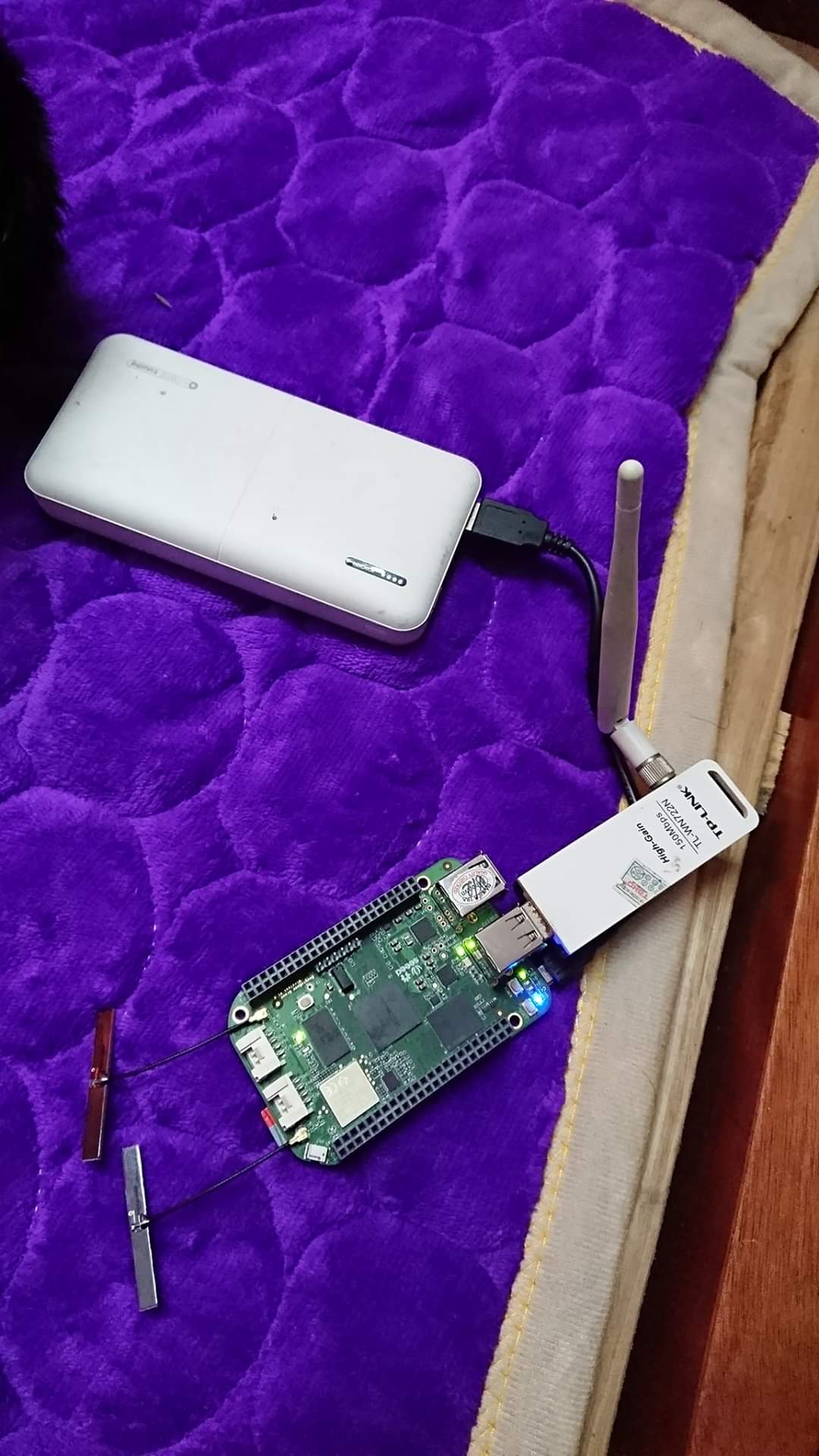

I'm using Beaglebone Green Wifi.
I installation the Debian 10 Buster Console, then patch the Botic 7. But Botic 7 are disable the Wifi Capes of BBGW. I using USB Wifi TP-Link external are normal.
Pls help me the turn on/enable the Wifi Capes on BBGW. Tks all.

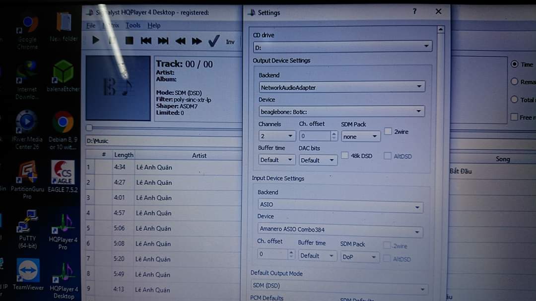

botic7-image_latest.gz https://puredsd.ru/botic7-image_latest.gz are problem with MPD(uPnP) can't selected now. Please repairs it.
Can you have add the Wifi Module for BBBW, BBGW, BBE or USB Wifi!?
You can get acquainted with the beta versions: Botic7 — Yandex.Disk
Description and changelog in Russian. But for the release, I will prepare documentation in English.
Temporarily support for this firmware on the Russian forum:
Сетевой плеер на Beaglebone Black — чистое удовольствие - Цифровые источники - DA Stereo
In the near future I will make partial support for WiFi USB.Can you have add the Wifi Module for BBBW, BBGW, BBE or USB Wifi!?
