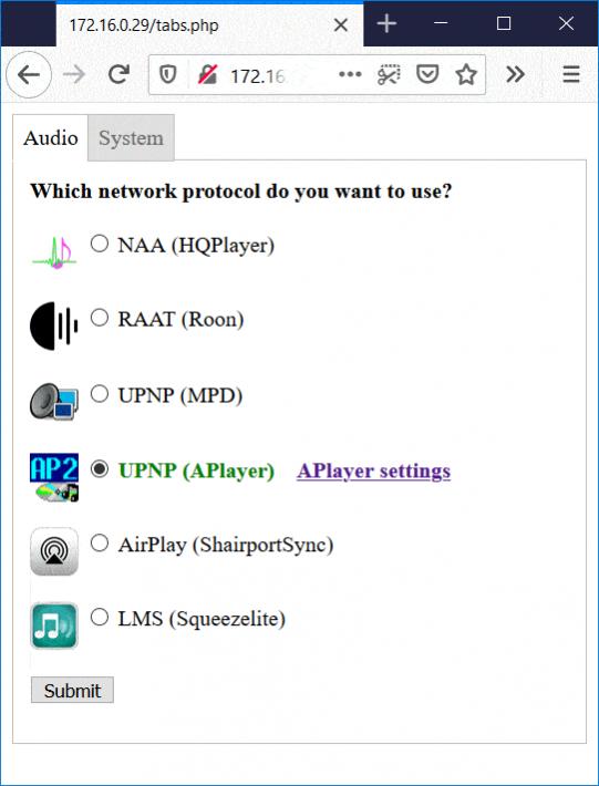

Functionality extension in micro audiorender (beta):
http://puredsd.ru/buildroot/sd_botic7_V2.img.gz
ssh root/root
- New audio renders of the LMS and AirPlay protocols have been added.
- Added support for wpa WFi.
ssh root/root
Linux kernel remains the same - 4.9.146-Botic7-rt
ssh root/root
