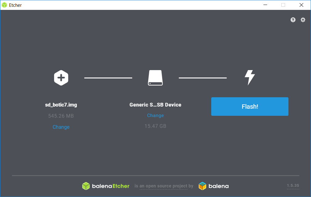

PPY, I tried to install your image on my BB Green, but failed.
- I burned the SD card with etcher, no issues.
- I have the BBG only, so nothing connected to it, no chronus/hermes or anything as I wanted to have the OS first on it.
- plugged a USB cable in from my Laptop to power it
- pressed the User/s2 buttom when powering it on
- the one power led is on, but the traffic lights / four leds stay off, you can wait forever.
- if you release S2, nothing happens
If I do not press S2 when powering on, The normal booting of the BBG happens, so the Laptop recognizes it, after some time you can get on its web interface under 192.168.7.2 as written in the manual.

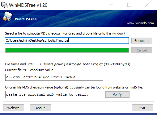

Well...In theory this should be manageable...what is now different between your setup and procedure and mine ?
Do you press s2 on the green as well or do you simply plug the sdcard in ?
checksum is the same.

- Download http://puredsd.ru/buildroot/sd_botic7.img.gz
- Etcher to write this file to SD (the gz archive does not need to be unpacked)
- Install SD to BeagleBone
- Press S2
- Connect power to BeagleBone
- When all four LEDs come on, release S2.
- After a few seconds, Linux will start.
