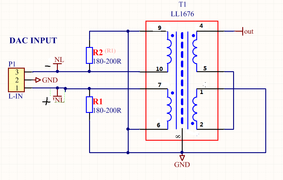

I want to use 1 : 4 transformer LL1674 ( rdc primary = 33 ohm / rdc secondary 605 ohm) to have more gain. Can i use it ?

hi!
you can do that
thank

Hello Guang Hao,
Sorry , but if i understand well, in this case i have a 4 : 1 transformer and not a 1 : 4 transformer for more gain.
I want to use LL1674 or LL1676 (1 : 2) in your dac converter.
LL1684 = 1:1 / Prim dc = 41 ohm/winding / Second dc : 41 ohm
LL1674 = 1:4 / Prim dc = 33 ohm/winding / Second dc : 605 ohm
LL1676 = 1:2 / Prim dc = 145 ohm/winding / Second dc : 605 ohm

Hello Guang Hao,
Today i have only LL1684 and i must buy them.
I must made the right choice before buying them (350$) :confused:

Not only the cost of LL1684. Those 10uf Caps on the board also impact sound. Standard ESA 10uf are so, so. Caps does not have to have such high capacitance. 2,2uf is enough. So you can get 2,2uf of better quality than ESA.
I personally would love to have capacitorless transformer outputstage for sabre.
Something like: Teramoto FINEMET transformer.
