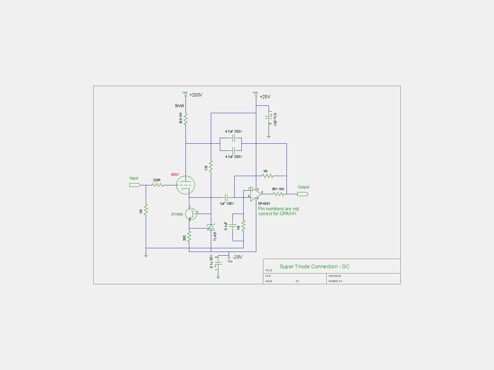

My knowledge of op amps is very basic, so I need a little bit of help in understanding how to adapt FYC’s circuit in post #1 of this thread with the OPA541 in master-slave.
John Broskie is very fond of the OPA541, especially in master-slave arrangement. He likes the doubling of current and the reduction of distortion by 20db. (Power Boosters)
Mr. Broskie mentions that he uses 1M resistors for the Super Triode OPA541 - feedback and + to ground to keep the dc offset “extra low”. I’ve never seen an op amp used in unity gain arranged in this manner.
Does anyone know a resource (webpage or section of a book) that can help me directly understand this use of an op amp to help me figure out adapting these circuits?
Is there a simple way to adapt the OPA541 in master-slave to FYC’s Super Triode circuit?
I've included images of both circuits.
Thank you very much - ziffel
PRR
Joined 2003
...Mr. Broskie mentions that he uses 1M resistors for the Super Triode OPA541 - feedback and + to ground to keep the dc offset “extra low”. I’ve never seen an op amp used in unity gain arranged in this manner. ...
I've seen it far too often. Maybe you are younger.
Opamp inputs suck current. Assume 1uA. We need 1Meg on one input so an appropriate servo cap can be film not electrolytic. 1uA in 1Meg is 1 Volt. If we only do that on one input, then there will be 1V offset. :(
Is 1uA reasonable? No, but '5532 can suck over 200nA, 0.2uA, 0.2V in 1Meg, so not too far off.
FET input amps, even the humble TL072, can run 1Meg with low error. (However the baked-in offset may be several mV.)
Thank you, PRR.
I'm used to simple inverting op amp circuits, with input and feedback resistors (see image).
With the circuit Mr. Broskie used, would I use NO resistor for unity gain? This is where I get confused.
I assume I would use a 100k input resistor with the 1M feedback resistor to obtain 10x gain. Is this correct?
