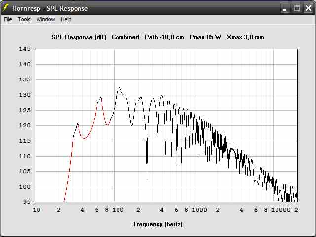

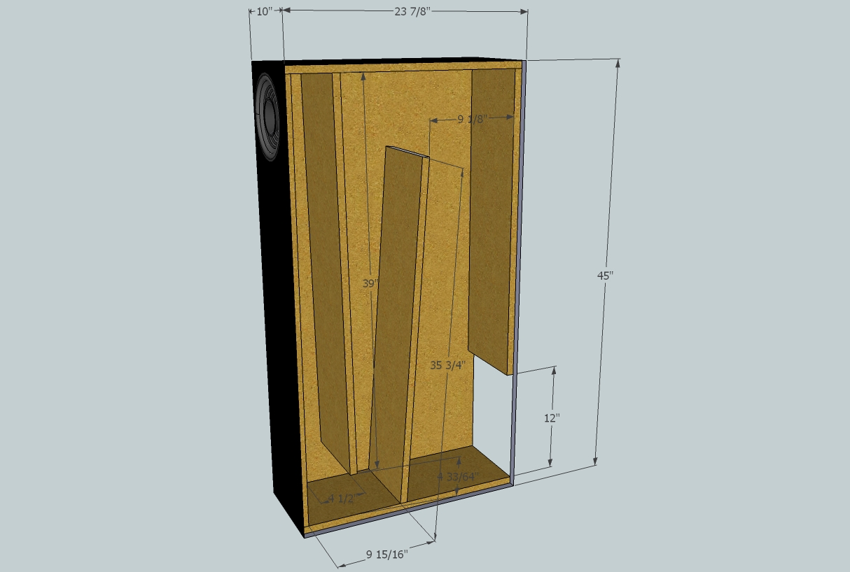

Super simple RLH for 8" GRS
I guess I didn't even know Nelson Pass designed speakers. I also tried modeling this driver in a ported enclosure and the horn plays much louder. Didn't try a sealed enclosure but then I've never really liked them. I guess what I'm most curious about is the mid and high frequencies of this driver as I haven't ordered any yet (I don't even have the $25 for a pair at the moment.)
Well I think the Pioneers are discontinued, which is why the GRS were introduced. I wish they would come up with a replacement for the 4" pioneer that was discontinued last year, as it seemed to perform on par with the Fostex FE126E in most aplications (in theory I never actually tried the pioneers). I will buy a pair of the GRSs and probably the Pioneers too if I can find them it's just not going to be in the next couple of weeks. I've already experimented with the Fostexes.
