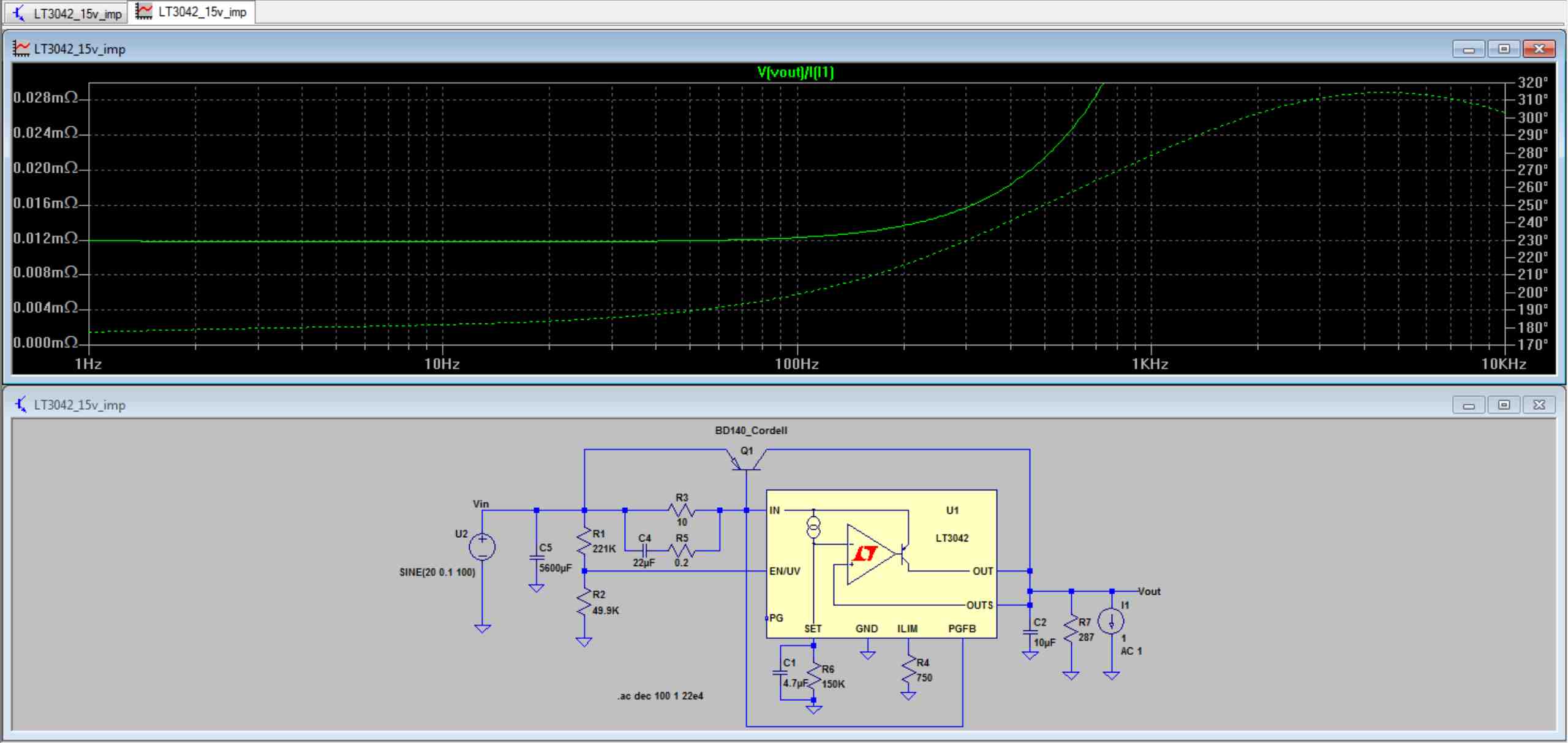

ldo regulators have great noise and psrr performance. Only issue is high Zout compared with discrete regulators. after ldo is there any buffer circuit possible to decrease Zout?
Output impedance of LT3045 to 0,17mOhm @ 80Hz and 0,25mOhm @ 700Hz.
Simulation for LT3042, supposedly a bit inferior to LT3045, shows 12uOhm @ 80Hz and 29uOhm @ 700Hz.

That's because you have a heavy load on the regulator and pass transistor.
The convention is to use a 25mA load ... this keeps everyone on the same page when testing regulators for stability. (If I were to go back and retest all the regulators for the Linear Audio article I would use 25mA and run the Z-test out to a few megaHertz - )
Set I_1 to AC=1, DC=0.025 and eliminate R7, or AC=1, DC=unspecified, R7=600 Ohms.
D45H11 is in the LTSpice library isn't it? BD140 isn't a good choice as hfe is lower and safe operating area smaller.

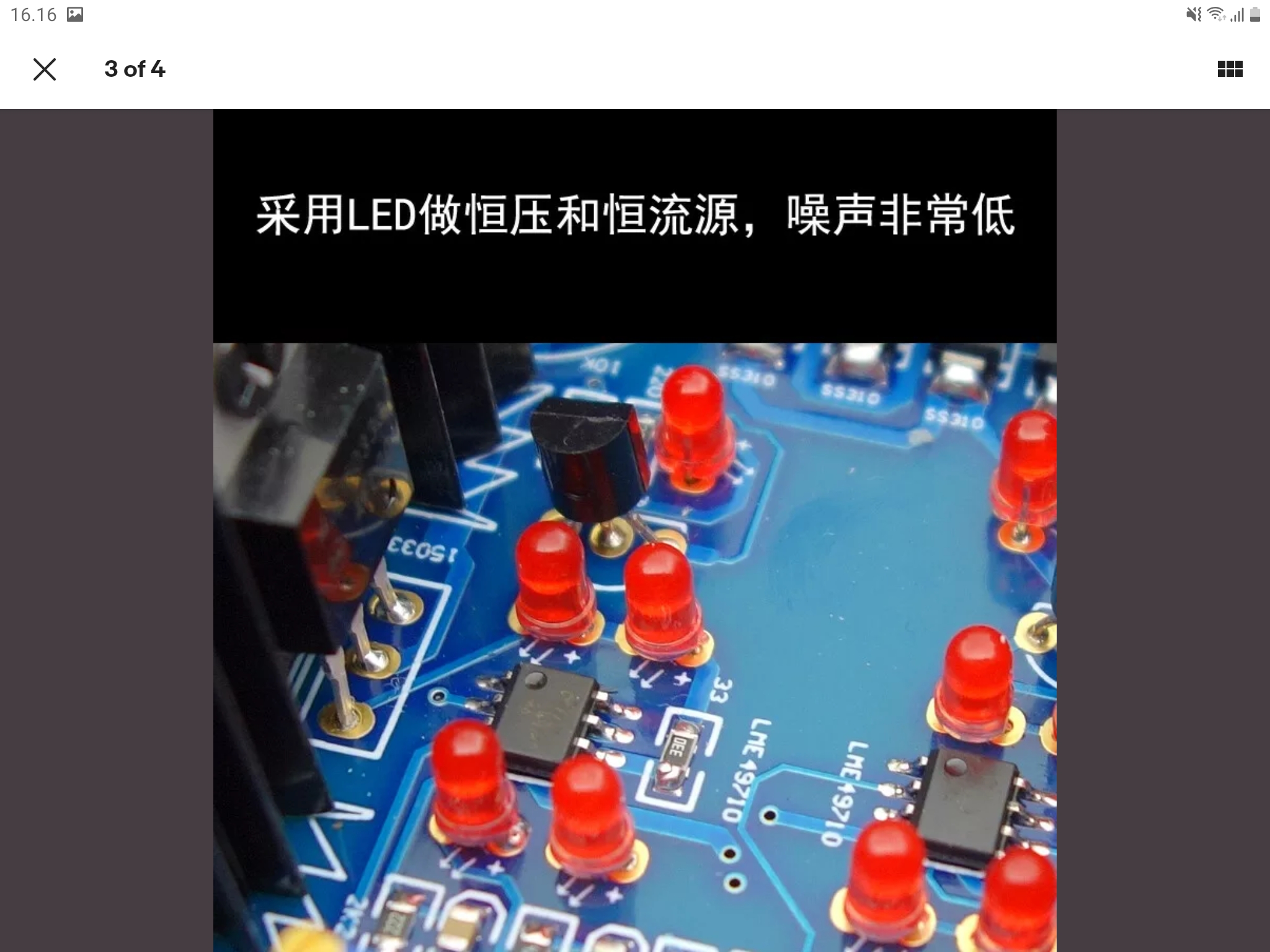

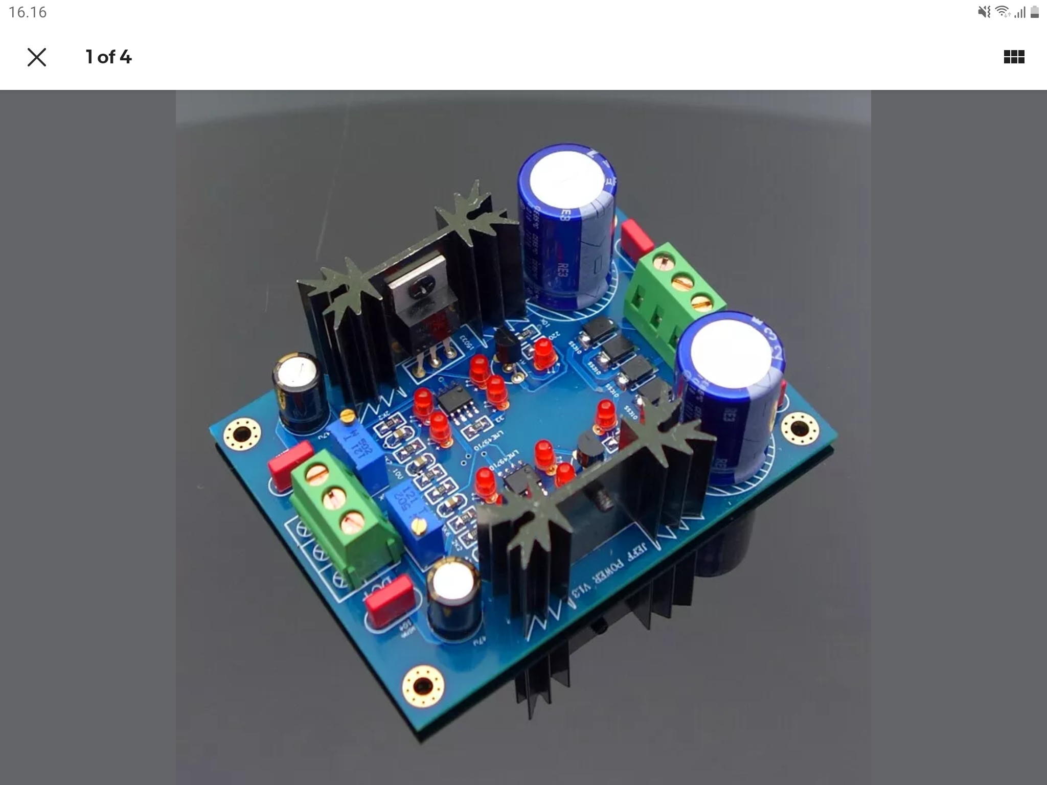

"Jung super regulator "
Hi all.
Surfed a bit around on fleebay and noticed this regulator, it uses lme49710 opamp, and I guess all those led's are current sources.
There's literally no specs on this thing which makes me suspicious.
Has anyone here tried one and maybe measured it? And the topology? I don't recognize any jung here.
