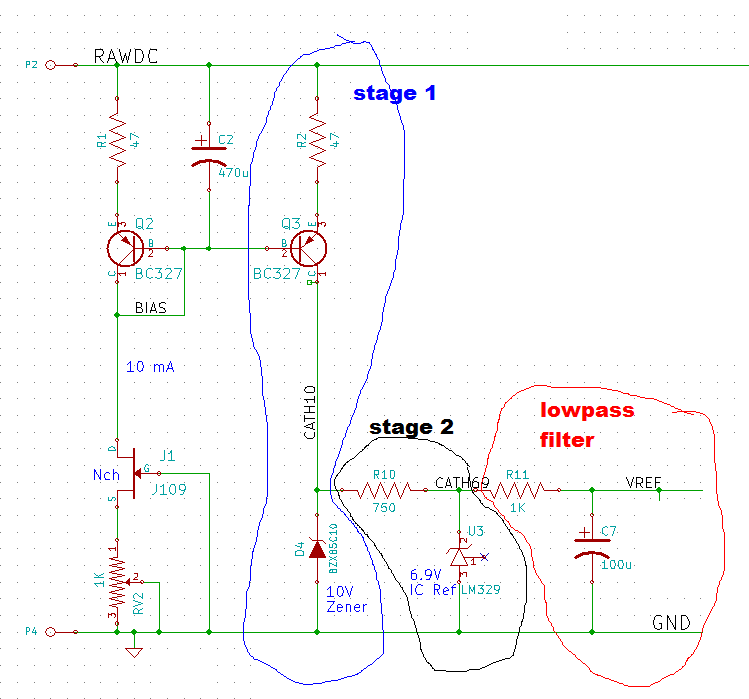

I'll send you one in the mail if you promise to measure it side-by-side with a Super Regulator and report the measured bandwidths. Schematic here. I think D4 and R10 might be somewhat novel; they increase the PSRR of the reference voltage by an additional 1000X at the mains frequency, yet the extra cost of those two components is quite low. Replacing R10 by a JFET or an LM334 might get another factor of 10-30X.
D4+R10 have been around for as long as I have been able to read regulator schematics, more than a couple of decades.

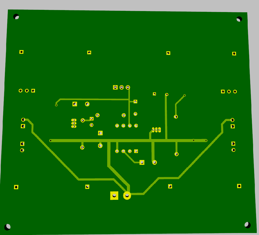

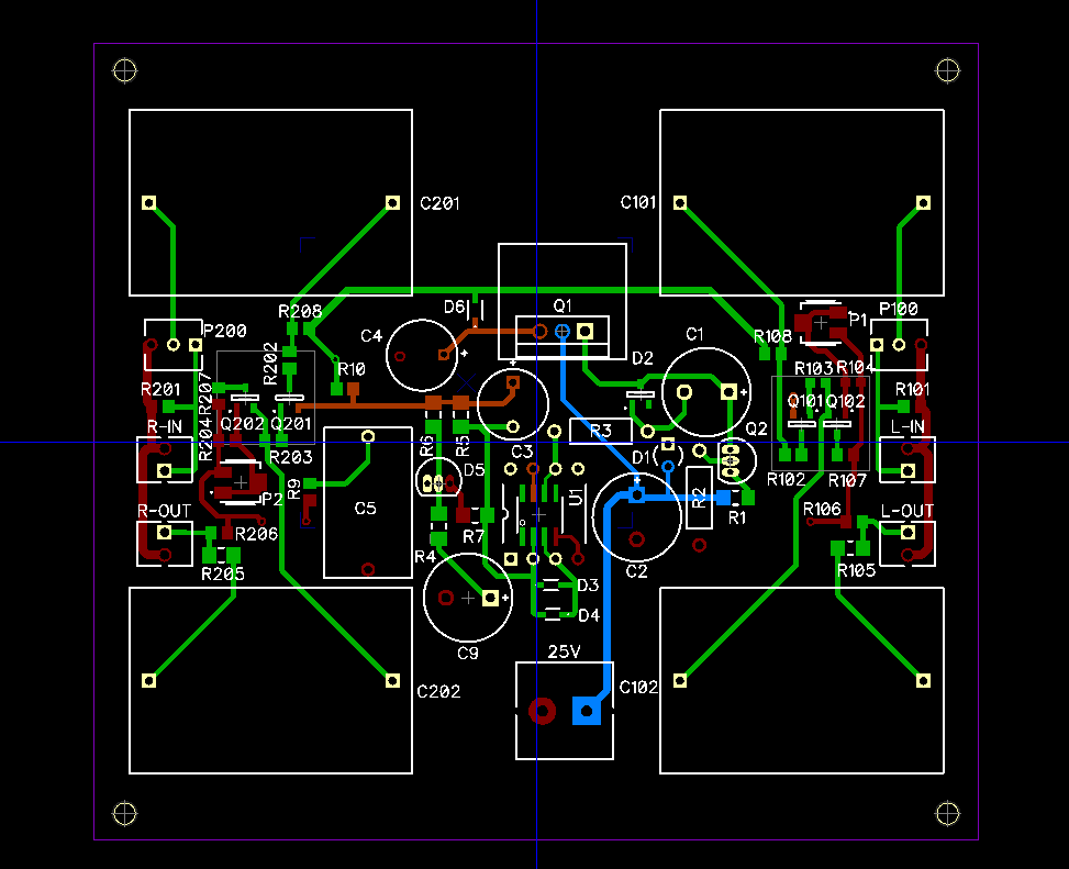

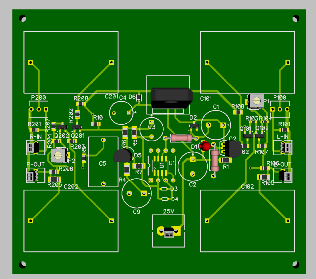

Jan ,made some changes after discussing B1 at passlab thread. Added SOIC option. Please take a look and see if there any glaring issues.
I might make a few changes, nothing critical, except one I recommend. Place the pass transistor symmetrical between the caps. That gives the best distance to either cap for heat and leaves the max space for a heatsink.
You are mistaken. What is shown is a two stage shunt regulator. The first stage consists of a current source and zener diode, having a line rejection @ DC of about 80 dB. The second stage consists of a resistor and LM329 precision reference IC, which adds another 60dB of line rejection @ DC. I very much doubt that you can exhibit a >20 year old schematic containing a cascade of two shunt regulation zener_diodes/ICs, in which the first shunt regulator is biased by a current source and the second is biased by a resistor.
