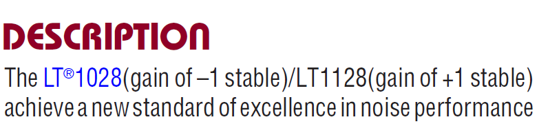

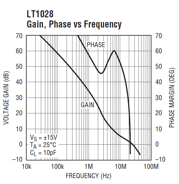

The first sentence in the datasheet "Description" is weasel-ey. They are trying to tell you NOT to use the LT1028 in noninverting amplifiers with low gain; sadly the Jung/Didden Super Regulator is a noninverting amplifier with low gain. Linear Technology are trying to tell you to select the LT1128 instead; it is stable at gain=+1. But they don't want to print the word "unstable" on the datasheet, so the weasel phraseologists come to the rescue.I couldn't get the LT1028 to operate properly with the SR. Mbe it's just me.
If you want to experiment with this opamp family in the Super Reg, I suggest either
- Use the LT1128, or
- Change the VREF diode to a 1.2V shunt reference IC like the LM285-1.2, which forces you to run the opamp + feedback network at much higher gain, which gives you plenty of phase margin even with the LT1028, or
- Connect a 220 pF capacitor from pin 5 to pin 6, as per the "Over Compensation" figure in the datasheet,
- or a combination of the above
I couldn't even get the SR to "start" with the LT1028.
As they say, and as you aptly point out: "Read the prospectus carefully before you invest..."

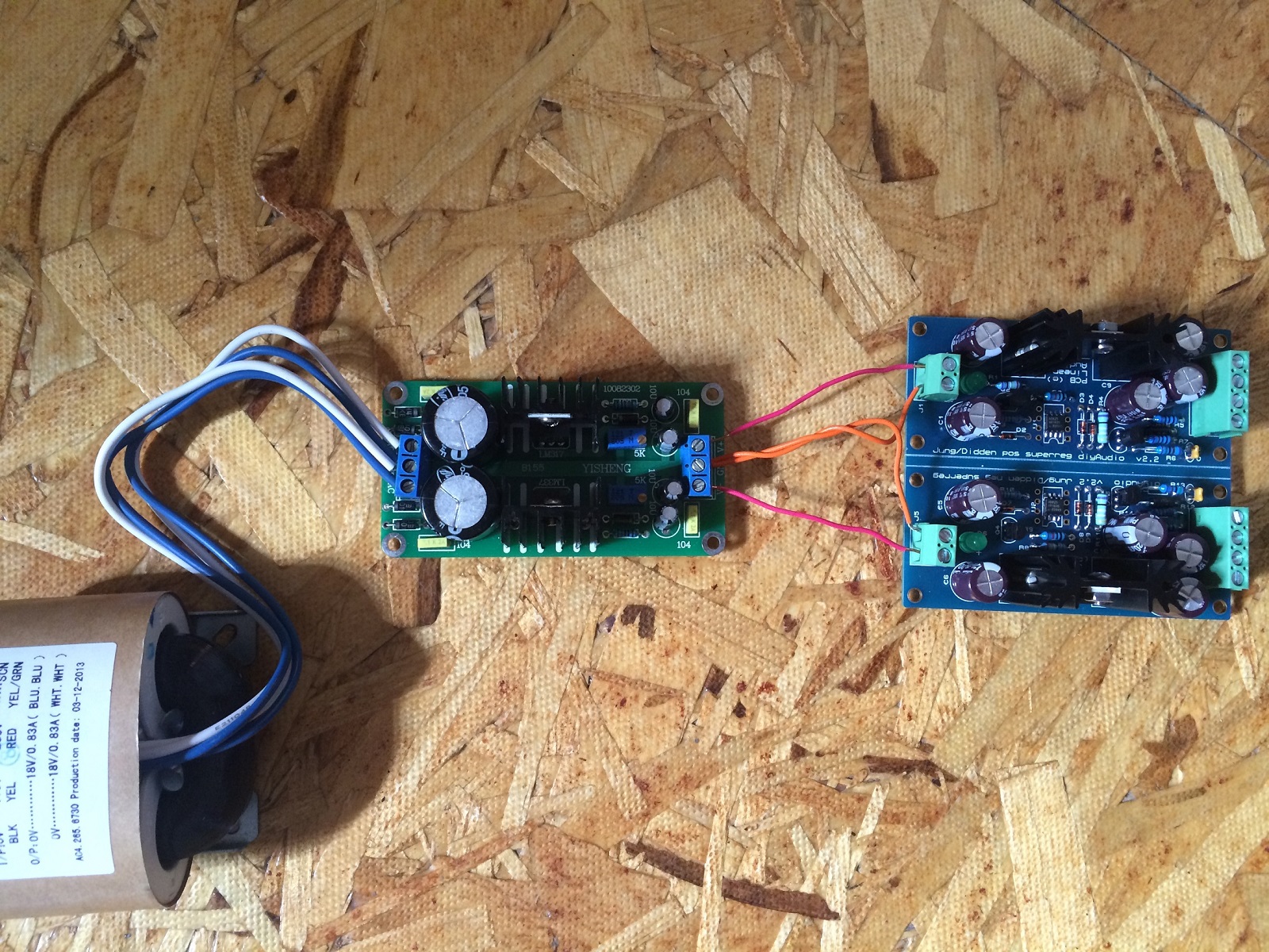

Some smoke appeared so I assume -- problem! Anything wrong with this picture?
I checked my pre-regulator and it's got +/-21 Vdc out, as needed. Hooked up the Superreg to it according to instructions: Ground is on the inside Vin J1 and J5.
To me this seems WRONG because looking at the traces Ground seems to be on the outside Vin of J1 and J5. Anyway...
So I followed the instructions, with Ground on inside pins of J1 and J5. Turned on and a little smoke came up, the LEDs did not go on. So I turned off immediately.
No load was connected to superreg.
Please give me an idea of where to start troubleshooting. Thanks you!
