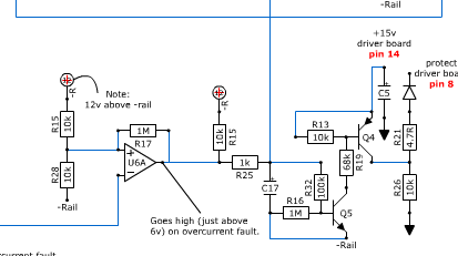

Originally the amp had failed supply and output fets. Supply is operational, output fets replaced, gate resistors verified. On power up amp with draw excessive current and it climbs with B+ voltage increase.
I can get the amp to stay out of protect by lifting D13 and using a current limit resistor. The outputs are IRF640N/IRF9640 pairs, essentially the AQ2200 schematic, same driver board with 4 transistors to drive the fets. The gate signal is roughly 40Khz on either rail. I only see a 5V square wave though, that seems to be my issue.

IRF640N gate signal, gnd is two divisions above center.

Note: 1)These amps do not like bringing the supply voltage up slowly, gets caught in some unknown region and causes excessive current.
2) The nomenclature on the board is wrong for the rca inputs, what says "out" is in.
3) Output section resembles AQ2200 and a host of Hifonics etc boards that use DWM1216 card.

Anyone recognize this board, maybe have a schematic for another amp that is close.
