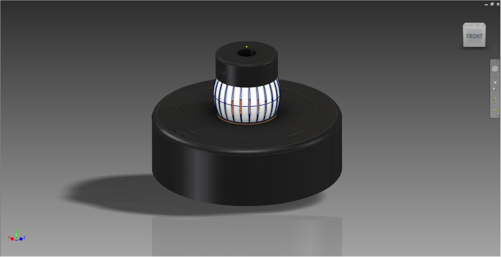

You've been able to model the thing in 3D CAD...
What about 3D printing the whole lamella (already assembled) and support assembly in 1 pass- you could print it with almost no gaps between the lamella- heck they could each be a more accurate part of a sphere.
I wonder if any suitable 3D printing materials exist..?
Print assembly from Voice coil up and attach to seperate voice coil / magnet assembly...hmmmm

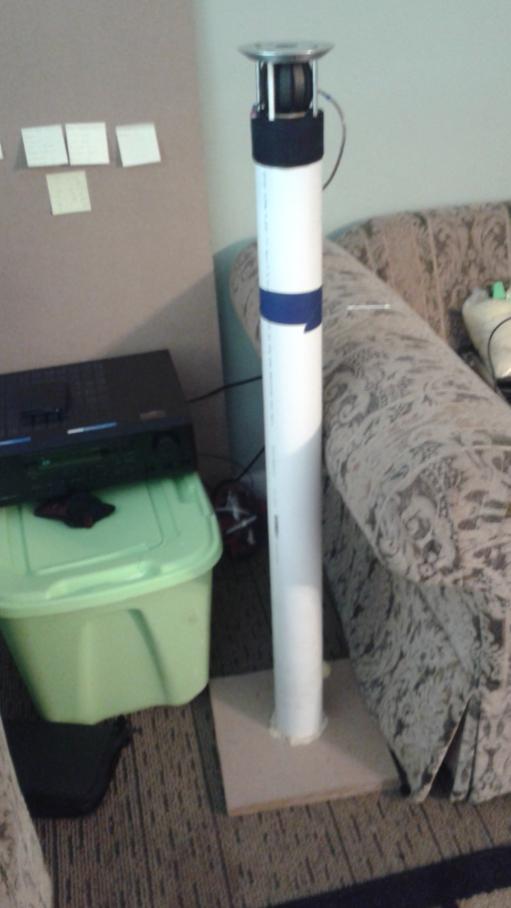

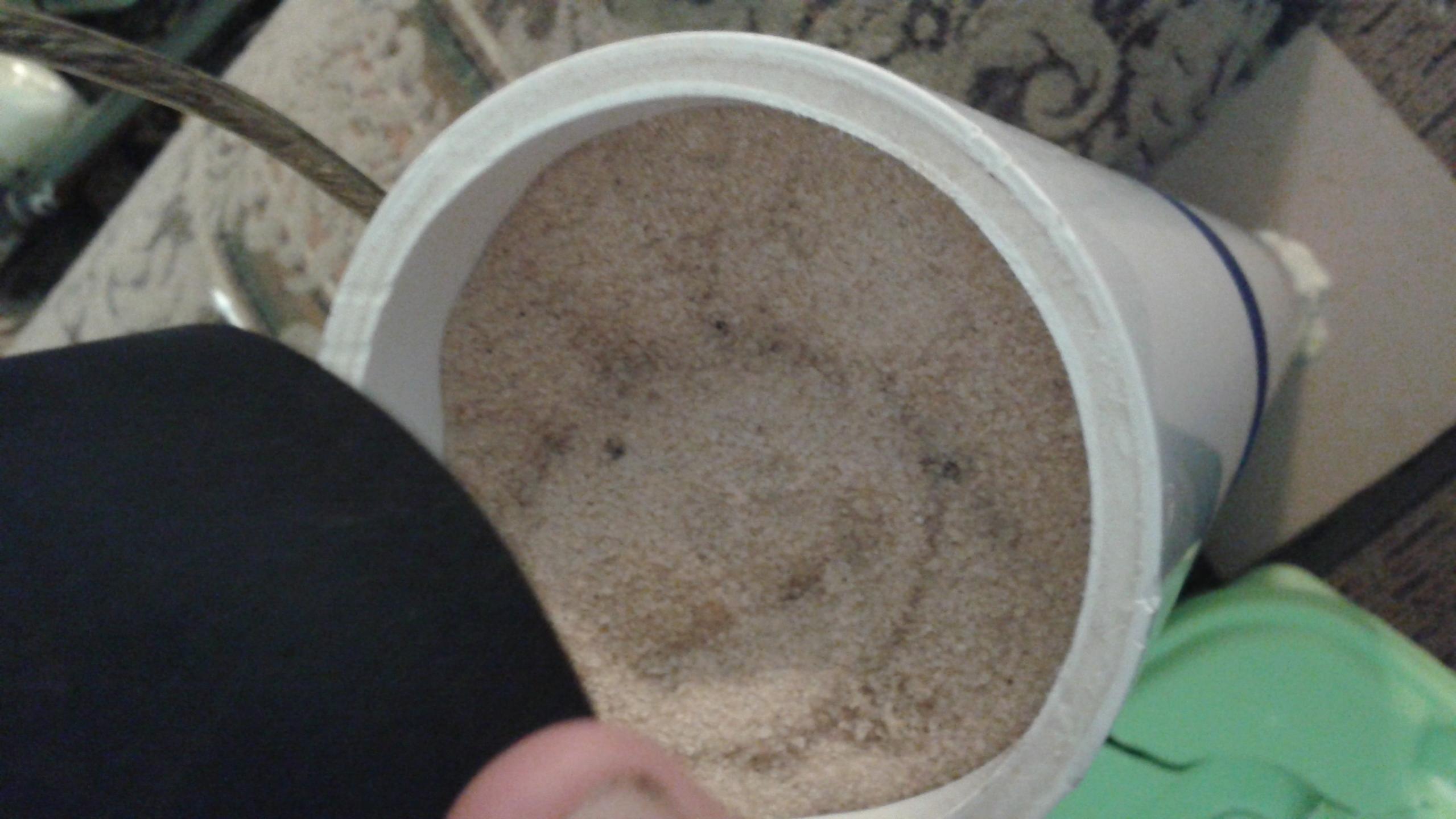

Test Tower
Below are the images of the test tower/listening tower that I made the tower is sand filled as can be seen. Also a quick connect/disconnect method. it holds the mid-range in the same vertical distance from the floor.

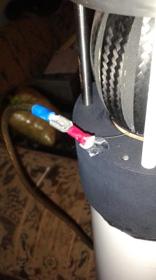

New Guard

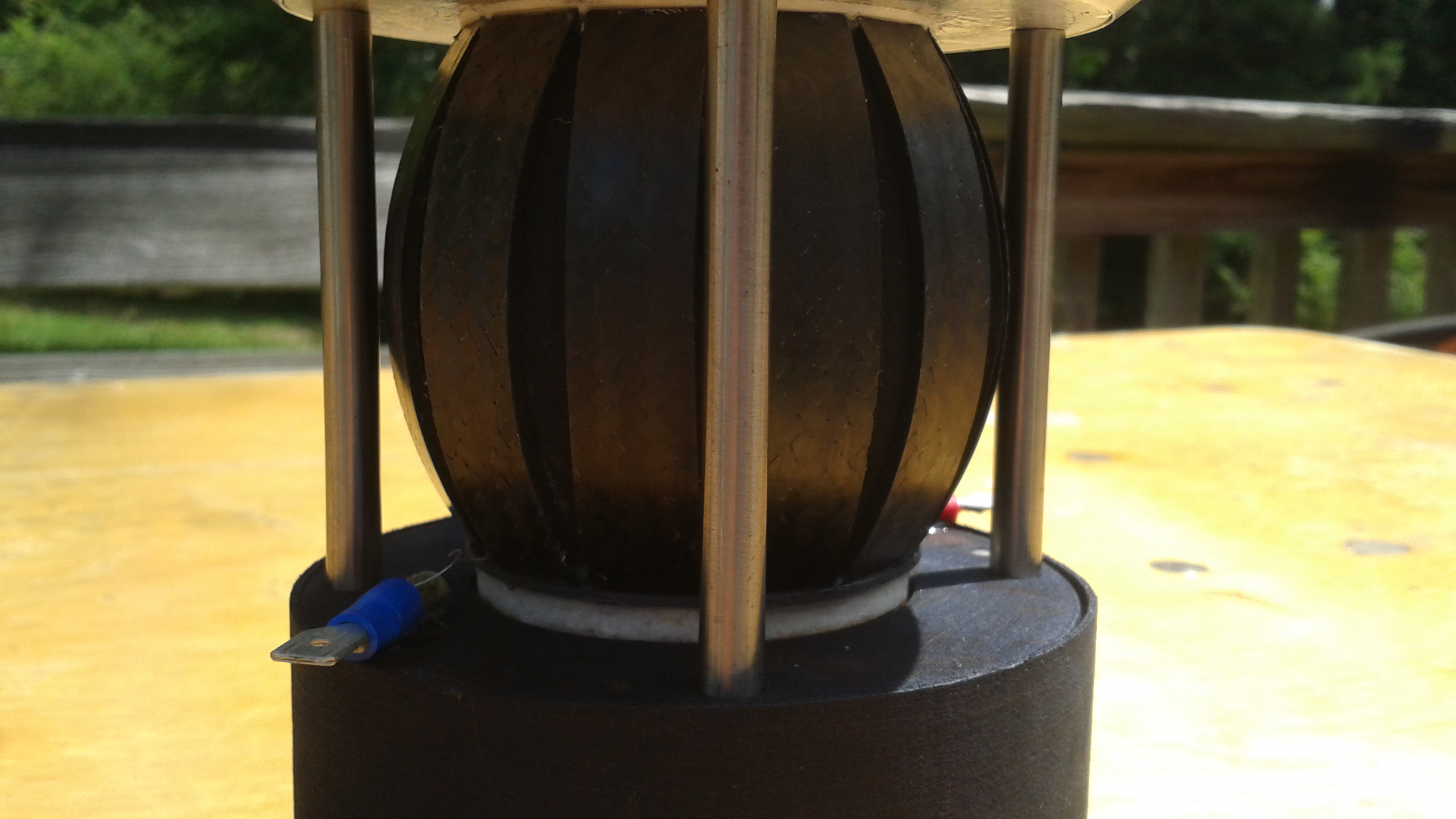

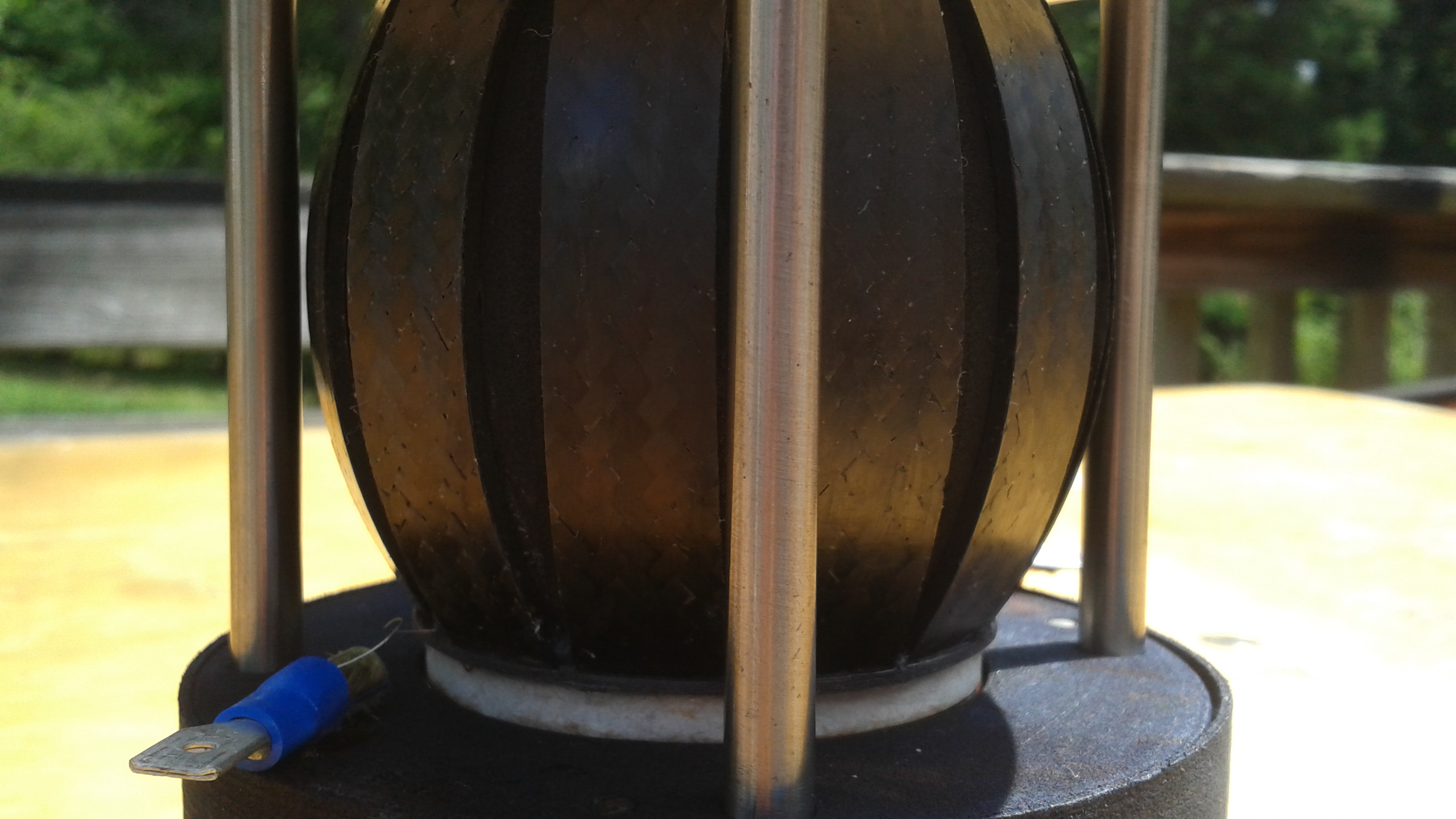

I just got done assembling a new unit. I took care to improve this one where the other needed work. the adhesive holding the carbon in place is put behind the lamellas so it is no longer visible. Also there is no longer adhesive visible from the sealer attachment. To add to this the bonds are also much stronger. The method for attaching and detaching the diaphragm from the to plate has been finalized so you can look forward to the measurements.

Beautiful Build, Mags. Absolutely stunning what you've achieved. Caught the Soundcloud entry, liked your opening cut. And it sounds marvelous, despite what omnis sound like to a microphone. Our ears are somewhat more suited to what they do...
I'll have to try filling my bases with sand and see if there's any improvement with my progeny. Hadn't occurred to me.
Having owned a pair of 901's a long time ago, there's really no comparison. 901's did one thing really well, play Extremely LOUD with an enormous soundstage. Not a subtle speaker, no...
Reducing the dispersion (as you noticed) doesn't offer any advantage, esp. if you're 'absorbing' the field to any great degree. Early reflection might give you additional perceived volume, but might muddy up imaging. I've given mine lots of space to play in, and it seems to work well to my ancient ears....

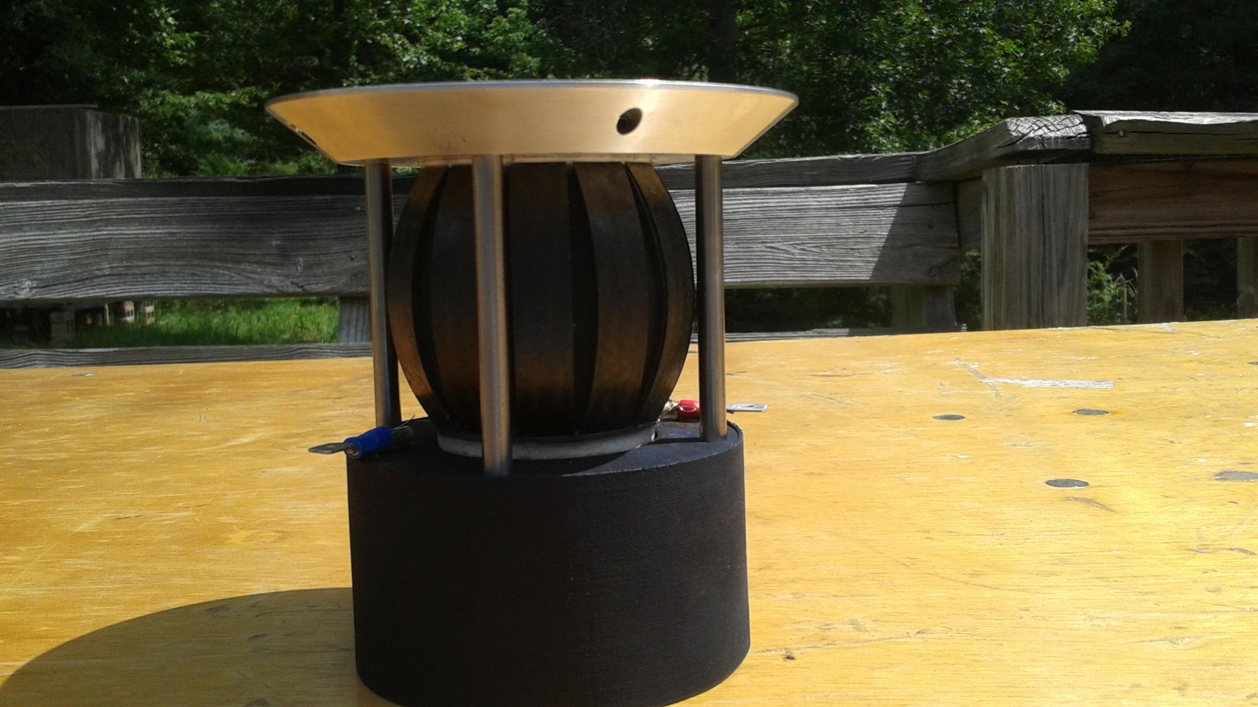

Pictures

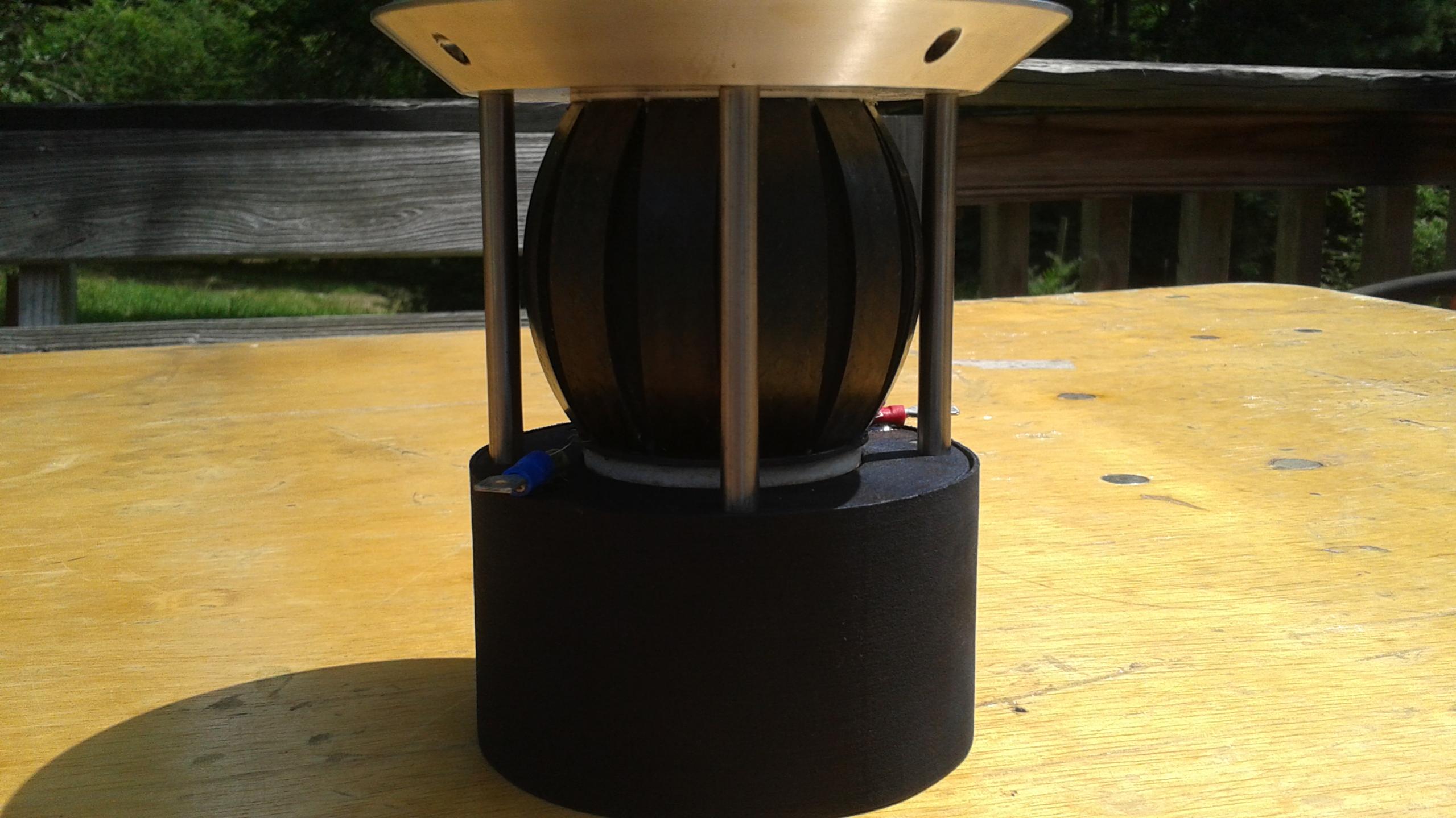

Here is the fully assembled unit. Interesting to see what the measurements will say. I haven't had a chance to listen to it I am waiting for a audio cable should arrive today.
"...waiting for a audio cable..." for me would feel like waiting for Godot. *L* I'd have dug into my misc. and found Something that could be conscripted...remarkable restraint, Mags. But I understand, if you're going to measure it, best to have The Good Thing in place....
Looks terrific, and it'll be the 'proof of the pudding' to see what you've created.

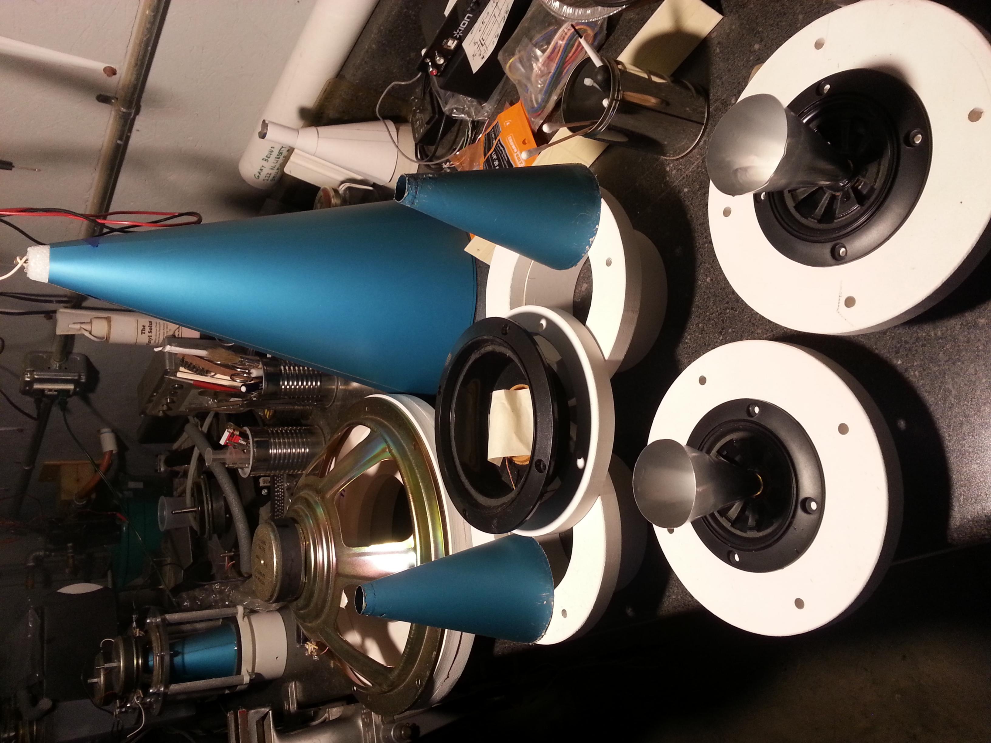

Meanwhile...I'm sitting on a pile of PVC 'rings 'n things' here...about to lash together V3.5 ( or V.4...I'm been 'blurring' what to call this pair...). We'll see soon enough what sort of racket they're capable of.

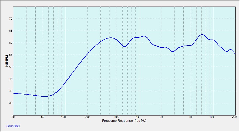

Ok I have had the unit playing for some days the first impression is it play pretty nicely. not much distortion. there is no voice coil rub but there are distortion in the form of a slight air leak and slight mechanical vibrations. they are minimal and are here and there depending on several factors. The stand I made broke so no critical listening has taken place as any other support wont do it justice.
Magna.
The air leak will be simple, the mechanical vibration could be a much greater concern and problem to solve. Do you have any idea what is making the noise, is it from the lamellas themselves or some other source? I'm still not a fan of the epoxy resin carbon fiber combination but we will see. A few air entrapments in the laminate would be all it takes to cause a problem with an internal noise in the lamella.
