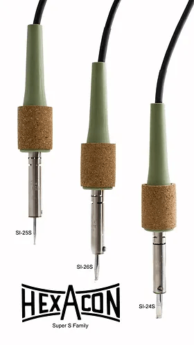

25W is awfully light for heavier terminals and wire leads. Also, you really need a tip with the proper size and a fair amount of mass for heavier work.
The last thing you want to do is spend a lot of time "hovering" on a connection while the iron struggles to get it to soldering temperature. You'll end up overheating and damaging your capacitors and melting the insulation on your wires. Not a plan..
Much will depend on which manner of construction you plan to use; PCB, terminal strips, eyelets & fiberglass board etc.
While similar, they each have their own thermal demands. If you add in heavy-gauge enamelled wire for the chokes, the demand goes up.
Don't get fixated on temperature control, this isn't NASA, and an unneeded expense for this type of work. Simple, cheap and reliable is what you need.
Honestly, a standard stick iron in the 60 Watt range with a 1/8" to 3/16'' tip should be perfectly adequate. For many decades we used Hexacon Super S irons for this type of assembly work at the shop, and they were perfectly adequate :)
Interweb pic;

Assuming you work with passive crossovers a 25W could be wanting at times. 60 to 100W, temperature controlled, should be OK. Never use a solder-gun! E
