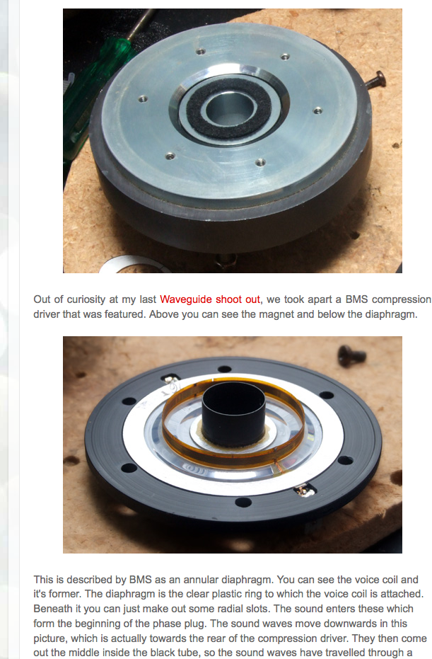

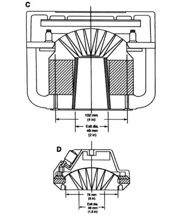

Is there any way to approximate the length from the compression driver phase plug to its exit?
Most drivers look like "C" or "D" inside, most modern 1" exit like "D" are around 30mm from diaphragm to phase plug exit.
Annular ring diaphragms (like BMS uses) are different.
With a bright light you can often see the diaphragm position through the plug.

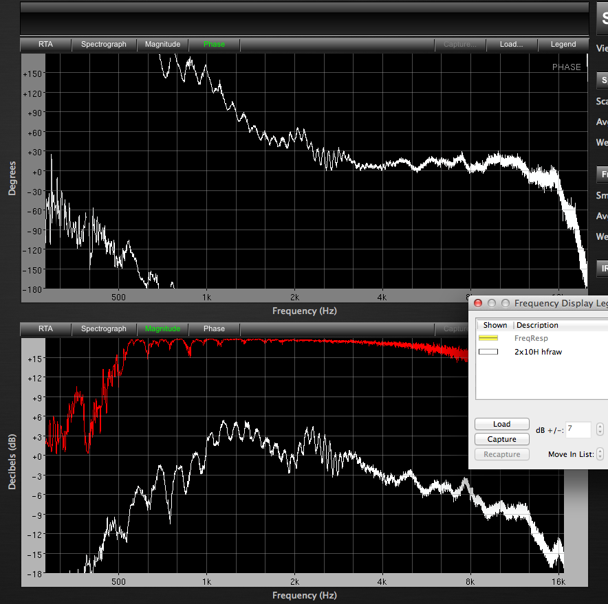

Thomas,
Don't think of yourself as "lazy", think in terms of "standing on the shoulders of giants" :^).
Nominal flare rate does not determine an "instant cut off" point.
Look at the response of this small conical 90 x 40 horn, it could easily be crossed around 1000 Hz for domestic use.
Getting a three way Synergy right using passive crossovers is a real challenge,
but using DSP (and some measuring tools and skills), getting a smooth phase and frequency response transition between components in a two way Synergy is not difficult.
Art

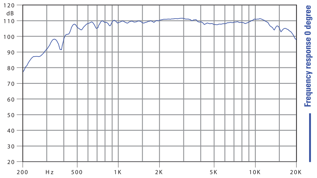

Speaking of the DSL SH-95: In #1205 you indicate that the ports start at ~5.5cm dowstream from the throat. I assume that this is at the edge of the ports and not the center? Do you know the actual x-over point?
It looks like the Faital is usable to ~700Hz if flare rate is not an issue!
