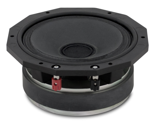

wow, a crazy driver
Precision Devices have built a 6" tweeter with underhung voice coil
cool
http://www.precision-devices.com/file-downloads/PD615WGDatasheet240413.pdf

wow, a crazy driver
cool
That's a very impressive driver. Its also nice that they are 16 ohms. Too bad they are so expensive. With a pair of them on a Synergy horn you would have to pad them down. The limiting factor on your system sensitivity would be the compression driver's high frequency.

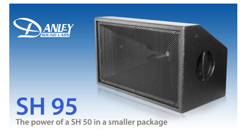

try google the suggested Danley SH-95, and go to pictures

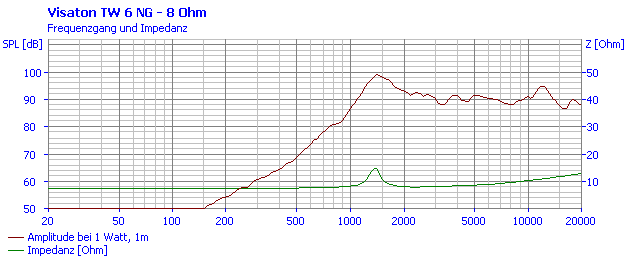

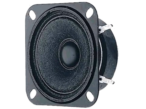

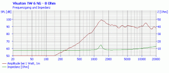

Thanks for the advise, I have looked at it, I see that a 8 inch woofers and a compression driver is used in the danly horn, this can work with tapped horns as one whole system nice, but maybe it it is what to big for a home, or to loud for shure, very neat system and technic it is for shure.
For the 8 inch woofer, we need types who do easely 2 Khz for crossover to compression driver, a wide band 8 inch for example.
I did found a tweeter from visaton, this go to 30 Khz (-10dB). I have used it a time ago in a box, I have this speaker for 10 years but it is still available, did sound sweet.. TW 6 NG - 8 Ohm
Maybe you can do something with it as tweeter in stead of the compression driver.
It is for later, I do follow you guys a while and learn further from you.
regards kees

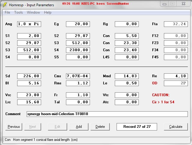

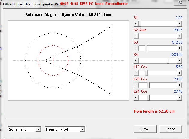

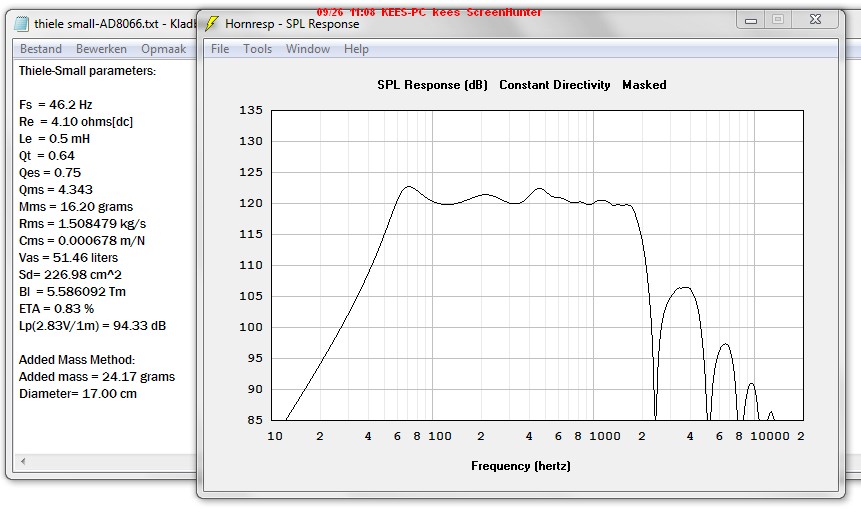

Hi all.
Yes you are right, stay on focus.
Okay, I have here some very old phillips 8 inches, and did a sim in hornresp.
Looks that these do quite well, but hey it is my first attemt to get some nice graph.
I have measured the thiel small parameters from this driver see pictures.
Only is the horn not what to big? I did need a synergy who go to 90 a 100 hz graph
go even lower. I did see the schematic of hornresp let see a different horn in compare
with the original synergy, but I can do it so it will match but then I get more ripple.
regards
kees
regards
kees
How do you plan to get the mids within 5.5cm of the throat? Try drawing the actual horn out with the drivers you plan to use and tell me if it can be physically built. I ask this only because I've simulated a lot of very nice horns to only find out I couldn't build what I simulated.
