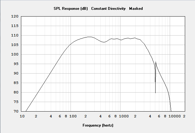

I have to apologize for the response curve on the data sheet for the sh-50, it is an ancient one taken indoors at the shop with a woofer we don’t use anymore.
There is a new website in the works for a long time, apparently this process is taking much longer than the sales pitch.
have three new recordings waiting to be posted with the others but the web folks who made I went under. This is a problem since there are a number of new products which have no links or info on the existing web site and whatever the new ways are it isn’t comparable with the old way. I am glad I don’t know enough about that to be involved but it will be nice when it’s done, I liked the parts I have seen.
Anyway, page 5 of the white paper has a more recent SH-50 measurement from a 24KHz bandwidth impulse response measurement taken independently, with EASRA.
http://www.danleysoundlabs.com/pdf/danley_tapped.pdf
Fwiw, the horn loading and effect of the low pass filters ends around 100Hz on an SH-50 (hard to separate it into the separate bits), the lowest part is the radiation from the ports which are short passages that extend to the rear and delay the driver’s rear signal which combined with the compliance form a stubby lumped tapped horn / vented box style acoustic phase.

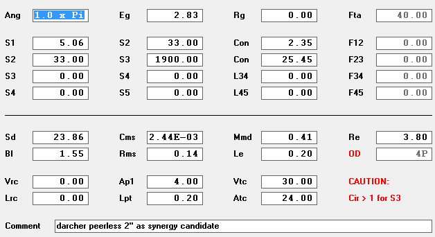

Any idea why the phase response in Akabak is rotating? For instance, in hornresp the phase response seems to be what I'd expect it to be (fairly flat) but in Akabak it's rotating constantly.
The group delay curve looks correct, so I'm guessing that I'm simulating the phase wrong somehow.
You're not simulating it correctly. I had this problem too until I figured it out.
First, plot the vector response of the phase. In this case it's called "Amplitude (Phase)" in the drop-down. Once it plots the new graph, go to the top menu and select "Calc" --> "minimum phase". The node to look at is the horn mouth. This will give you the real unwrapped phase of the system.

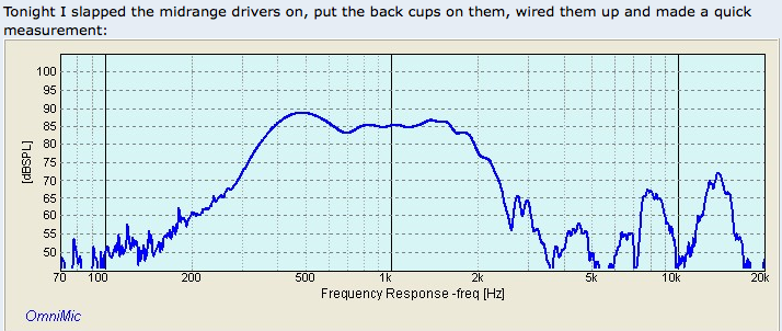

I put the midrange drivers on tonight and made a measurement (shown along with pictures on my thread at AVS forum yet ANOTHER DIY Unity, and a spreadsheet for figuring the wood cuts - AVS Forum
The cheap little 2" drivers really do all right. Not the most sensitive things in the world, but should be able to easily keep up with the non-horn type woofers I'll be matching them with. I thin I'll try to introduce some 6" woofer drivers into the horns.... just to see if I can make a full-range coaxial. These are a real fun project, your S1 and S2 builds have inspired a lot of builders to try these.

Bill,I thin I'll try to introduce some 6" woofer drivers into the horns.... just to see if I can make a full-range coaxial. These are a real fun project, your S1 and S2 builds have inspired a lot of builders to try these.
Response looks good 400 -1600 Hz, a very important two octaves, leaving a wide range of driver options above and below.
Curious why you did not simply use 6" drivers, rather than now considering adding them in addition to the 2" drivers?
I'd be very interested to see horizontal and vertical response at whatever increments you would care to do.
