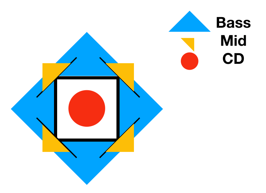

One other thing: I've never seen a setup where the mids are mounted at a 45 deg angle to to horn, so that you have 4 holes coming out on the intersection of the horn walls. This would leave more room for the bigger bass driver. Would look something like the schematic below

One reason you don't see drivers firing from the diagonal is that it's a messy structure to make. Another is that it places the holes at maximum distance from each other in the horn, limiting how high in frequency you can use the midranges and still act like a point source.
Generally I agree, but in the age of 3D-printing and CNC this could be a viable option.

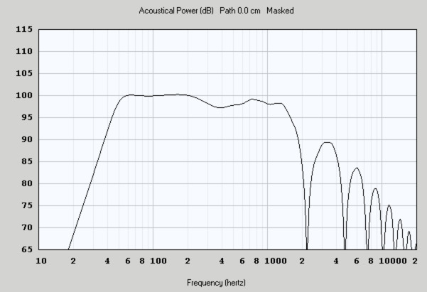

It has come up here before, but there really was not a lot of discussion about it (as far as I recall), so what about this notion: the best midrange for a Synergy might be no midrange. So again: yes this has come up, but I think it might be of interest to explore this some more. So here is my go at it..
First of, we'll need a CD that can go really low. For instance the 1.5" Radian 835PB or similar (or even a 2" version). You can cross them at 500Hz (24dB). Next I tried to simulate the midbass. For this I used Hornresp and Bill's sheet. As a midbass I used a Beyma 10MC500 for now. I tied to model 4 of them in a reflex enclosure. I also changed the shape of the horn a bit (from Bill's sheet) to optimise the response. I don't know if the high's will not suffer for this, but it did extend the midrange a fair bit. With a bit of simple EQ and filtering it looks quite nice.

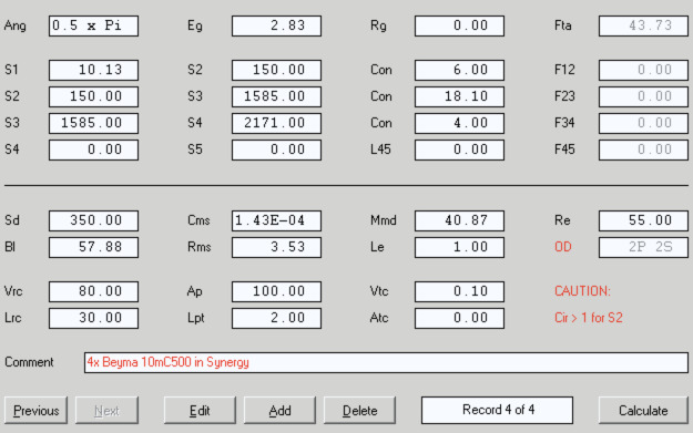

What I did not find is how to set the whole size for the midbass in the horn? Is that Ap? If so, is that then for a single driver or for all four combined?

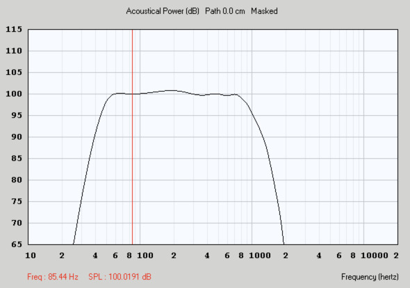

Ap is the area of the port in cm2 and it is for all the ports. 100 for 4 10" drivers seems small, I would have thought 250 to 300 to be closer to 20% of Sd.
Atc is the area of the throat chamber and shouldn't be zero is should be the area under the cone of all drivers combined. Vtc is the volume of the throat chamber in CC, the trapped air under the cone, so you have set an impossibly low value for that.
6cm for the throat entry is pretty close for a 10" driver.
If you intend to cross at 500Hz then it doesn't make sense to have the bandpass go to 1K or above you might as well use the acoustic filtering of the bandpass do most of the work and then you can have the ports further out.
Have a look at the Hornresp help file, it is very useful and explains all the parameters.

Thanks, that helps.
Yes, I first wanted to see how far I could go with this. I guess even a decent 1" CD would work with a 1 Khz crossover. I'll try to get it at a natural 500Hz. The holes will not be so close to the entry then as well.
