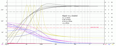

He can get a butterworth 2nd order alignment with 7 lt. If he goes aperiodic, And have a -3 at 40 hz in his small cabin.
My sim says 9.2 litre. F3 to 40 hz is making some assumptions about room gain.
But no matter, F3 is mostly meaningless except for the filter theory (Toole), but with an F10 of ~70, and the assumption that aperiodic will bring the Q down to butterworth (enuff damping would as well), 40ish flat is a reasonable guess.
