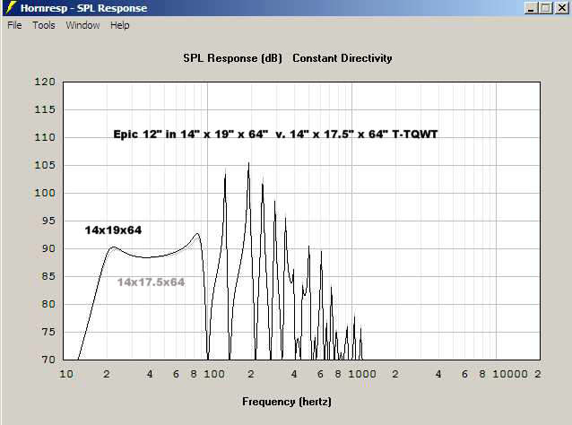

I decided that double thick was not necessary and went back to the original 19" wide version that is 64" long. I dont think that changes the baffle as it is just the width that changes. Thanks for all your help and I will update the page as we go on.
Thanks again!
Hi 2MuchRiceMakesMeSick,
Going back to 19" you are just about matching bjorno's suggestion in Post #30. :) He used slightly different T/S parameters, and you can see how that impacts the response. Your final outcome will depend on the T/S parameters of your actual drivers and the construction. You are correct, 0.7" or 0.72" will not make any measureable difference in this construction. I'll attach a Hornresp SPL graph showing the difference between 17.5" and 19".
