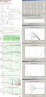

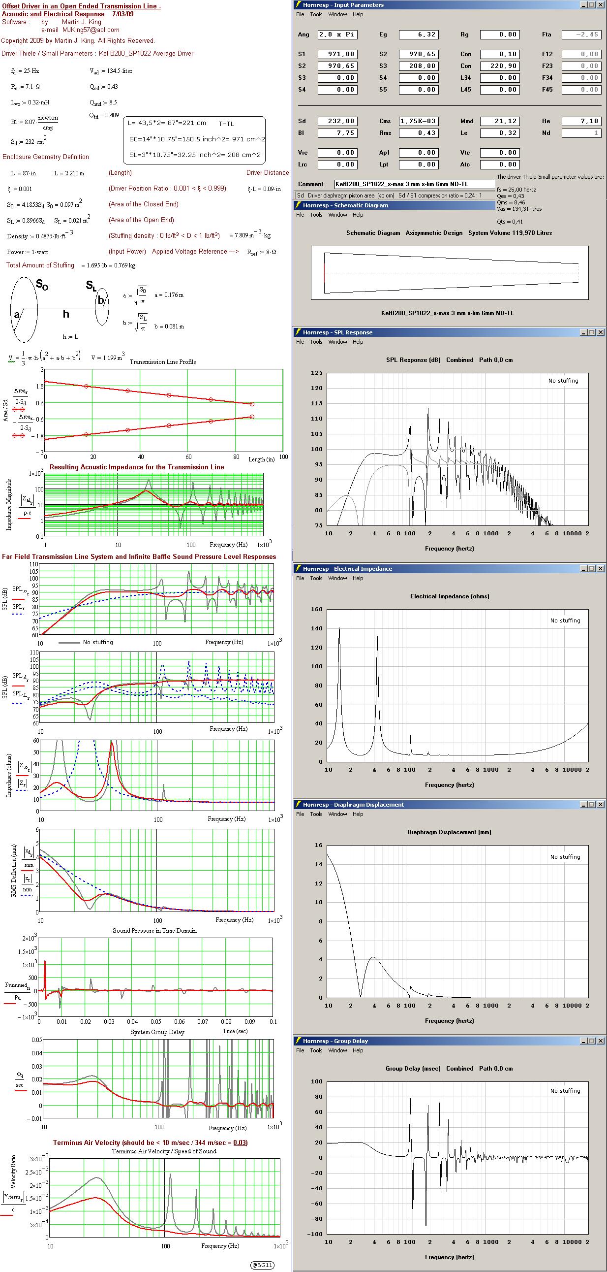

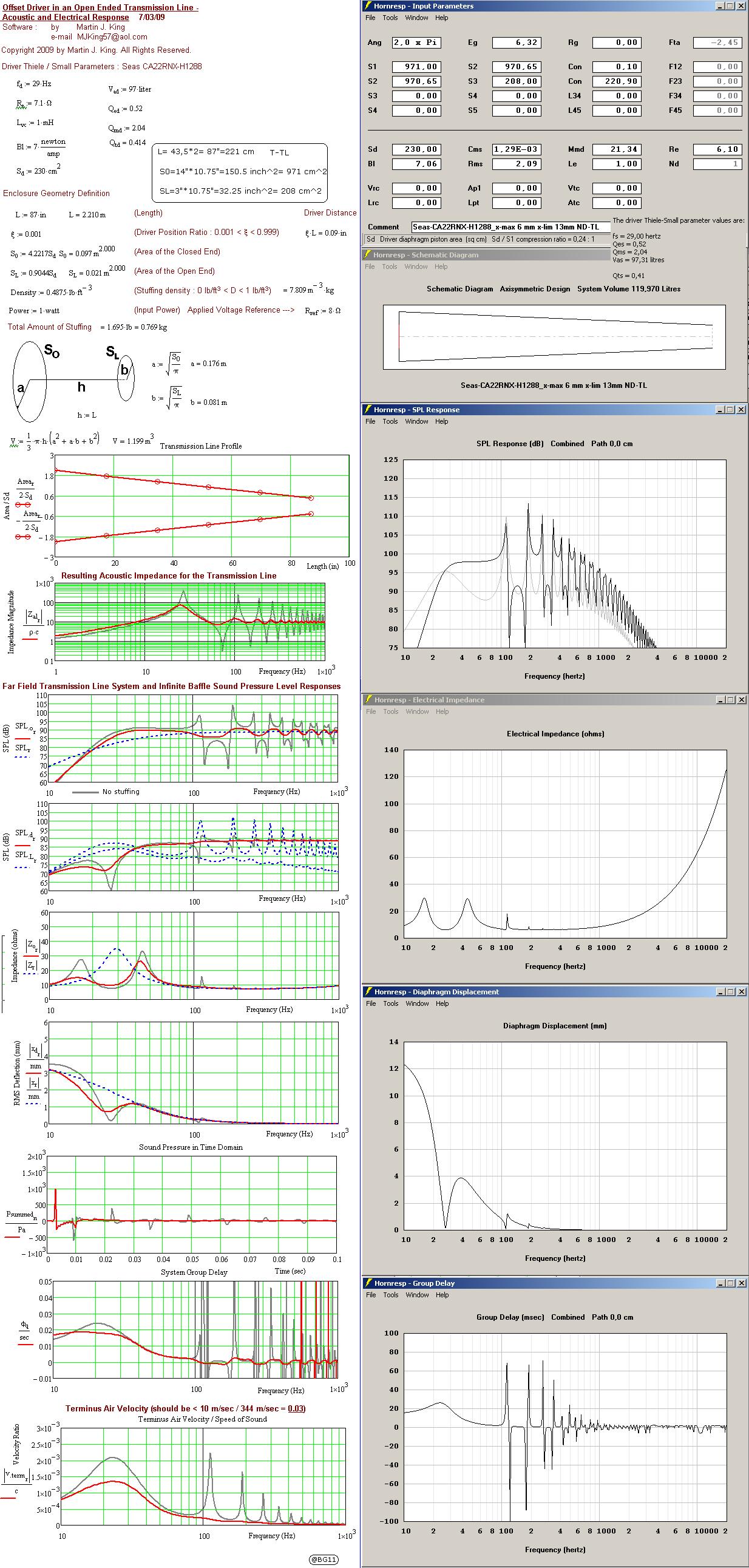

Hi, Seas-22RNX H1288 is IME a perfect replacement for the Kef B200 SP1022 driver in the T-box accompanied with better performance.
b
PS: I will dig in my TL simulation bin for that driver and post later today.
Done and reworked:
b
