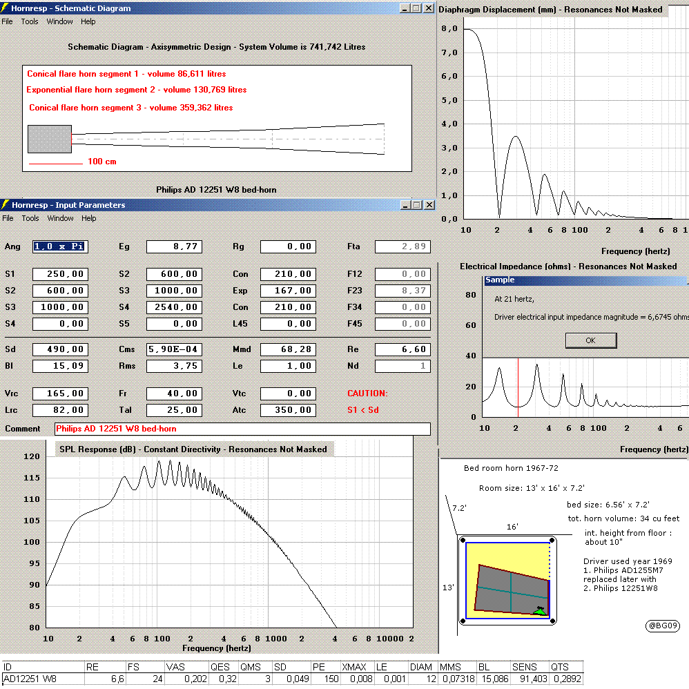

This is a very old idea; I built my first for more than 40 years ago:
b
1 (1)
