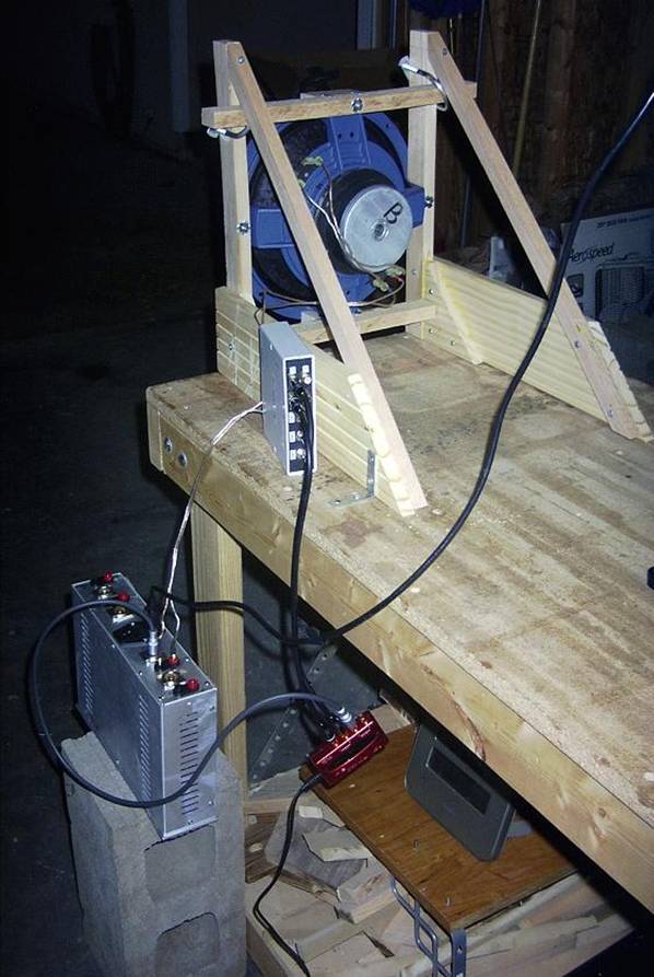

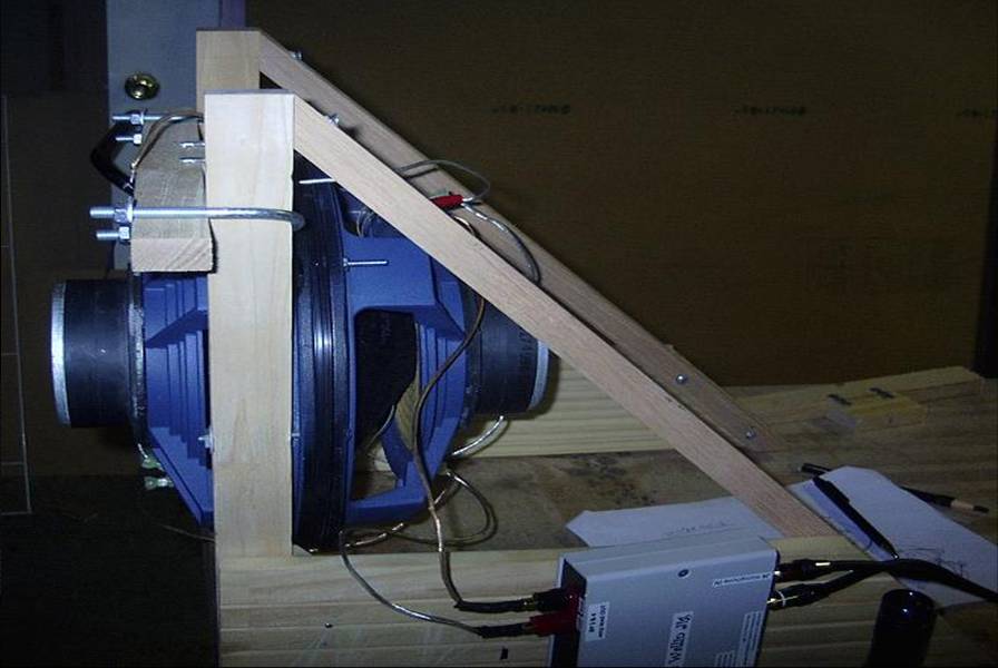

  • solidly clamped to a test jig vertically (see Figures #1 & #2)

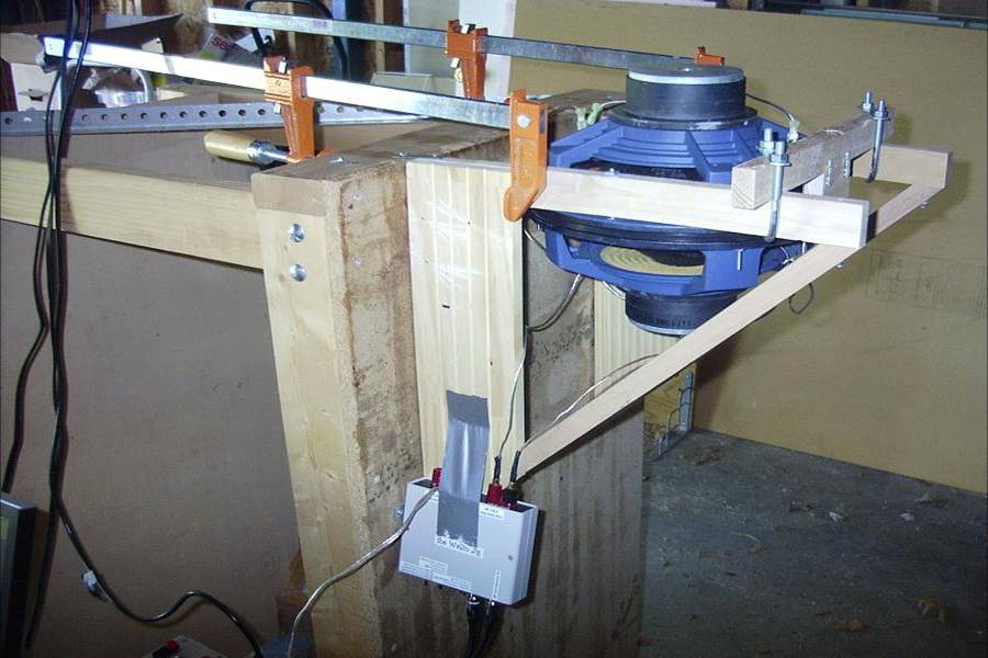

  • solidly clamped to a test jig facing up about 4ft (1.2m) from both the floor and ceiling (see Figure #3)

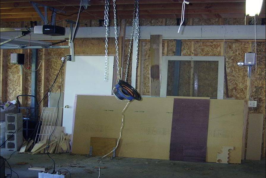

  • hanging from chains roughly 3ft (0.91m) from the ceiling and 5 feet (1.5m) from the floor (see Figure #4)

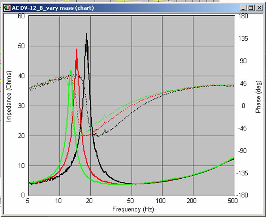

Data from Woofer A in the horizontal position is suspect! The impedance curves clearly show the minimum impedance of driver A in the horizontal position, both with and without added mass, is ~6ohms. This is likely due to a bad connection. All other impedance curves are as expected. Some example impedance curves can be seen in figure #5. Another note: SpeakerWorkshop gives the user the choice of entering DC resistance manually, or allowing SW to calculate DC resistance from the impedance curves. SW’s calculation of DC resistance differed from that measured with a multimeter, and I found that using manually-entered DC resistance resulted in more consistent T/S parameters, so I opted to input DC resistance manually. This was not done in the first experiment.

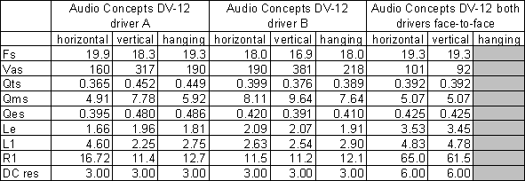

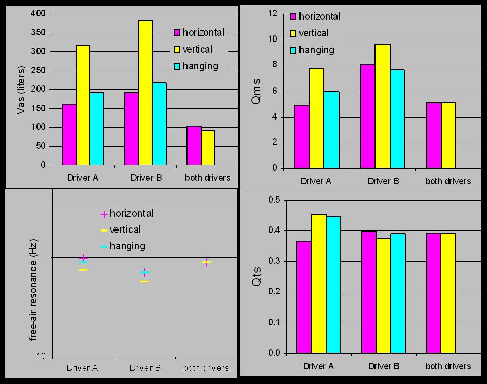

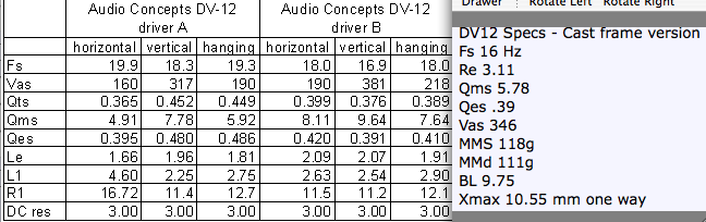

The sixth figure is a chart showing all T/S parameters calculated by SpeakerWorkshop for all conditions tested. The seventh figure is simply a graphical representation of select data in picture #6.

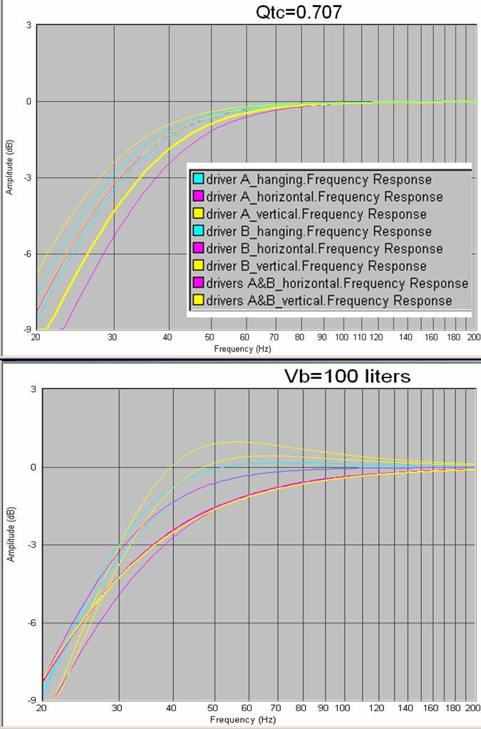

The top graph in figure #8 shows simulated frequency-response curves of both drivers in a box volume (undamped) calculated to achieve a Qtc of 0.707. The chart in figure #9 is the box volume used to plot curves in said graph. The bottom graph in figure #8 shows simulated frequency-response curves of the same drivers keeping Vb=100 liters.
Conclusion:
The data are difficult in interpret and a bit perplexing. Testing the driver vertically clearly results in lower Fs, higher Vas and slightly higher Qms. Note that when tested face-to-face, modeled as one driver, these orientation-dependent differences disappeared. This suggests that whatever is causing the differences is cancelled by the cones moving simultaneously in opposite directions relative to their frames. It is curious that the hanging method produced results more closely matching the horizontal orientation than the vertical orientation, even though the driver can be seen hanging a little closer to vertical than horizontal. The results leave me wishing I had tested the back-to-back drivers hanging from the ceiling.

The isobaric push pull (face to face) arrangement that you plan is a different animal than either driver alone. The enclosed area between cones will also affect the new single driver’s compliance.
That said, half the size of a normal sealed box for that arrangement sounds correct, but you pay a big price in output level, hope you are partial to “girl with a guitar” type of music.

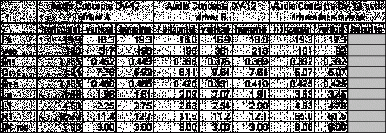

Looks like your vertical results average fairly close to the speaker’s usual TS parameters.
