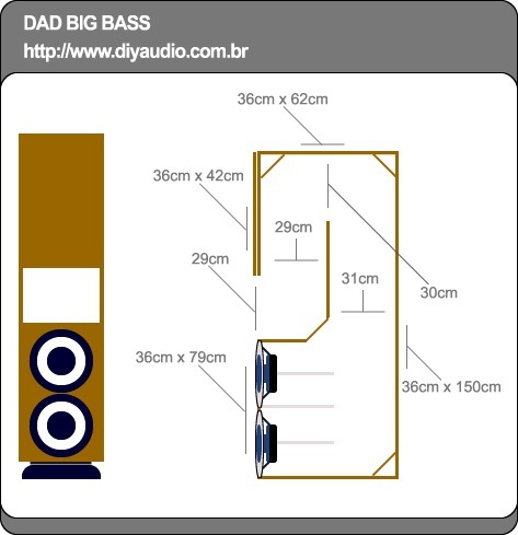

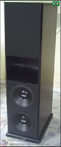

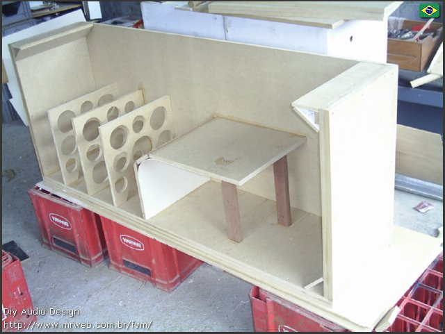

Based on this project, which contains two driver 300w RMS each.
I would take the same project, and use only one driver.
How would the measures?

If the design is any good, and I'm not saying it is, half the internal
depth dimensions and the front opening and leave everything else
as it is for one driver.
More succinctly half the effective CSA and volumes for one driver,
if you make it narrower don't reduce the depth so much. Having
said that the design doesn't look right to me, YMMV.

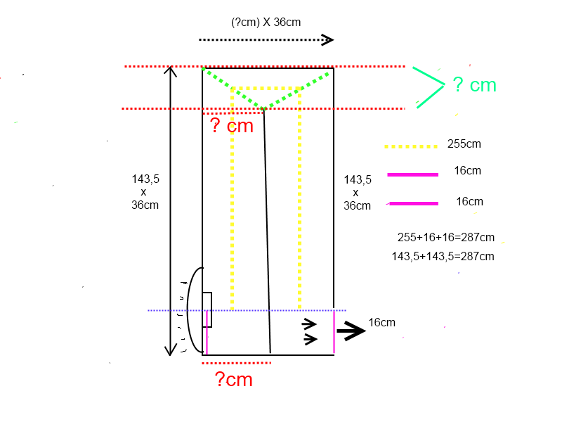

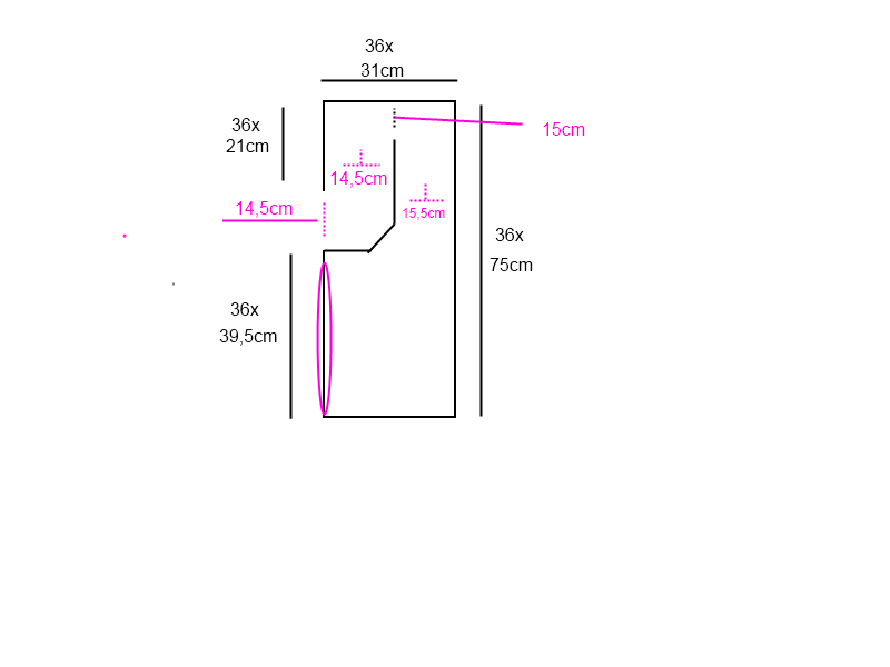

So I figured halve the measures of the original design.
Now, I am in doubt.
My idea would be so! (photo attached)
Considering the parameters of the drive, is it correct ?

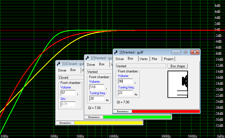

FWIW the box doesn't look remotely suited to the driver parameters to me.
If the drivers specs are accurate I'd go for a vented box any day of the week.
Any driver that can be vented to 22Hz simply doesn't need a TL of any sort.

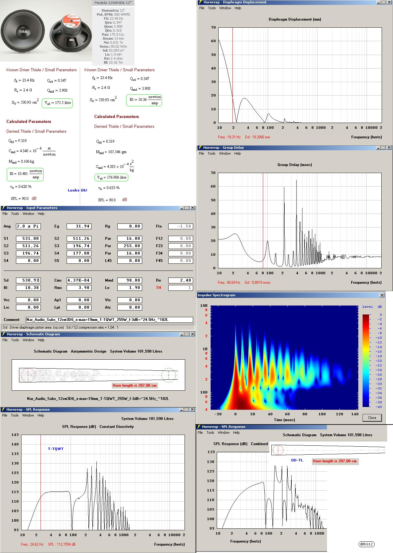

It seems to be a correct length of the internal airways but the cross sectional areas don't suit your driver at all even if cut in half.
BTW. You have to completely re-design the two driver enclosure because the drivers are lined vertically not horizontally.
If the drivers had correct T/S parameters and if were paced horizontally you could have divided(vertically) the enclosure cut in two equal halves.
Have a look at the submitted picture where an OD-TL of similar length is shown at the bottom using your driver T/S.
This TL starts with an area(S1) equal to the driver Sd and is terminated with an area of Sd/3(= S4) and a total air-ways length of 16+255+16 = 287 cm counted from the S1 area ending at the terminating port(S4) . The FR is shown too.
Compare: IMO a much better use of your driver would be to convert the OD-TL to a T-TQWT= the rest of the simulations.

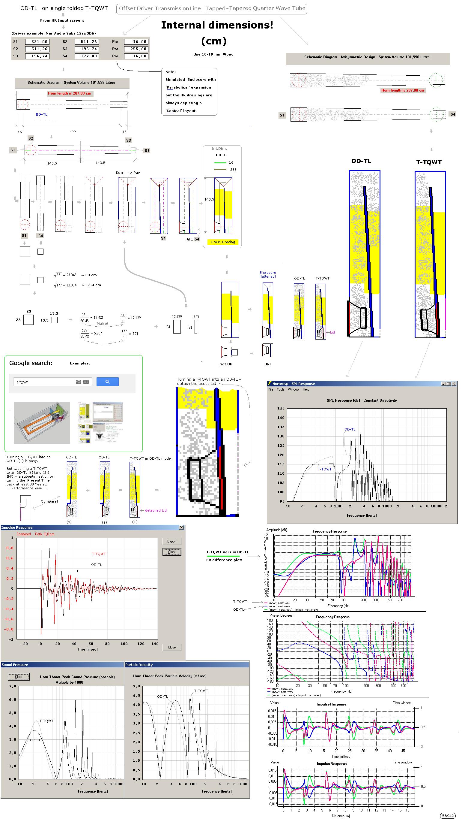

This is a DIY forum. Why not help yourself ....Here are a couple of hints on how to interpret the HR layout dimensions for one driver:
b:)
b:)

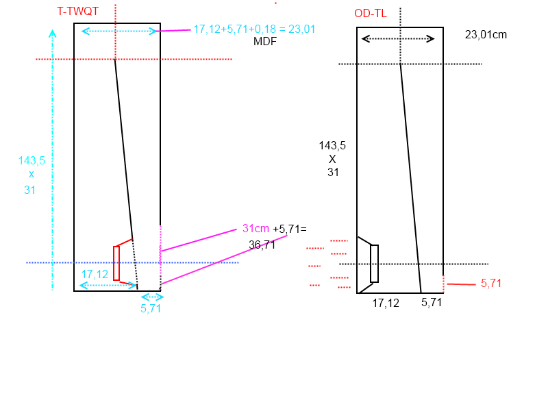

To calculate the size of the line, the correct calculation would be as follows:
row length = speed of sound / FS / 4
In our case would be>
row length = 344 / 23.80 / 4 = 3.613 cm
In the calculation made by softerware line length was 2.87 cm in
this is just a curiosity.
Another thing:

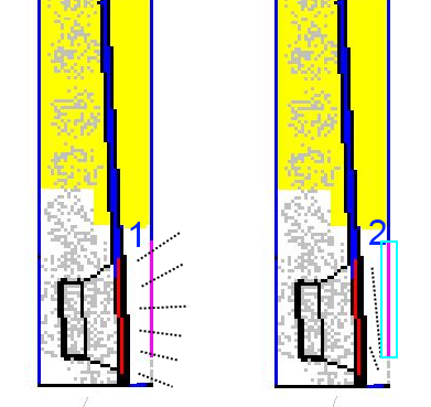

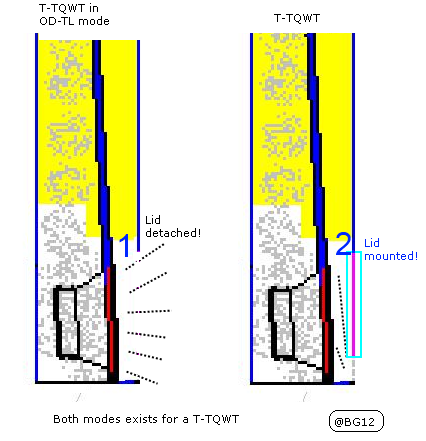

For graphical analysis box "T-TQWT", the waves were better than the OD-TL?
just one more question:

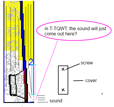

which the correct design "1" or drawing "2"?
In the drawing "1", this wide-open, ie 31cm + 5.71 cm.
In the drawing "2", only one door for access to the driver, are, is closed, only opened in S4 (5.71 cm), the air coming out only by S4.
Both are but when you draw imaginary sound rays as in # "1": This gives a false
impression that the sound travels through the Lid, it doesn't !
You have to detach= here remove the Lid in order to convert the T-TQWT into an OD-TL.
Corrected picture here:
b:)
..Let's talk only of the T-TQWT.
This cover you're talking about, is merely to maintain the driver. However, in normal circumstance, is closed? would that be!
As in the drawing?
Yes! And if you remove the cover(Lid) you have an OD-TL as simple as that.
In OB-TL mode the In-Band FR sloops gently towards lower frequencies = sometimes handy to invoke if room boundary gain considered to high ( corner placements).
The summing of the driver and terminus will be in the far-field for a OD-TL( picking up boundary from the vicinity too) but a T-TQWT can be considered as a Omni-point-pressure-source with comparable low sensitivity for external boundaries interactions.
