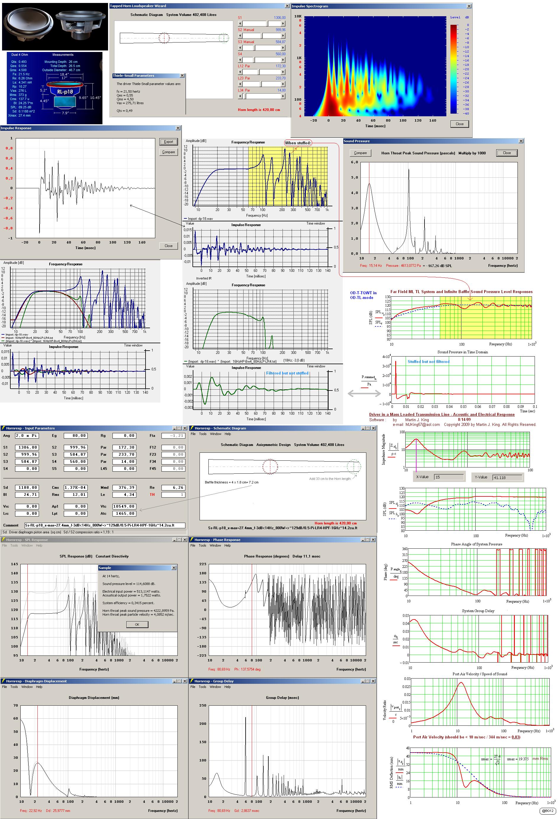

Am I right that the 'clamshell' drivers is in a 8 cu.ft box where 4 cu.ft is closed and the front-box is also 4 cu.ft equipped with a port system= 14" diameter,22" long...if so I couldn't design this using HR showing an acceptable FR.
I may be wrong but I guess you have used the driver parameters in a way the returned odd box dimensions.
Here is another example using one of your drivers in a box that IMO would be hard to beat SQ performance wise and is IMO capable to wreck your walls if placed in an ordinary living room It's an OD_T-TQWT of-course, a kind of pointsource quarter-wave BP box that should be folded at least two times.
b:)
PS: Why not put your design dimensions into HR and post here for (eventual help and ) examination?

The 4 cu. ft. over the outer driver is a "something" (whether you want to call it a port, a horn stub, a dog house or whatever :)) which easily could account for an 80 Hz peak.
That configuration is similar to an open back guitar cabinet, which is actually a very high Fb ported cabinet.
As mentioned before, modeling your driver/cabinet in Hornresp would be useful, your problem seems cabinet related, not an inductance problem.
