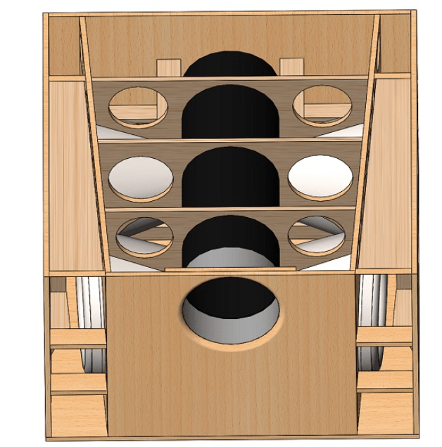

You might look at Josh Ricci's M.A.U.L. design for inspiration:
https://data-bass.com/#/systems/5aa4a25261feb10004121e18?_k=5u61zx
The M.A.U.L. uses a shared chamber for the four matched drivers, your idea using two different drivers would each require separate chambers and tunings. The bass reflex chamber shape makes no difference to the output.

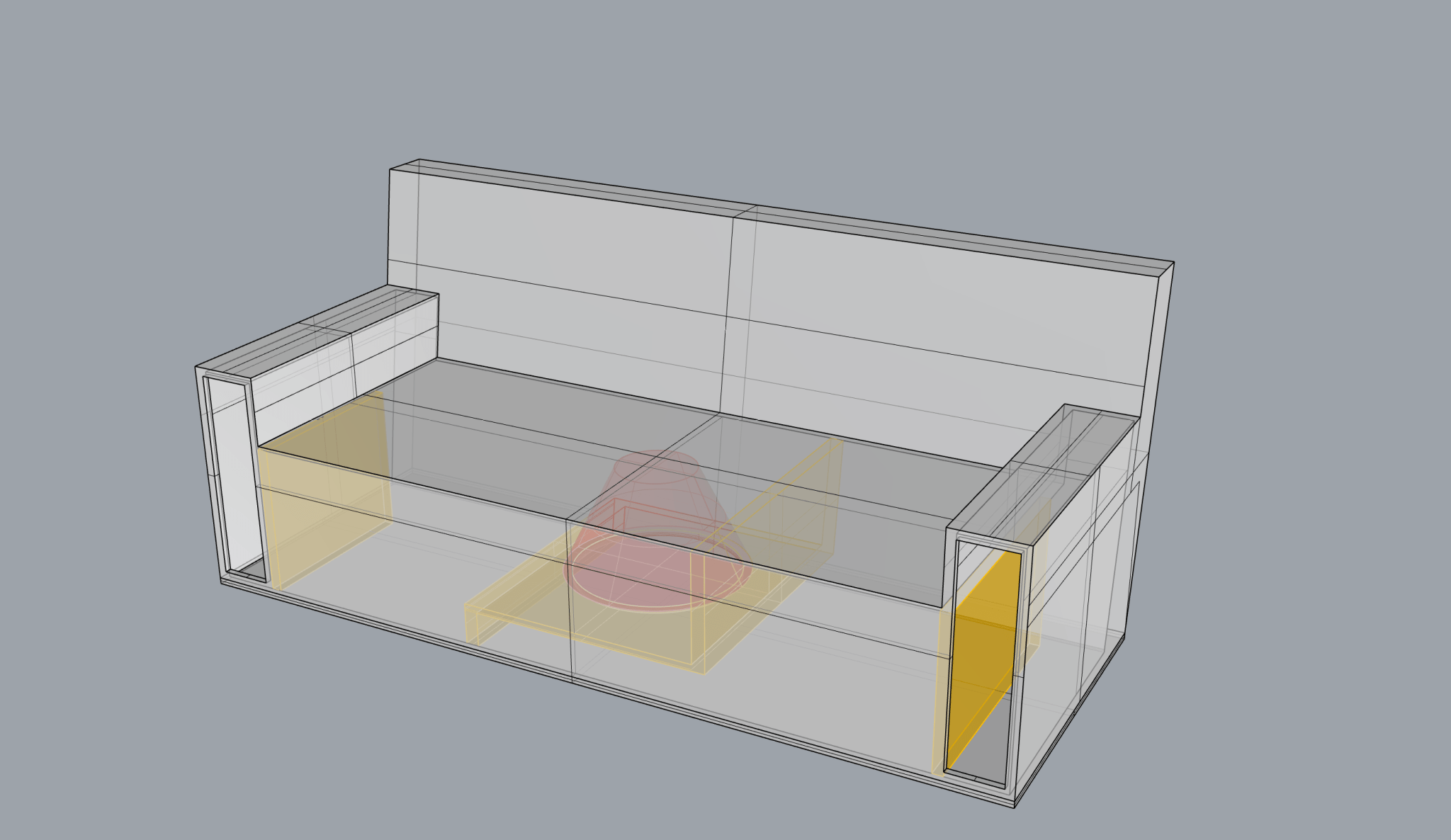

heres a quick sketch of what the 6th order bandpass with the ports under the arm rests could look like- havent started designing the chambers this is just the structure idea. Here the seat is flat but I would want the whole seat on the couch to be angled backward in the final design. Is there a big phase cancellation question here?
