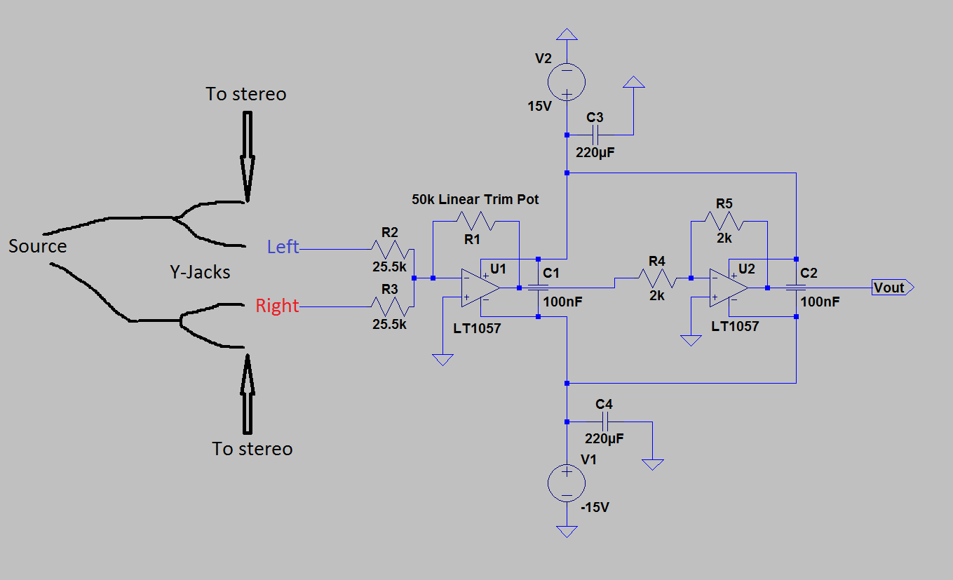

Yes, it is the same I suggested in my earlier post, but neatly drawn out. Just don't take 1/4 W resistors; use 1 W just to be on the safe side.
vac
Thanks, Vacuphile. It is the same as you suggested earlier. I just found it easier to reference the picture. Sorry for the lack of credit given.

I ran into this problem on a friend's 2.1 system a while ago. This was my solution. It is exactly what AndrewT is telling you about. The 2nd buffer is there to invert the signal back to normal so your sub isn't out of phase with you mains. I disconnected and re-connected this while playing a wide stereo mix to see if I could hear any cross-talk effect and I didn't hear any difference. The 50k pot allows you to do fractional gain all the way down to a very low volume but if it is turned all the way up to 50k:
If left and right channels each have 1V, turning the pot to 50k will output at ~4V so be careful not to overload your subwoofer amp's input. I needed that flexibility but you may not. I used OPA2134 and so far it has been very stable no matter what setting the pot is adjusted to.
