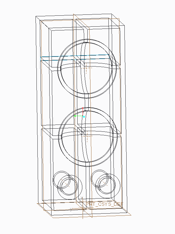

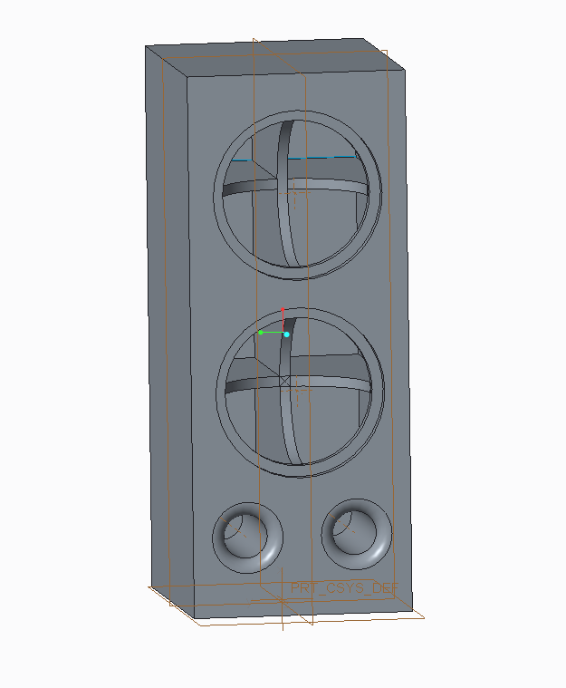

When you design and draw the plans for your dual DSA315-8 woofer cabinet, why not invest some time and design work into plans for a future matching midwoofer/waveguide top cabinet? The EconoWave threads have technical information and crossovers. Just cut the wood panels plus bracing for future glue-up and driver mounting.
MDF does not have great shear stress, so
1) construct a double thick front baffle. Angle cut the rear baffle board holes for good speaker air flow.
2) construct one U brace which goes around L+B+R panels between the two woofers.
3) construct one top-bottom center-panel brace

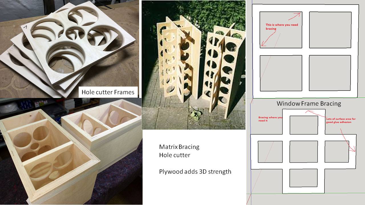

Could you maybe attach some diagrams of the bracing you are talking about, I am having trouble picturing the placement of them...

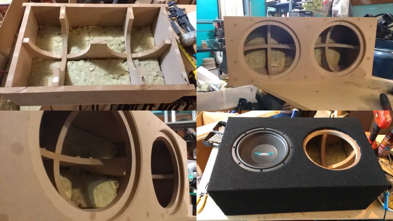

MDF is easy to crack in half, SO simple "saber saw cut bracing" is typically glued to cabinet sides to increase sheer strength. A good construction example for your MDF materials and basic tools. dual12 pic
Plywood has good 3D strength, SO newer multi-hole matrix-grid bracing creates smaller panel areas which only generate low-energy high-frequency vibration. A drill press with a hole cutter speeds and simplifies the job.
Plywood is a better speaker cabinet construction material than MDF.
HomeDepo has generic Birch plywood for about $55 for 4'x8' sheet. A simple black wood stain looks cool and still shows the wood grain. (painting MDF is a B-I-T-C-H)

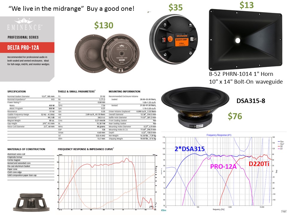

-For any interested readers-
A sealed matching width cabinet ~1.2cuft total with ~1cuft net with drivers has -F3=110Hz
$13 B-52 PHRN-1014 1" Horn 10" x 14" Bolt-On waveguide
Model: PHRN-1014|Part # 299-2303
$34 Selenium 1" compression driver 2/3 Bolt . ( Proven Xover ckt available)
Selenium 8 Ohm Model: D220Ti-OMF-8 |Part # 299-2321
$130 Eminence Delta Pro 12A midrange 12"
